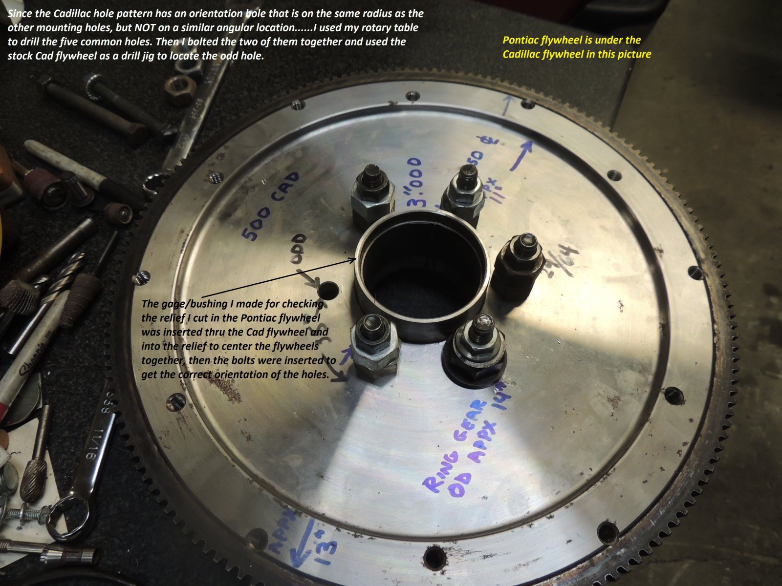

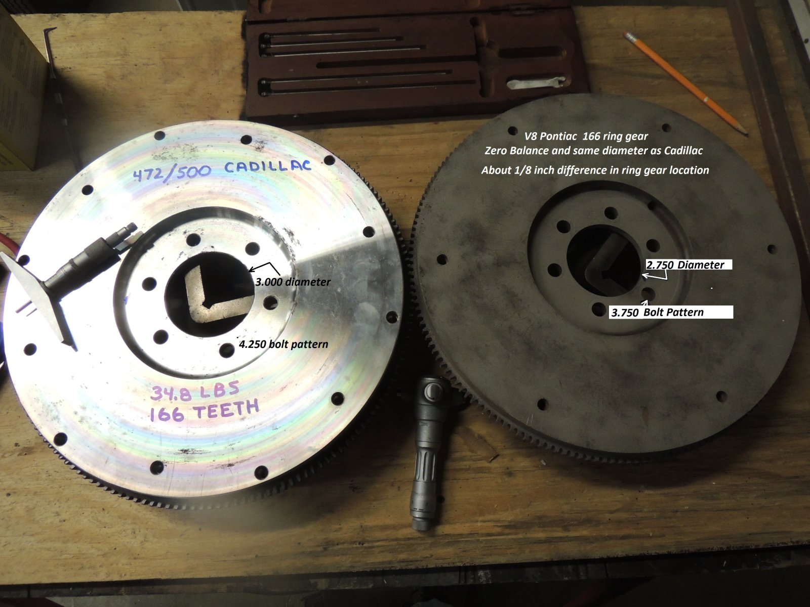

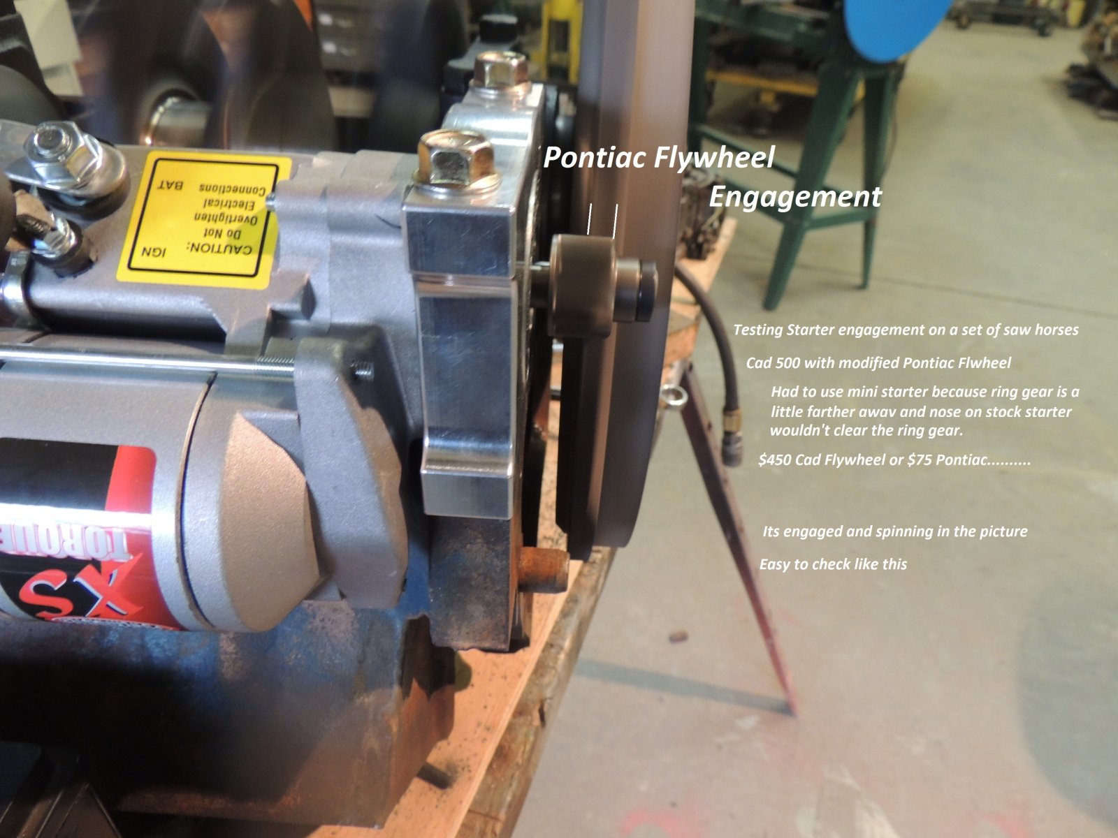

    I haven't scratch built one, but I did modify a Pontiac flywheel to fit a 500 Cad. There are probably a lot of flywheels that can be easily modified. Just look for ones that are either the same diameter or larger. Its no problem to remove a ring gear and turn the OD to the same size as the correct flywheel and reinstall the starter ring. There is usually plenty of room to add an alternate set of bolt holes. Then you have to look at how far the ring gear is spaced from the engine block. On mine, the stock starter would not work because the support at the gear end of the starter would not quite clear the ring gear. I used a geared mini-starter which I wanted to do anyway for the extra room it provides for the headers. This presupposes that someone is making a neutral balance flywheel. Also, on mine I only had to open the center hole a short distance to fit the Cad, so the rest of the bore is still Pontiac sized. It will fit a Cad or a Pontiac now.
    Here is a comparison of the ring gear location between a Cad and Pontiac
    Front view
    In this case the hole pattern was not symetrical so I drilled it using the Cad as a drill gage. Could have done it with a rotary table.
    Here it is being tested on a block/crank with some used bearings in the block. Works great......
