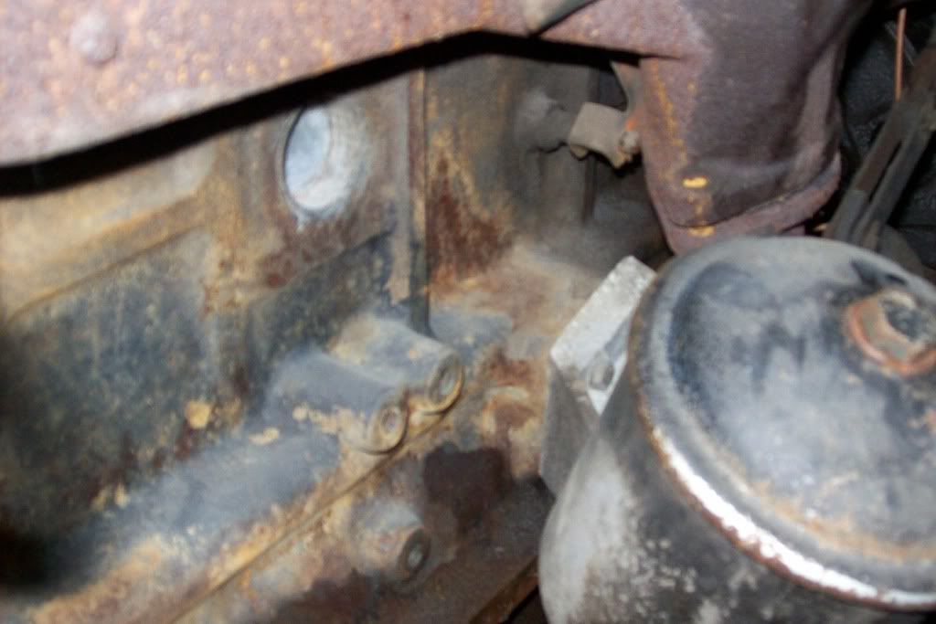

  8. Thanks for all the help guys but I still haven't figured it out yet. I checked all the links but none of the numbers matched anything. 55 Dude suggested pictures so here is what I've got.
    Small Cover
    Two center studs. The number is 3695451
    Looks like nothing on the side of the block behind exhaust
    The number to the left of the distributor is C565718
    Thanks again and any more help is appreciated.

    I cant tell from the pictures if the oil filter has any lines on it. If there are external lines to the filter, it is a full pressure 235. if it has no supply and return lines - if the oil comes directly from the block into the filter and then back to the block is it a splash 235.

    You're not finding a oil dist. cover because its been replaced with a "Inner Line" oil filter that bolts up in its place. Its a babbit pounder.
    Note the wide flat area on the head casting between the spark plugs. That would indicate a 50-52 235 head.
    Short sidecover would also indicate a 235.
    The 3 bolt sidemount pattern is like a 52-54 car, so I'm going to say it's a 1952 235 babbit pounder.
    Of course, being Canadian, it could be something else. I've heard rumors that they did make a short sidecover 216 up there, but I don't have anything to confirm this. Either way, its definitely a babbit pounder.

  16. Thanks again. I didn't know that they made a 235 with the babbitt bearings. There are no lines coming from the oil filter so I guess that means it is low pressure splash style.
    I looked around the stater again but still didn't find anything so tomorrow I'm hoping to find time to take it off and have a better look.

    They started making the 235 for the larger trucks in 1941.
    Again, your not finding oil lines on the filter because that isn't the type of filter you have. If the filter was the type that bolted to the intake manifold, then you would see a couple oil lines.

  20. I have a 216 in my 1951 Canadian GMC with the same head casting number. My motor is original. I would think that yours is also a 216. Also, mine has the short side cover.
    I also had an inliner filter which I removed because is isn't correct for that motor. It won't do any harm but it won't do much good. The outlet for the filter is ported to the rocker feed hole in the block which doesn't exist on that motor. The rockers are fed from the rear camshaft gallery.
