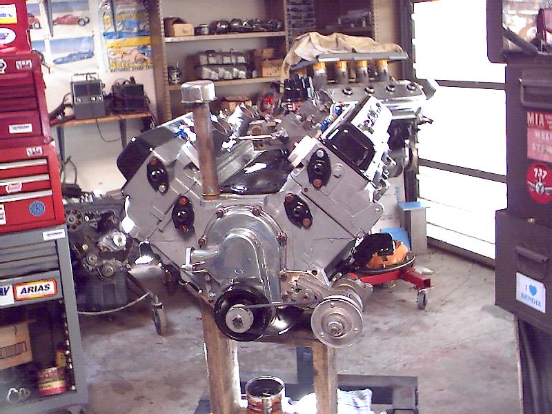

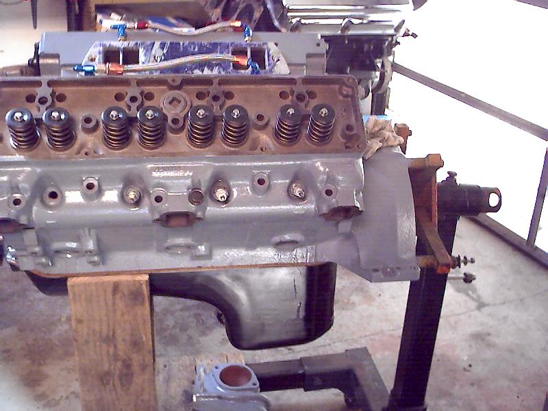

    If you can see it, this is a 2X6 front brace I made for my GMC motors when they were on the stand. I had a hydralic jack under the front when it was turned over. This is a Packard engine but same deal. Not perfect but I slept better with it under the motor. The bottom is supported by cross pices between the legs of the stand. It dosn't show but there are two cross braces keeping the wooden legs togeather.

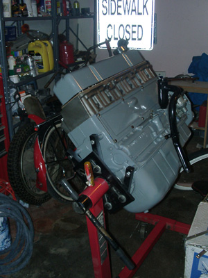

    found this old shot of my 235 on the engine stand. it fit fine but i remember I used to lean it next to the wall or turn it heavy side down so it wouldn't tip over. It held fine but it did seem kind of heavy on there..
