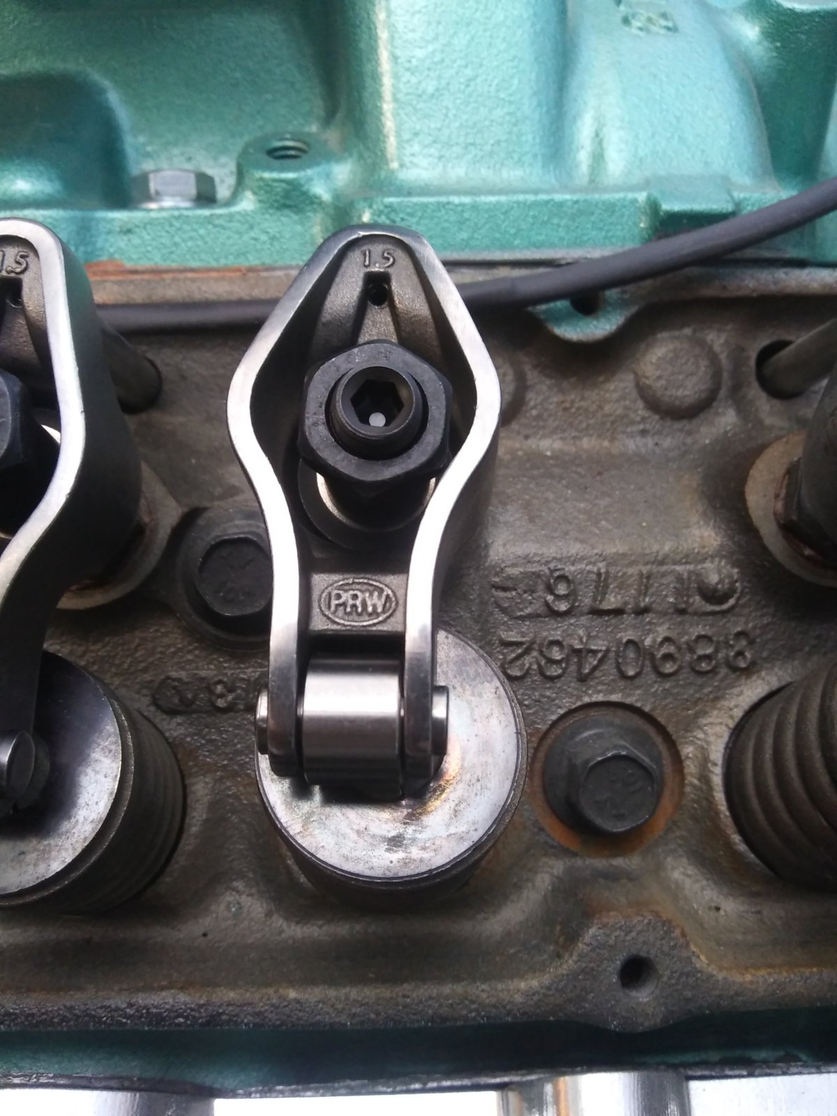

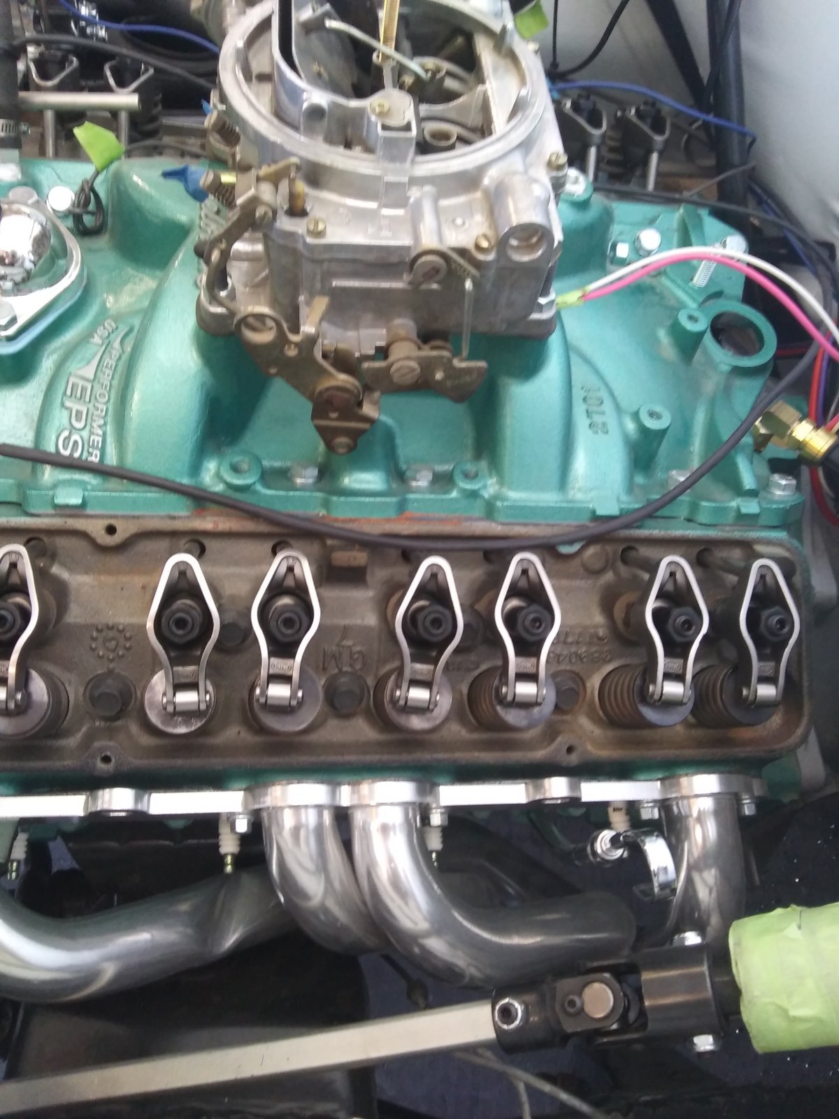

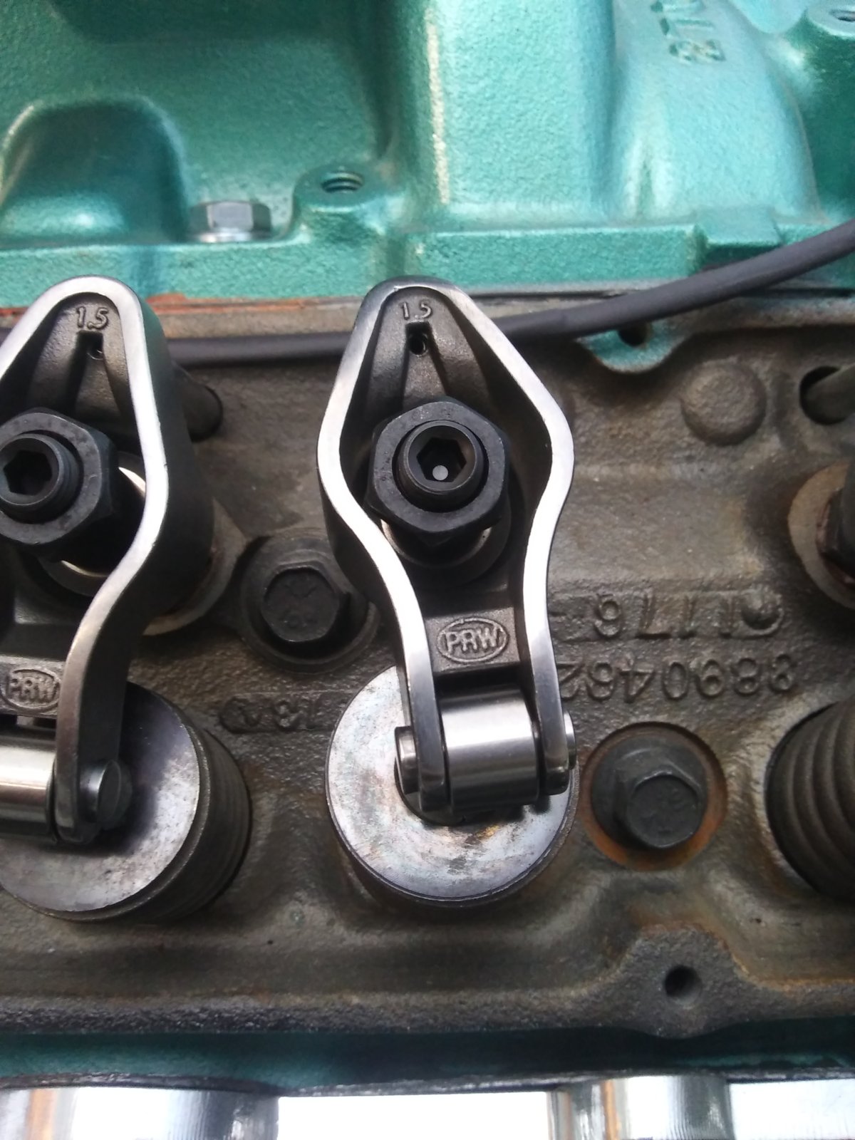

    I've got a customer's Truck in with a 327 that was supposedly rebuilt at one time and ***embled. Everything has been loose that I've touched on this motor and so were the valve covers so I took them off and they had no gaskets so I was going to put some gaskets on them. Upon inspection it's got roller tip rockers and poly locks. The thing is when the valves are closed I can move the rocker about a half inch side to side. This is not normal right? It does have screw in studs. Should it have guide plates? These are 5/16 pushrods 16820069369854857900203665843897.jpg 16820069574553941774986634461383.jpg 1682006977547998569712417919806.jpg

    from Missouri
    Looking at the push rod holes it would need guide plates or self aligning rocker arms.
  3. squirrel
    Joined: Sep 23, 2004
    Posts: 59,855
    squirrel
    Might find that the heads that don't require guides, have slots instead of holes for the pushrods. The slot keeps the pushrod aligned. With these heads, as mentioned, you need guide plates. Later engines (80s-90s) had rockers with an alignment slot on the rocker tip, but they also had pressed in studs. These heads with screw in studs are designed to be used with guide plates.

    They look like 1967 camel hump 462 heads to me, which were not designed for screw in studs..somebody added them. Adding the guideplates should be easy since they're already converted to screw in studs.
    In looking at other 462 heads on the web..id say your pushrod holes are rounder than they should be...allowing too much side to side movement. Check out other similar heads to see what I mean. The normal 462 holes look like a slot with a rounded top and bottom. Your holes look totally round, with a gap on either side of the pushrod. So I would totally add the guideplates..

    wheeltramp brian
    Yes they are the 462 camel humps and yes somebody put screw in studs so I figured they should have put some guide plates in. I pulled the rocker off and checked it with the stock rocker arm and it definitely has more slot in the bottom than the stock one that allows it to move around more. So I may just buy a set of guide plates for it and see how they fit. I've got another 327 here that basically has the same setup on a stand that has guide plates they barely move side to side so I figure that's what needs to be done
