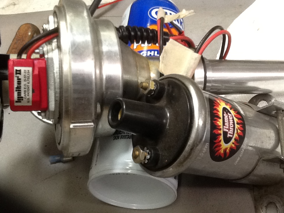

    Is this distributor and coil dependable for the road . Heard lots of bad stuff bout "em".

    The Pertronix II is much more reliable than the original module. The coil resistance (Ohms) must be matched to the stated coil resistance in the Pertronix II paperwork. I don't have that information at my fingertips.

    I love all of mine. Failures are often linked to mis-matched coils and stuff.

    All of this stuff came on a sbc , in a car I bought, I am a points ignition guy, never had points leave on the side of the road !pretty nice stuff to selling at the swap meet , I will use it if it won't let me down !

    The pretonix unit is good enough for everyday driving. I wouldn't be worried about it. If it were mine I would carry a spare control mod. We used to carry a set of points all the time and swapping out the control mod isn't any harder than swapping a set of points.

    Mine failed and I had the correct coil but I figured out why my module failed, make certain you use a high quality copper wires. HRP
  8. They want proper voltage (may require a resistor), good wires and a good coil. Find the original information on the distributer, follow the instructions.

    Match the parts together .
    My first try failed within a few minutes.
    Wrong coil.
