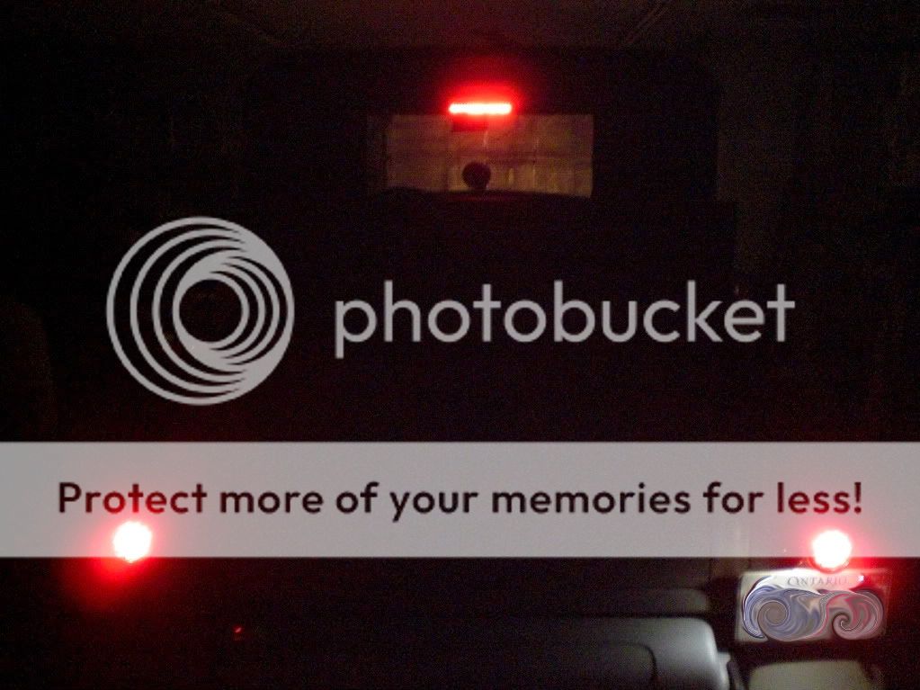

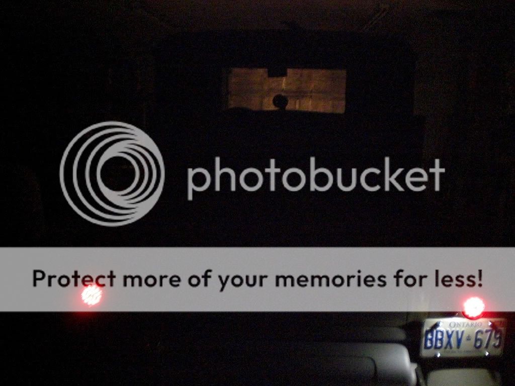

    Like some of the others, I have chosen to put safety at the forefront. The tail lights on our A have 32 housings/lenses on the A tail light stanchions and like someone already stated, from a couple of hundred feet away at night you could hardly see them. I would rather have someone see me in time to react rather than have them plow into the back of me & puncture the gas tank.(spreader bar but no bumper) same reason the car has a third brake light as well. during the day you cannot see the lights at all and unless you are right behind the car you cannot see the individual led's. the original taillights are very small & every little bit helps. during the day with my foot off of the brake you cannot tell they are led conversions. we tried the bright bulbs & the led 1157 replacements. They were still not bright enough IMO.
    I drive the car defensively and try to always have an escape route planned but there are more idiots on the road everyday. Texting, talking on cell phones, screwing with the radio, playing with a GPS and just generally not paying attention = accident waiting to happen. I would rather laugh at them when they run into each other than have them hit ME. I will take all the steps I can to keep them from running into me. To the guys who have the "hasn't happened to me" at***ude - all I can add is.... YET. To the guy who said he would rather be run into than have LED's on his car.....are you ****ing serious? that is quite an at***ude towards life you got there. I have enough hours, sweat & hard work into my car to not want to have to do it again because of an idiot not paying attention for a split second. To those who think it is not traditional, your opinion. My car, my choice. The car will also soon have seatbelts as well.
    The car in the daylight:
    (we switched the plate to the other side after I almost sliced my hand open taking the gas cap off)
    The car at night with the lights on/brakes off:
    The car at night with the brakes applied:
