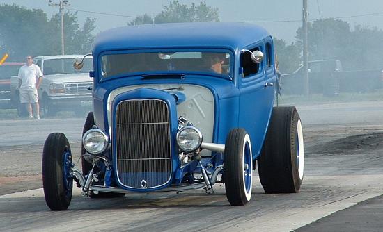

    I have the wide m/t radir slicks and they didnt hook at all. My car isnt a race car by any means though so i didnt by them to hook at the strip. They do pretty good on the road. Even though they arent terrible bad in the rain, i still dont recomend anticipating rain when driving on them.
    The reason the tire wear is in the middle is because the wheel is too skinny. I got a 10 inch wheel for a 10 inch tire and it wears pretty evenly. If you want it to wear more evenly and not just in the middle buy a wider wheel than what you have.
    Picture taken by Crow and Beky
