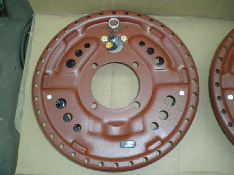

    I guess you could put this on a drill press, but it might tip it over.

    That’s a neat pic. At least it gives me some ideas on spacing.

    I'd skip the big holes and use those old style cast alum brake scoops.

    Since you are mainly concerned about appearance, why can't you make a template of the backing plate, then lay out the holes where you want them, place the template on the backing plate and mark the hole placement. Then center punch and drill on your drill press? The template is ready for reuse on the next backing plate. Or is this too simple a solution?
    hotrodA, Unkl Ian and Crazy Steve like this.

    What they said. Lay it out on poster board or sheet metal for a pattern .
    Index and locate it off consistent spots on each backing plate.
    Center punch and drill away.
    Should be close enough that your eye will not pick up any difference existing between the two.

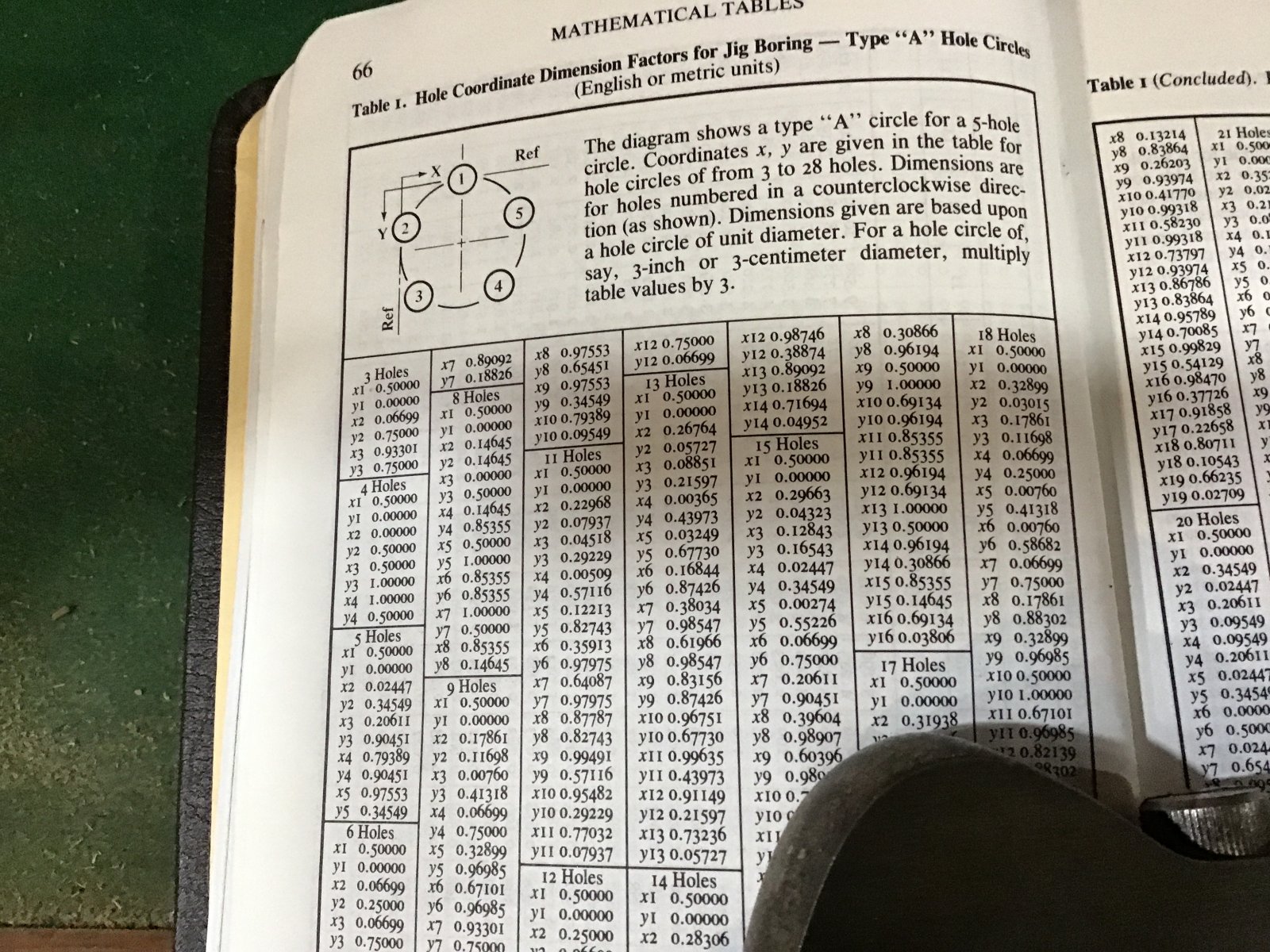

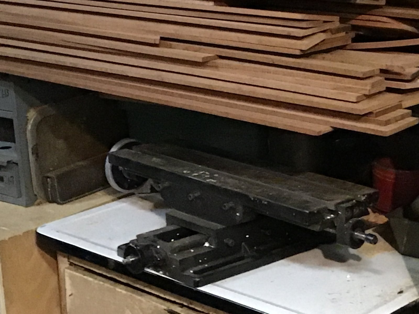

    I like the idea of a rotary table but I personally would use a x y table. I have a number of accessories for the milling machine like a turntable ,rotary fixture and indexing fixture etc and don’t use them much . A x y table will give you a better positioning on the holes . I ran a jig bore machine for many years and everything was X and Y dimensions . This we long ago before CNC I wish we had a CNC back then lol. Also with a simple X Y table you can use it as a light mill as the aka mill drill machines are beefed up heavy duty drill presses.
    Also invest in a copy of the machinery hand book for formulas like bolt patterns and everything in between.
    I wish you were closer as I have a x y table collecting dust that I just don’t need or use. image.jpg image.jpg image.jpg
