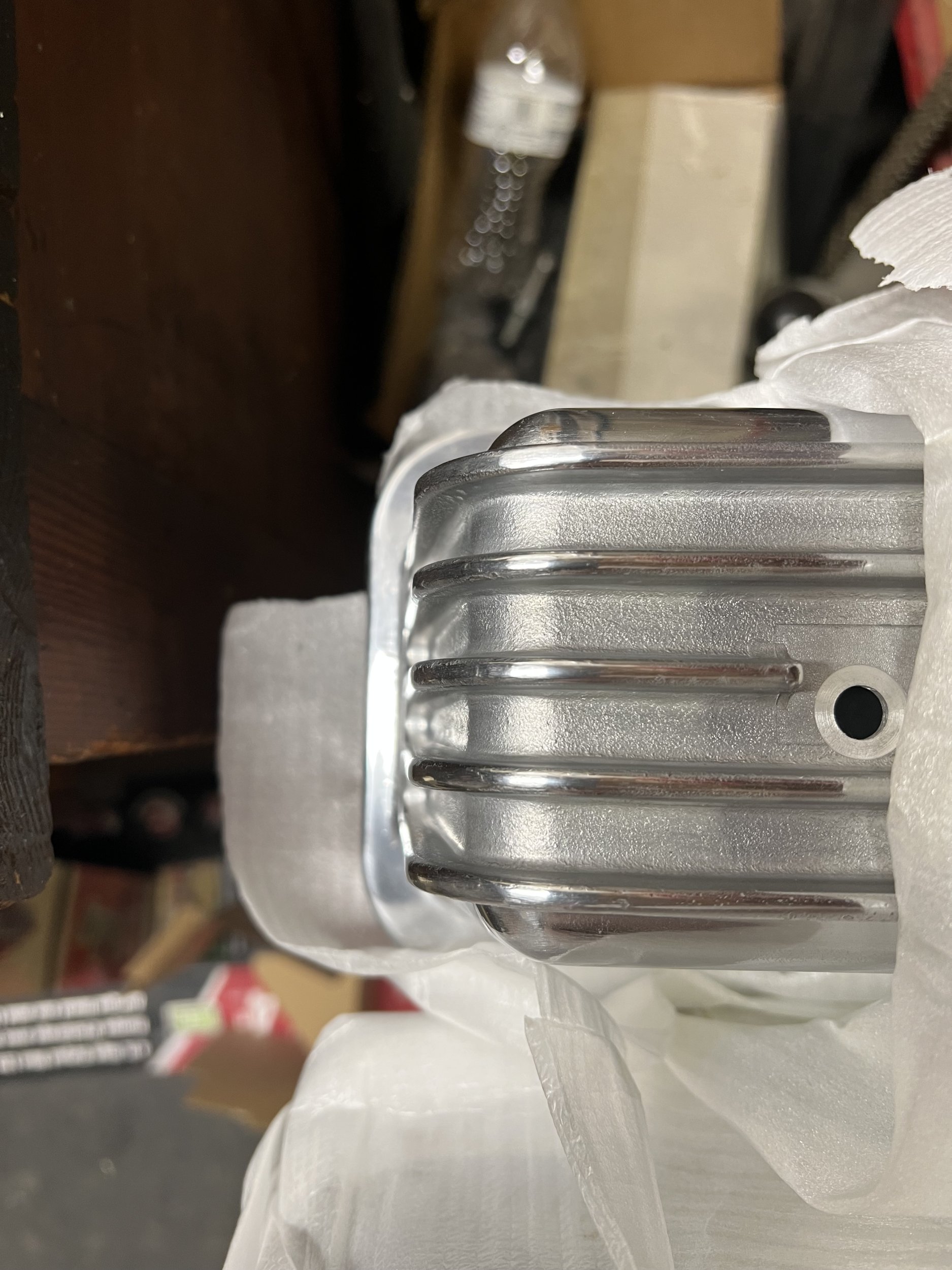

    Valve cover for Most Vortec I think are ugly , The 1st pic of are hard to find ,
    & Most time Not what you will receive
    Most seller copy past & do not know there a different in how they are shaped,
    I had to order from 5 venders Until correct Ones delivered, Not as good looking of Old Cal customs but better looking then
    2nd pic ,
    & good cast you can Just use the outer bolt Like Old Ford T birds , making
    With thought to block off 2 center Holes
    & make fines .
    Black ones Oem stamped .

    You can buy adapters to run old school valve covers on Vortec heads. They'll add a little height to the covers obviously, but if you have the clearance, they're a pretty slick solution.

    Yes , I have been there before , Kept Leaking , I tried many ways Gaskcket's
    Type , Direct ceiling the adapter to the head with GM gasket maker same Toyota gasket maker,
    Spent may Frustrating hours,
    The solution was the adapters are bigger than the head so oil was laying on top of the adapter and seeping between the valve cover and the adapter I took a mill a Ball channel all the way around the valve cover , sides and across bottom and drilled holes so the oil would stay in the channel Drain run down into the head that solved the problem ,
    Just giving some input if anybody goes that route . "Adapters"
