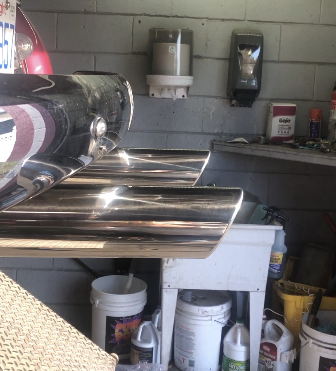

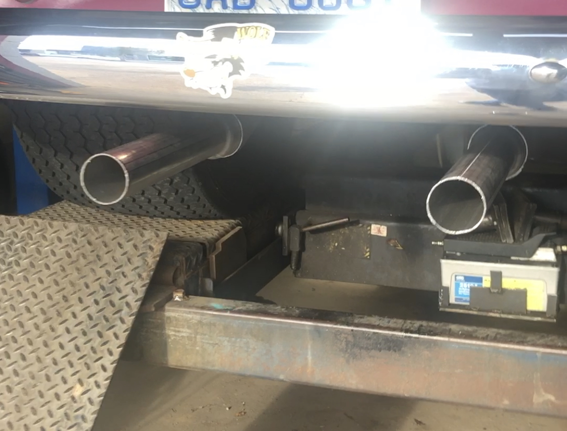

    Well I seem to have resolved the problem with the longer exhaust, I told my guy I’ll take the hit if somebody says anything about the look on the rear end now but to tell you the truth the way the car is shaped I think the long pipes look good and the nice thing about it is the sound is incredible because he reduced a 2 1/2 or rather put a 2 1/4 onto a 2 1/2 The 2 1/2 inch pipe that had the original Tips weld it on so basically I’ve got about a foot of 2 1/4 inside a 3 inch tip gives me a little bit more back pressure and the sound I really like the sound because now I don’t hear that loud noise inside the car I’ve got the Borla crate mufflers I took off the flow masters those are just so loud and now I don’t have the smell inside anymore with the windows up or down I never had smell with the windows up. The original tips that were on the car we’re basically the same as the new ones except they didn’t stick out quite as far although they were out past the bumper but they were very sharp and if you bumped into him and cut your leg these are not sharp

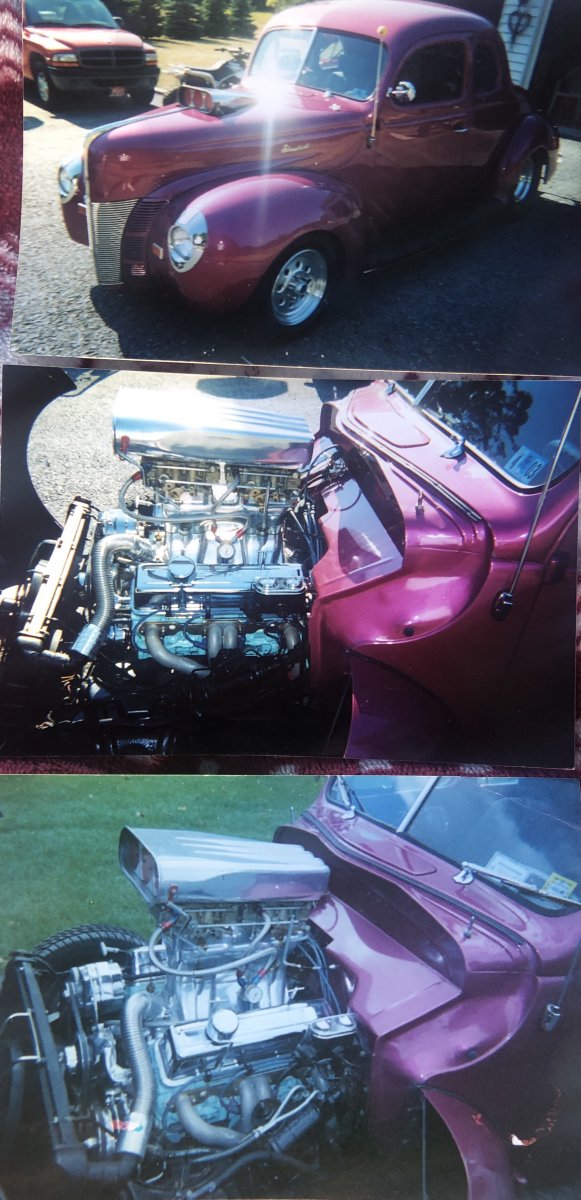

    The car originally was built for racing about 15 years ago then the big motor and that was taken out and now just a stock 350 crate motor nothing modified just a Edelbrock four barrel carburetor but the rest of the car was left as is so just a standard 350 in it I was just out riding it and it’s much better than what it was this is what it used to Look like

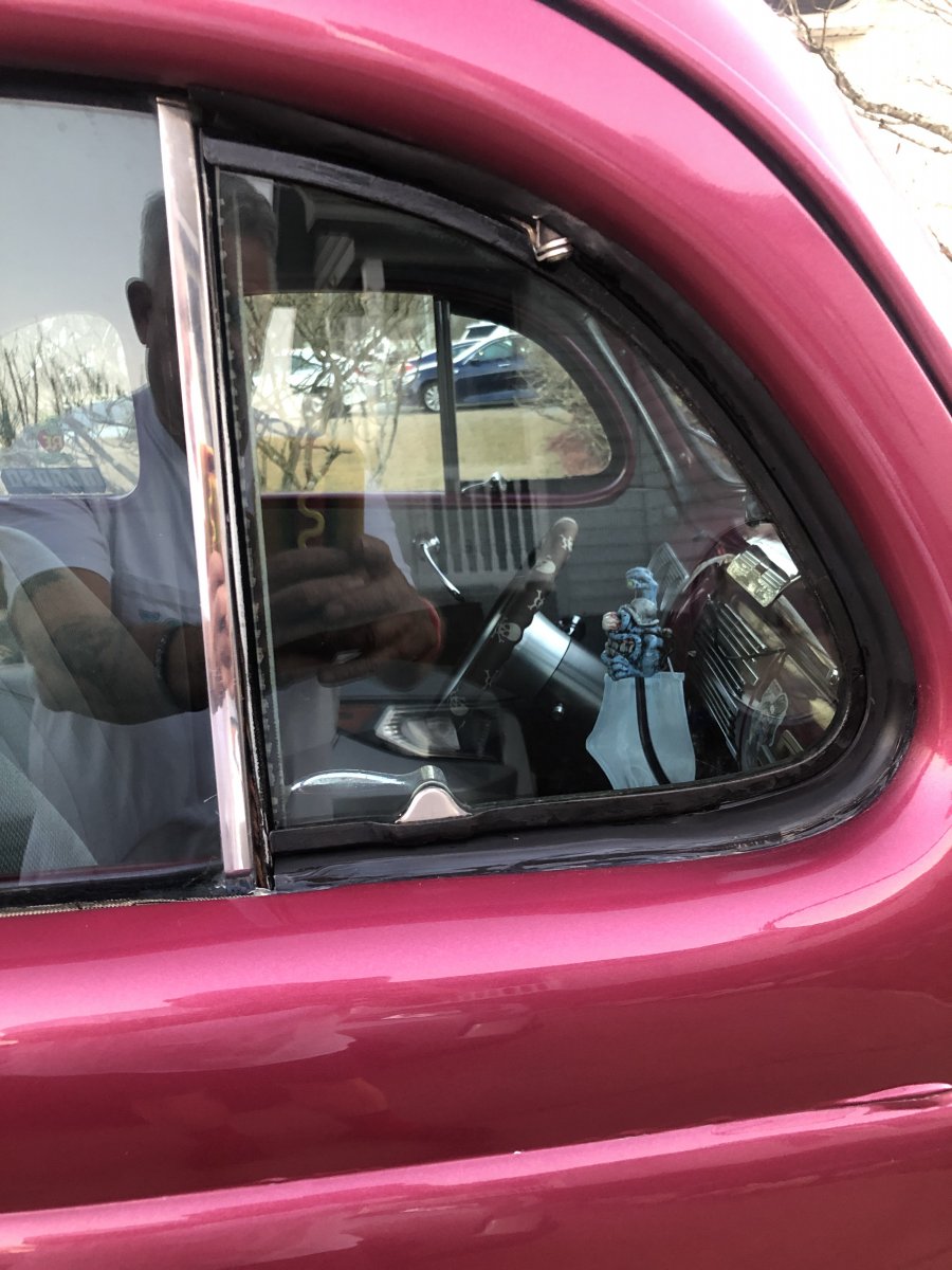

    So when you opened up your vent for the positive pressure I was just thinking about this do you think if I opened up my vent windows on my drivers and passenger side might produce the same results guess I’ll try it next time I don’t have as much smell in there as I used to matter fact I really don’t smell it like before where I was getting a headache, I’m sure there’s still a little coming in but not where you can notice it enough and I would have to think with the windows down there’s enough fresh air that it wouldn’t be harmful.

    I'm not familiar with '40 vent windows, but if they will open more than 90 degrees, forcing air into the car, they would act just like a cowl vent and positively pressurize the interior.

    It’s basically like most cars that had the little window with the latch you lift it up and you push the window out towards the door or push it forward like you’re pushing it towards the windshield and mine will definitely go 90° it’ll blow air across that Dash if I needed to. Usually there’s a bar that separates the regular drivers window from the vent that’s built into the drivers and passengers window so when you roll it down the vent is basically sitting here on its own you can open it up and there’s no separator bar there so it’s kind a like a complete piece of glass with a split

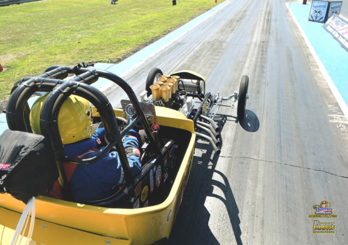

    It is a nostalgia drag car, Zoomie headers were quite common back then on injected cars, we are not out to wring every last bit of performance out of it. it still has a magneto ignition, and i like the way they look and sound
