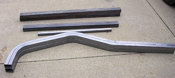

  6. It was cold out today but I was excited.....about a pile of metal

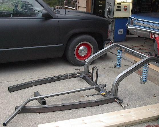

  7. I cut pieces and trimmed them to fit and tacked them. Then I mocked up the pieces in the driveway. I'll save this welding for another day, when I get a opening on the welding table for a few hours. Right now everything is c-clamped together.

  9. Been tinkering a bit....It takes a while to get everything square when you are working on a floor that was not poured to be flat but rather sloped. Not impossible....just take your time and measure EVERYTHING! My last Garage/shed was flat.....poured and finished it myself just for these reasons.
  10. I really like the Lennox holesaws but hated the Lennox arbor......my solution was a Rigid brand arbor (Home Depot) and Lennox saws (Lowe's). I didn't care for the Rigid saws...... I'm going more for a racy look so I will not be finish the holes with tubing (But this could change at any minute)
  11. I went with a triangulted 4 bar in the rear. This is an ART MORRISON setup and the craftmanship is great....they even give you a nice blueprint of how it supposed to be setup. Since this is all getting jammed into a Model A bed I tossed the print to the side and went through days of putting numbers into a suspenion geometery calculator until I got my desired anti-squat and roll center. I tack welded it all into place and checked all the measurements and just for shits and giggles compared it to the Art Morrison print....damn they were close!:rolleyes:
