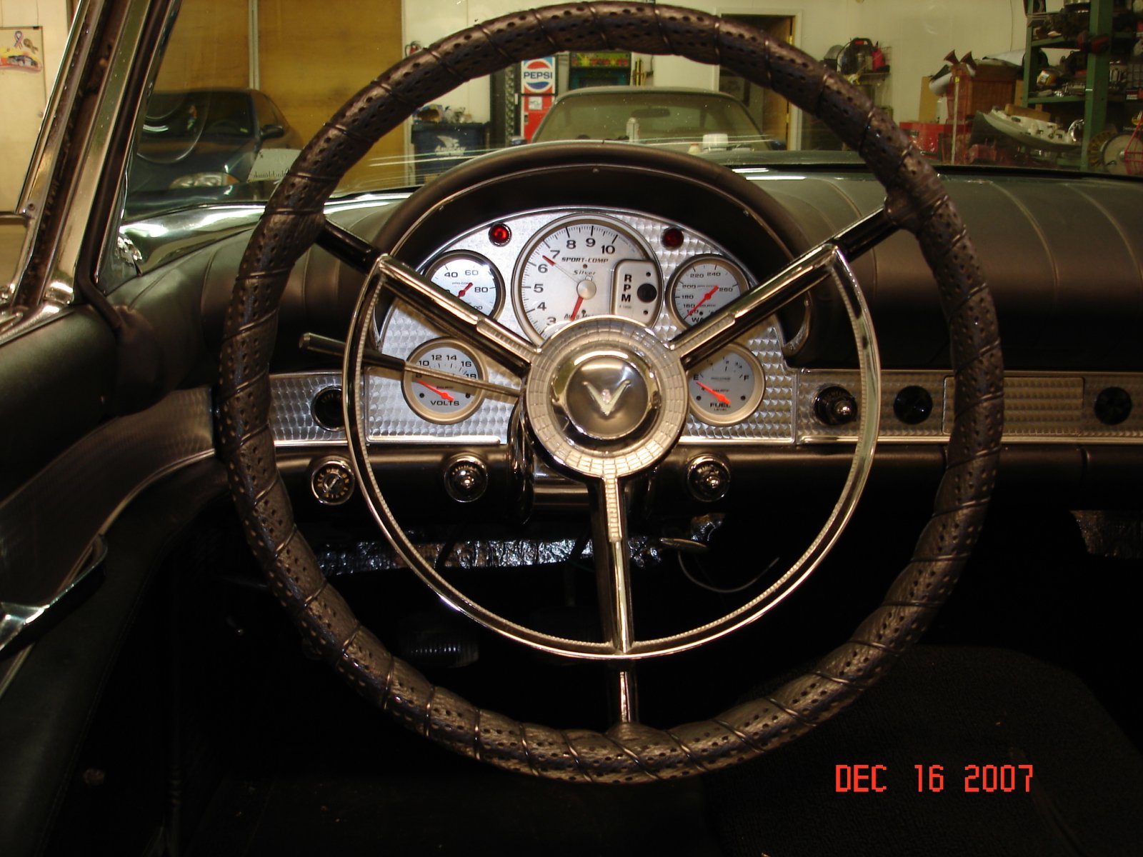

    We think alike:):) in my 57 Bird. 100.jpg

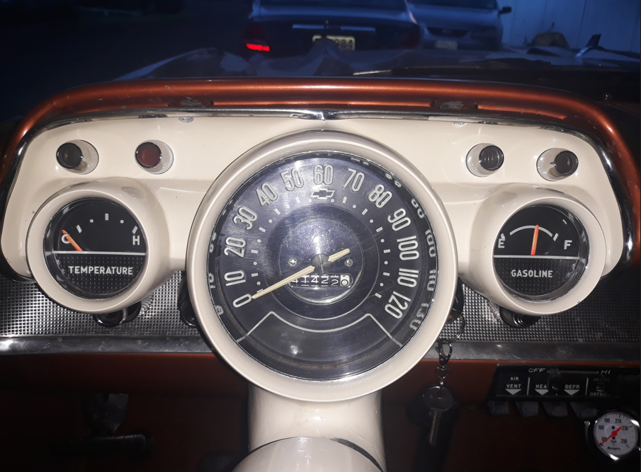

    Tri-5 Chevy's and most early fuel gauges are dead easy to repair. I've even re-soldered the coils in them.
    There is one peril of time with these old gauges ............ that is somebody in the past who is clueless ****ing with them
    Here was a trap I encountered, the gauge "sort-of" worked.
    It was connected "back to front" and when I remedied this..... it stopped working at all.
    When I looked again the Temp Gauge had 1/4 increments and the Fuel Gauge had continuous sweep
    This is how I got the car [ note the aftermarket mechanical Temp gauge in the lower R/H corner]
    All I did was swap the Temp and Fuel gauges over to the correct side [L to R, and R to L ]and connect them properly.
    I had a spare rusty tank laying around, so I mounted the sender in this with jumper wires to the harness , then flipped the tank upside down [to simulate full tank on the float] and back.
    I needed to make a few adjustments [bends] in the float arm, so it reads empty with 1-1/2 gallons reserve.

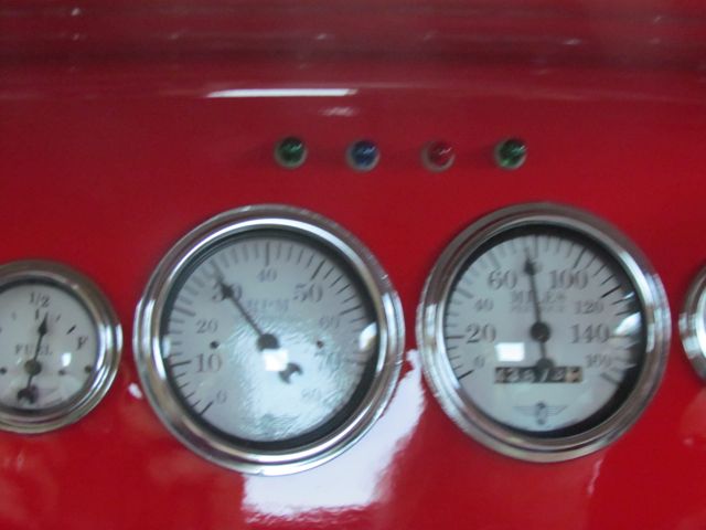

    Build picture 4.jpg Yep got all the gauges

    Actually, I was busy admiring the ''GR'' position on the shift indicator. For a Hydromatic.
