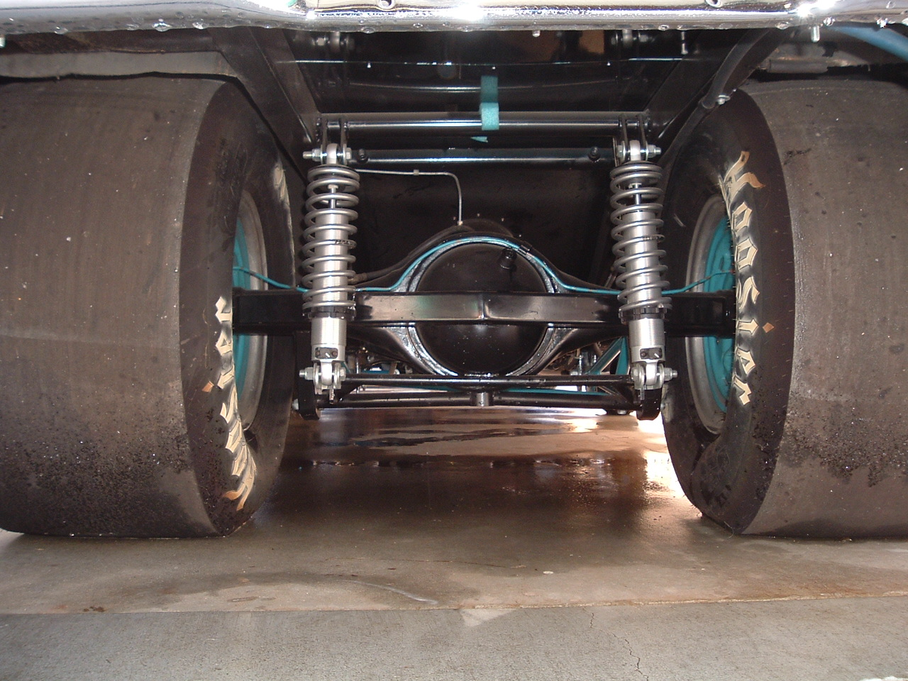

    Here's my question with the snubber. Do I need to run one if I am going to have a triangulated 4 link? I am building a coupe will be running a big block and 4 spd. I always ran adj. snubbers on my muscle mopars, but they were with springs.
    Matt
  3. bentwings
    Joined: Jul 1, 2007
    Posts: 133
    bentwings
    MM... If you are running a prostreet rear end with about 19-20 inches between links side to side I'd guess you will be ok without it. Our dragsters are about 19-20 inches at the mounts and I can't say I've ever seen a twisted rear end. However we do use anti rotation devices and mounts so effectively we have the pinion solid mounted.....no snubber but no movement possible. For a sprung car if it's heavy and lots of torque with a 4 link I don't know how you would run one as you probably have positive anti-squat so the body/ch***is will rise rather than settle toward the pinion. I'd do a stout back brace even though that won't help the twist as noted above.
    On second thought you are running triangulated links so you probably won't get ch***is rise. That being the case I guess if you are going to race occasionally I'd make provision for a snubber to be added at the track. I'd set the ch***is right on the pinion for starters. Better safe than sorry.
