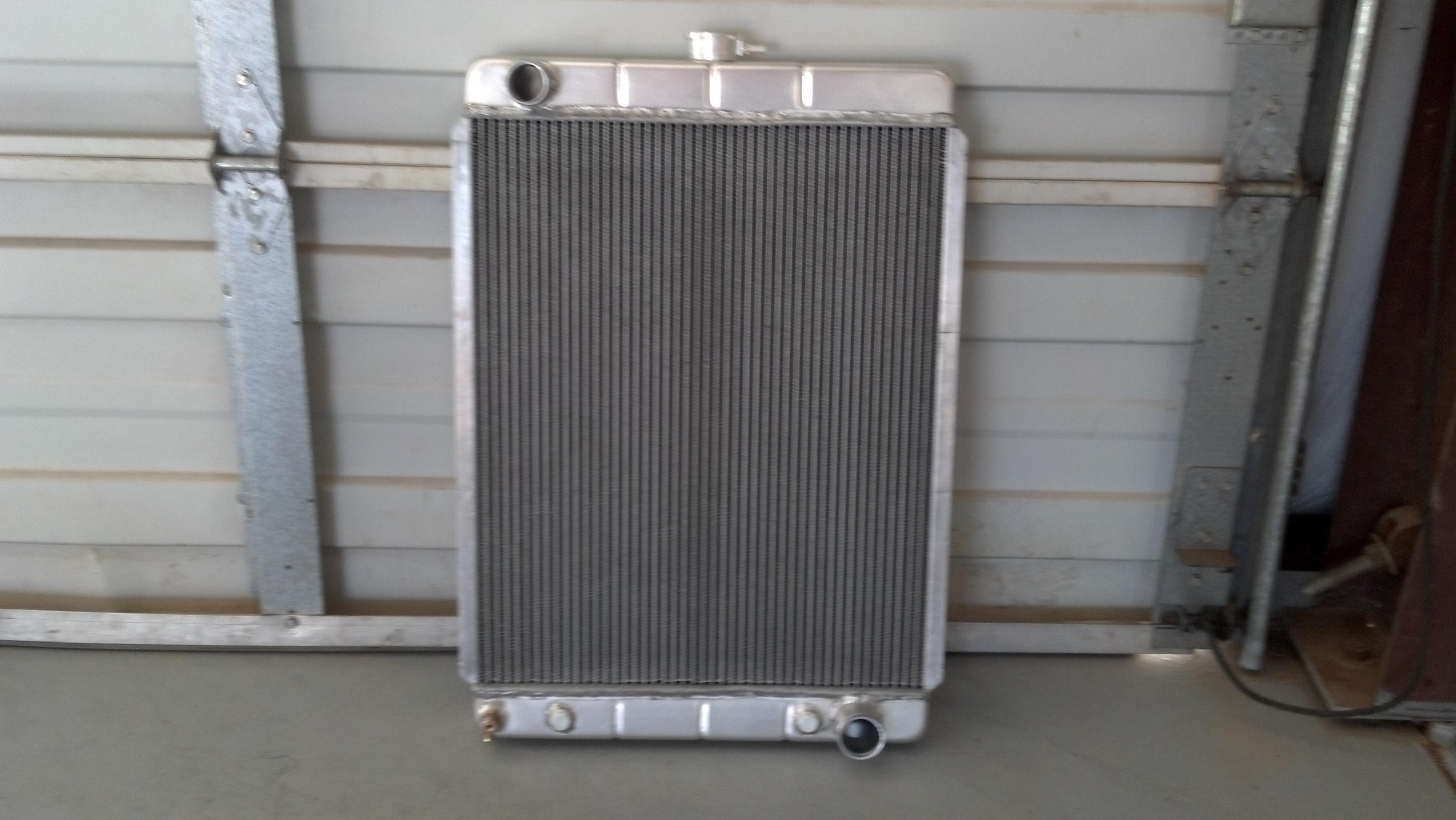

    Little progress today....and the radiator finally showed up so will get on that right away....

    Anymore updates? and where does the radiator mount?

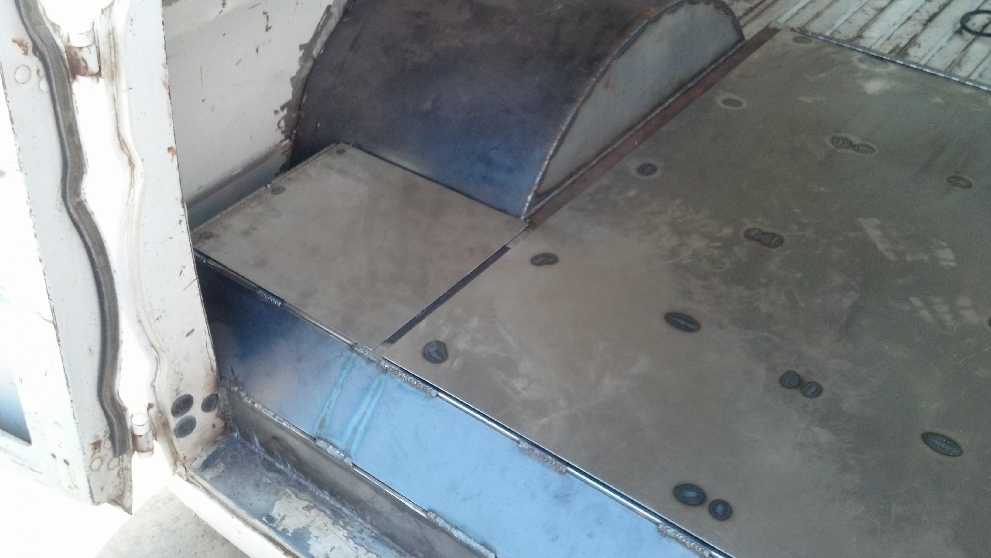

    Had to make my mounts. Mounts the same just had to add the material to the sides. Been busy on other stuff and will get back to this this weekend.

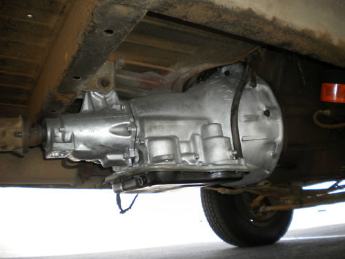

    Depends. The early ones used a V8 bellhousing transmission with an adapter. Later ones used a /6 bellhousing trans. Take a look at where the starter is located. If it is up high, it's a /6 trans. If it's lower than the crank centerline, it's got the adapter and will bolt up. The adapter is worth bucks.
    With a 100, you are limited to the short tailshaft housing trans, so your driveshaft isn't too short.
    I just dropped off a pair of them to the college for rebuild. A BB one and a SB one. The bell is different for them too.
    If you are not going to use this as transportation, you might as well go big. If you want a real nice small block, take a look for a later model magnum. They can be installed with the EFI or retro-fitted to standard small block ignition and a manifold/carb. If you really can't find a trans, I may be able to get one to you, but we are on opposite sides of that big hole in the ground.

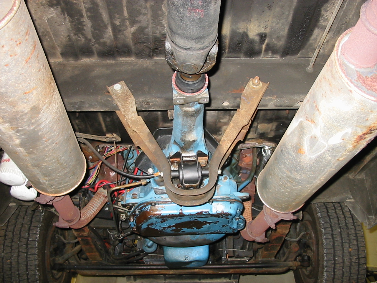

    I forgot to mention, there are other things involved in a /6 to V8 swap.
    With the work you have done, it's probably no big deal, but here goes...
    Throttle linkage or cable? Cable may work, linkage will not. Do not forget the throttle pressure or 'kickdown' linkage is different too.
    Radiator - lower outlets swap.
    trans cooler lines may need tweaking, shifter cable should be fine.
    Minor wiring differences.
    Body-to-engine mount brackets are different. Ths was posted on the Yahoo group, I grabbed the pic.
    The 360 uses a different engine bracket. You can modify yours or get the right one. Here's a pic from an auction.

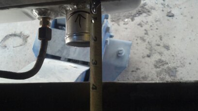

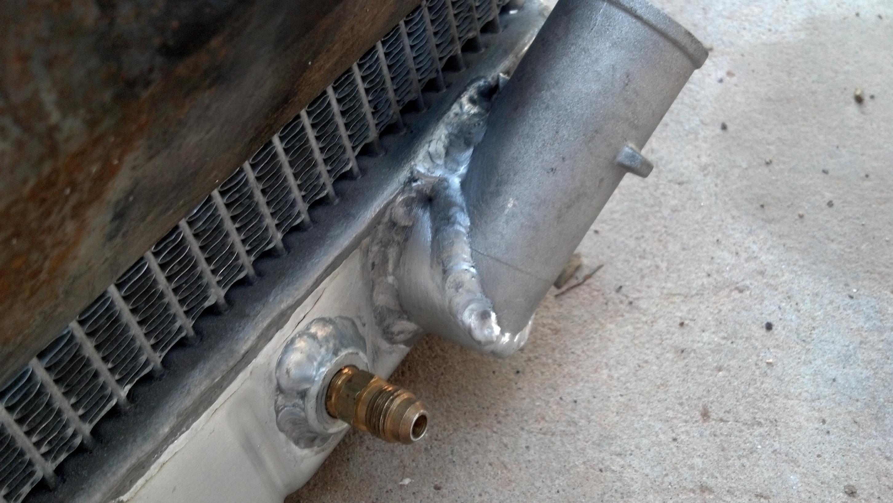

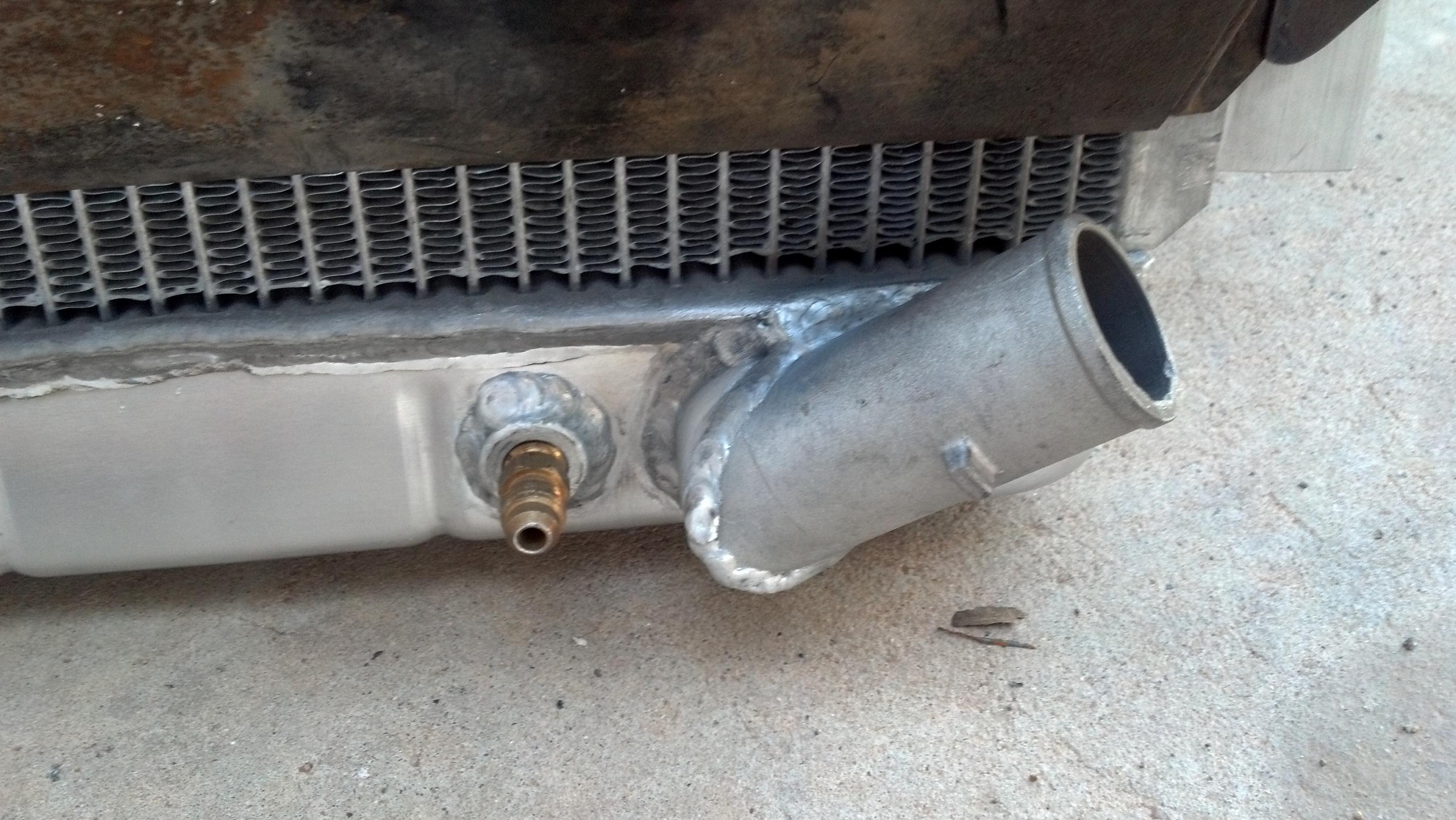

    Sorry i have not posted in a while...been busy at my shop and no time for the van. But started running the battery cables to the rear and installing the radiator yesterday and ran into yet another snag! The front axle swings right past the lower radiator port so have to cut it off and make it turn up 90 degrees so it does not contact the axle at full drop. Should be able to fire it up for the first time in a year this weekend.....pretty excited!

    problem solved...made it a 90 degree. But now cant get part cuz everyone has left for the holiday weekend so next week it is.
