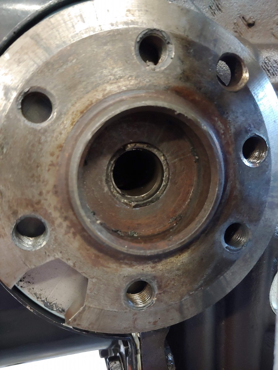

    I cannot get a caliper into the pilot hole but I can feel that here is a step for the torque converter, then there is a smaller step and one smaller still. It feels like the crank was finished for a pilot bearing because the od of the second step is larger than the pilot drill. Does that make sense?

    73RR, Good info! I had in the back of my mind about a Jeep bushing/bearing. I just couldn't remember what is was. I just remembered about the problems I faced 30+ years ago on the ones I converted.

    When using the Jeep bearing, I think that you may have to trim off some of the input shaft if the crank isn't machined fully. Check the fit before bench pressing it into the car.

    Ok, I confirmed that my crank is drilled for a pilot bushing. I confirmed this by tapping a pilot bushing into the crank! So, I'm good to go shopping this coming weekend for an AX15, etc. I still need to find a flywheel.

    I am getting ready to start a build on a 1952 Plymouth. I am planning on dropping in a 360 magnum mated to a AX15 but was told that it would not hold up to the 360 magnum. From what I am reading here the AX15 is stout enough? I am looking for mainly cruising around with the occasional hot rod moment, every now and then you have to stomp on it. Is that the consensus here?
  30. rockable
    Joined: Dec 21, 2009
    Posts: 5,391
    rockable
    I don't think you will have a problem. You don't want to be drag racing it every weekend, however.
