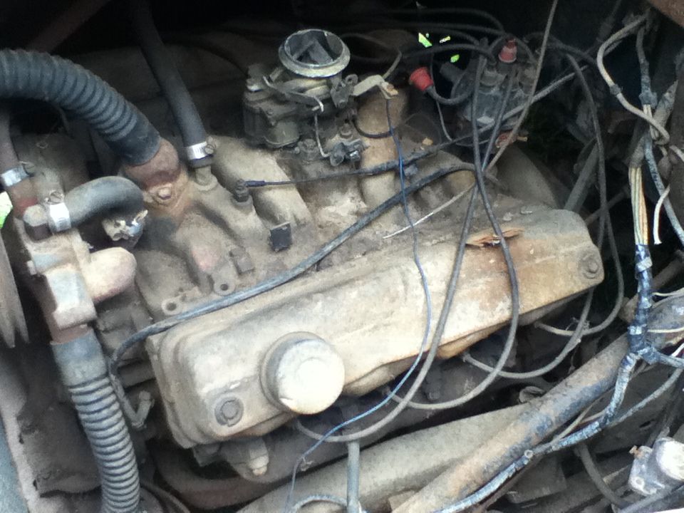

    what is the original motor and tranny for a 1954 dodge truck? its a v8 3spd

    Could be a 241 or 271?

    What model 1954 Dodge truck is it? There were two different models that used a three speed.
    According to the Dodge Truck Service Manual, depending on the model, it should be either the 241 like nobo D said, or a 331. The 241 was fed fuel from the right (passenger) side. The 331 fuel pump was on the left from side of the block, and was not offered in the smaller trucks. Looks like yours is a 241.
    The transmission was identified by the model of the truck and wheel base. Therefore it was either a C-1-B6, 108 Inch Wheel Base, or a C-1-B6, 116 Inch Wheel Base. Gear ratios were different between the two, as well as the gear oil capacity. They may have had subtle differences in their cases.

    That's a Stromberg WW-topped '57 - '66 318 Poly - and NOT the original motor for that '54 Dodge truck! :D
    Other than the heads, exhaust, and intake (not to simply things too much), they're regular, old Small Block Mopars.
    The '62 - '66 block bolts up to anything a Small Block Mopar does. The '57 - '62 block needs an Early Hemi adapter to do so.

  5. What Jason said. That ain't the original engine.

    judging by the generator I'd say 57-61

    I just looked at a 65 Coronet with a 318 poly. Definitely in that family.

    Spot on!

    There's a following of the "A" Poly, including a cople of big fans. Use search. They can take a pretty good overbore. OEM 2X4 intakes are fairly cheap, but aftermarket 4 bl ones are big money. Covered in Tex Smith's Hemi book, though they are a different engine(nonconvertable).
  11. It is a 277,303, or a 318 with the raised truck water pump housing.

  15. Yep scallops are not deep enough to be a mid '50s Poly.

    The fact that the intake seals the valley makes it an A Poly.
