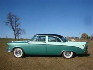

    This is on a 56 custom royal all original.
    Built many a engine for my dragster and cacklecar, I dont like leaning over a fender but if its not a big deal I will do it for pops.
