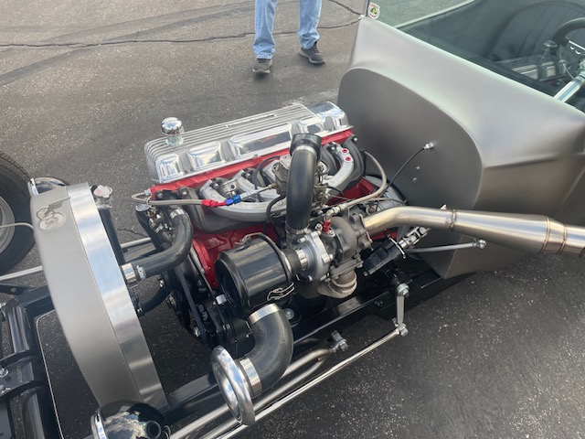

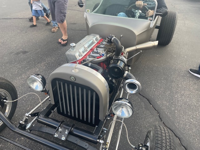

    from Mesa, AZ
    Here’s roadster that showed up at a local Cruz in last Friday. Running the Super Six setup with a small turbo. Also interesting is he was running a SlantSix 727 which are hard to find.
