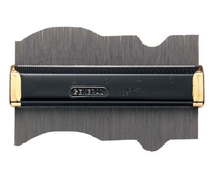

    If you could be persuaded to pull the engine, you could use a contour gauge or 3 to get a profile for making a crank scraper.
  25. Yeah shoot me his #
    No - I'm not persuaded :D Good seeing you at the track - was kind of hectic as you could probably tell ;)
