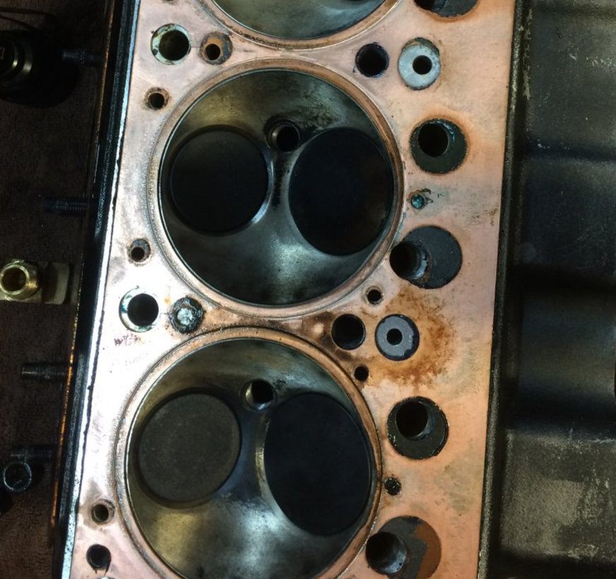

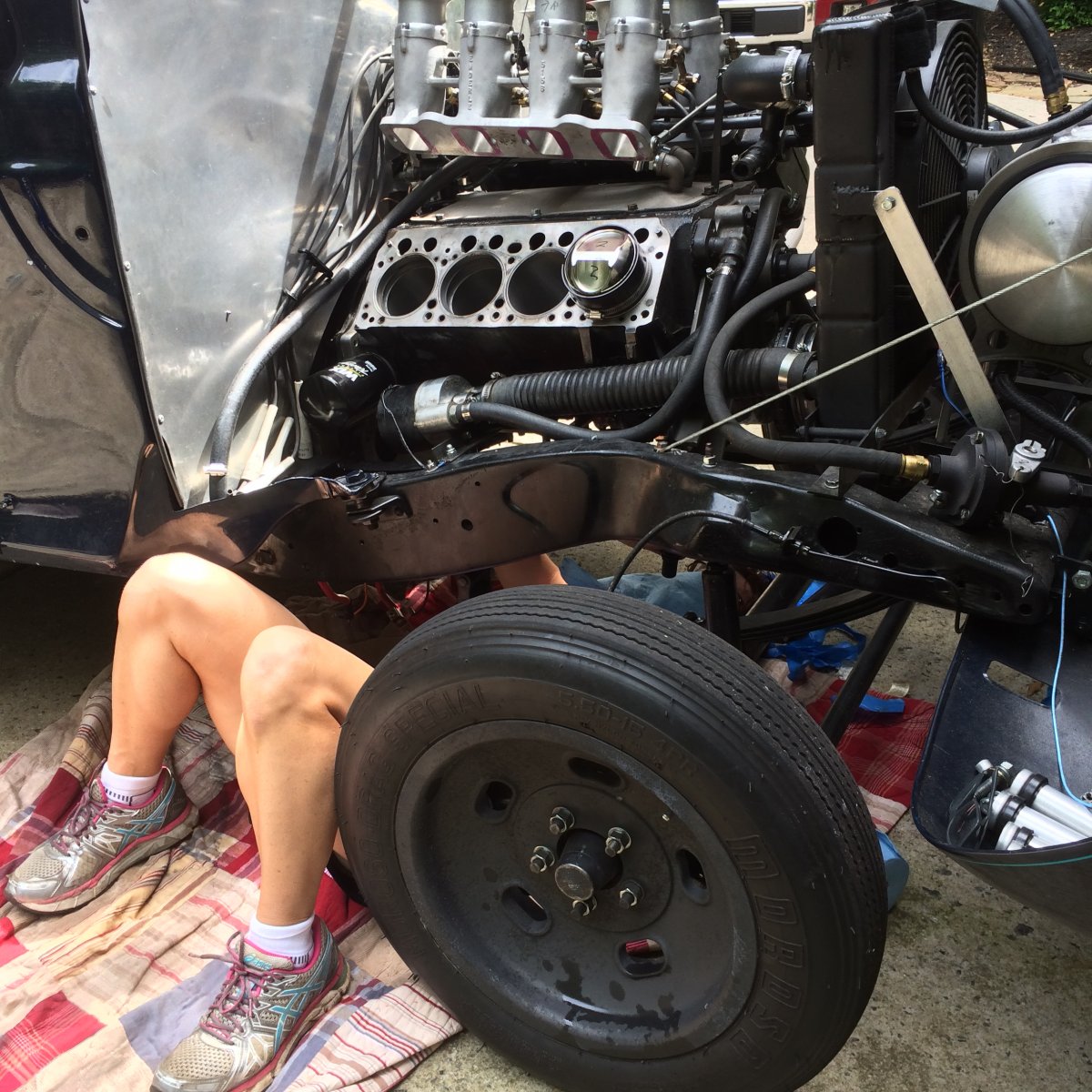

  9. between the bottom two cylinders there seems to be a oil pattern coming from a stud hole. is this possible the cause.
    mad mikey and loudbang like this.
  10. Tudor
    Joined: Aug 20, 2003
    Posts: 6,911
    Tudor
    from GA
    I think you are referring to this splotch of oil on the head??
  11. Dog_Patch
    Joined: Nov 12, 2007
    Posts: 5,133
    Dog_Patch

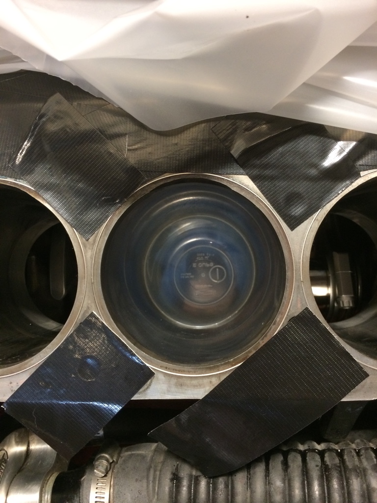

    That's oil from my experiment. I removed the rockers and pumped the oil to see how much was coming up through the head. Then removed the head and also pumped it to see if the cam bearing had rotated and blocked the oil p***age. I'm actually surprised at how little oil is coming up there. Its not blocked - the cam just p***es by the hole briefly so there isn't a lot of flow.
  12. dirty old man
    Joined: Feb 2, 2008
    Posts: 8,910
    dirty old man
    When you see a piston with carbon in the center and practcally clean around the edges as we see in this engine you can be fairly certain the oil is getting past the rings and washing the edges so heavily that the carbon is in the center and almost none around the edges, just sorta stained.

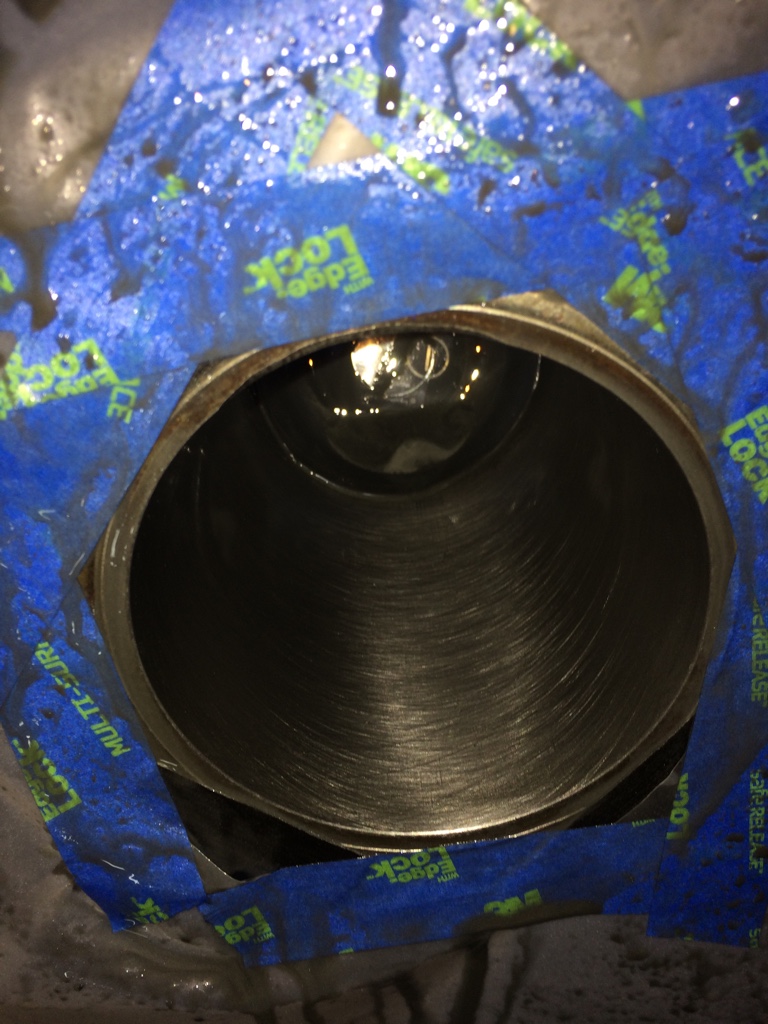

  13. saltflats
    Joined: Aug 14, 2007
    Posts: 13,632
    saltflats
    from Missouri
    The good news is you can hone the cylinders now.
    The Grump found some H/P when he re honed after the engine was run in.

  14. Dog_Patch
    Posts: 5,133
    Dog_Patch

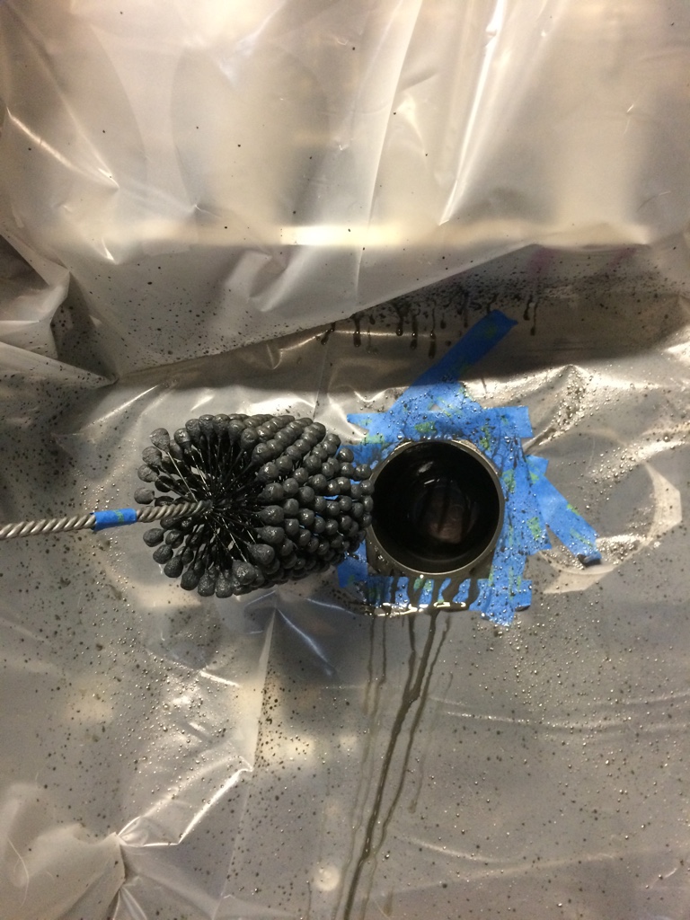

  18. Dog_Patch
    Posts: 5,133
    Dog_Patch
    Hmmmm this could come in handy ....
    Love that show. Funny the connection never occurred to me though.

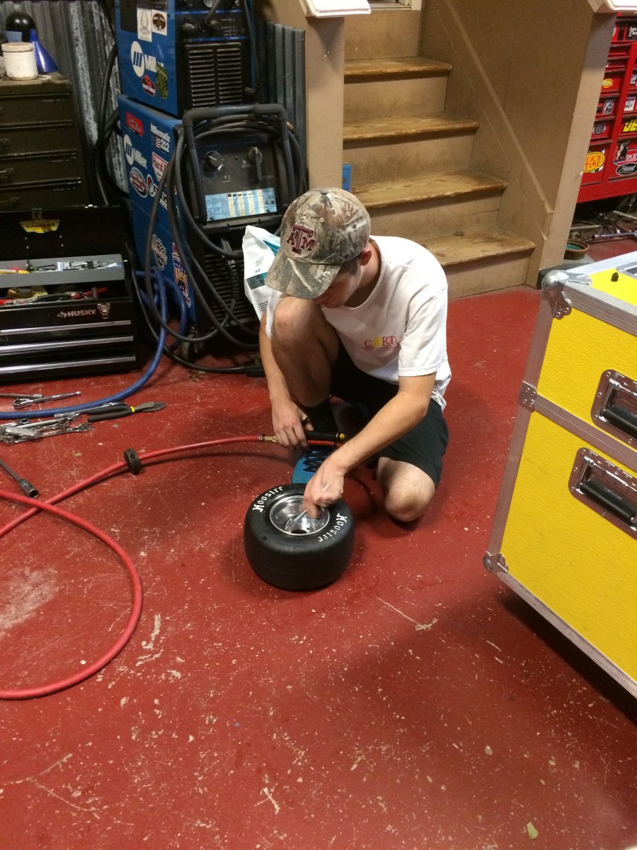

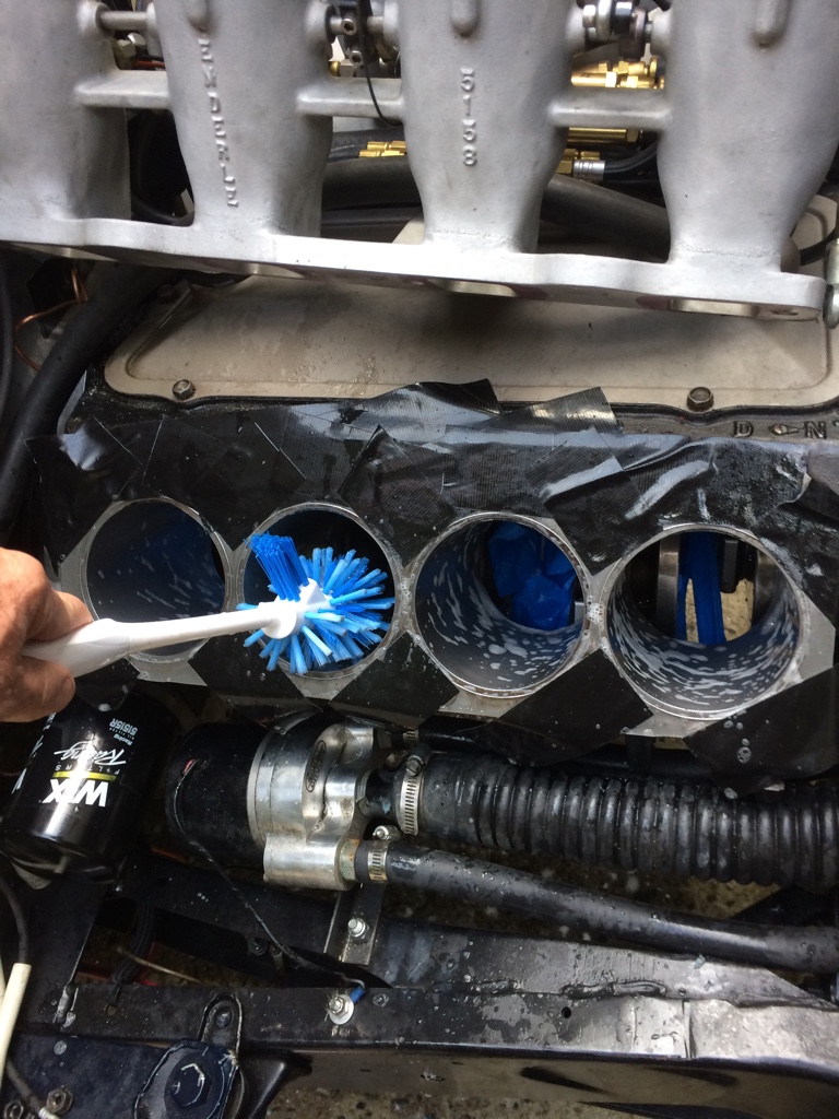

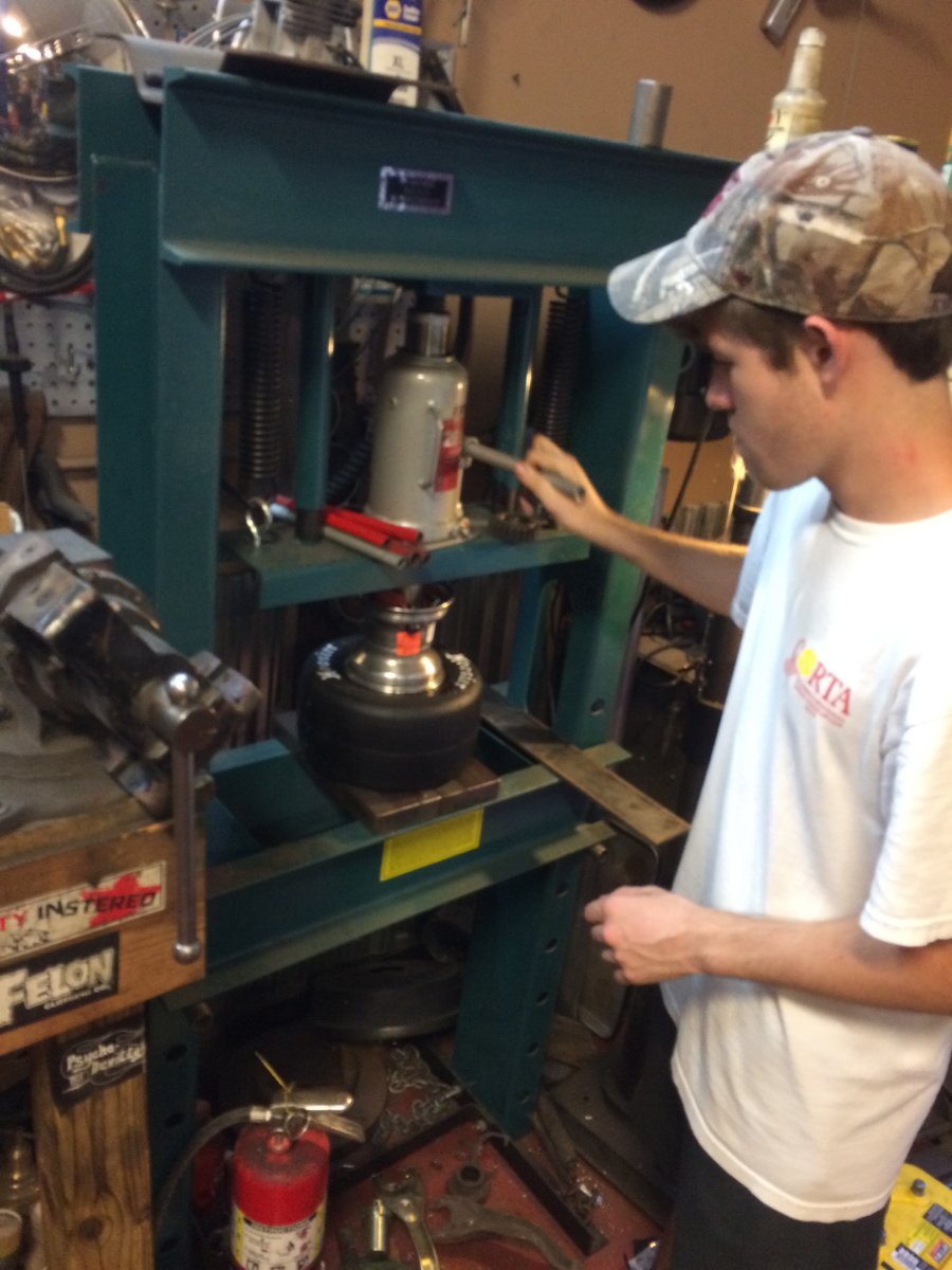

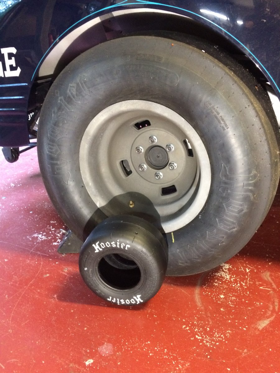

    Last night Jack shows up and wants some Hoosier Slicks mounted :rolleyes:
    The press seemed like an easy task - but no it didn't work.
    Motorcycle s****s did the trick.
    After the big hone job, got plenty of help from the crew.
    Hatchet, Floater03, catdad49 and 7 others like this.
