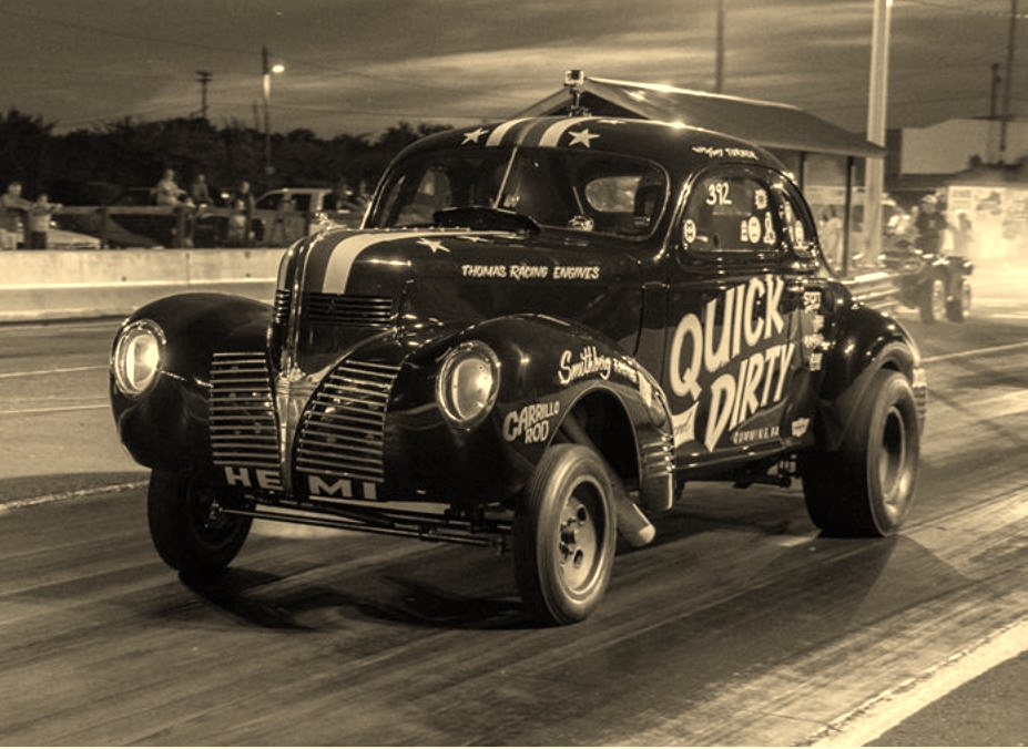

  11. loudbang
    Posts: 40,342
    Thanks for spending all that time getting those shots posted. For your efforts I have enlarged and trimmed them a bit and turned them black and white like the old days :)
    catdad49, kiwijeff, Hombre and 8 others like this.
