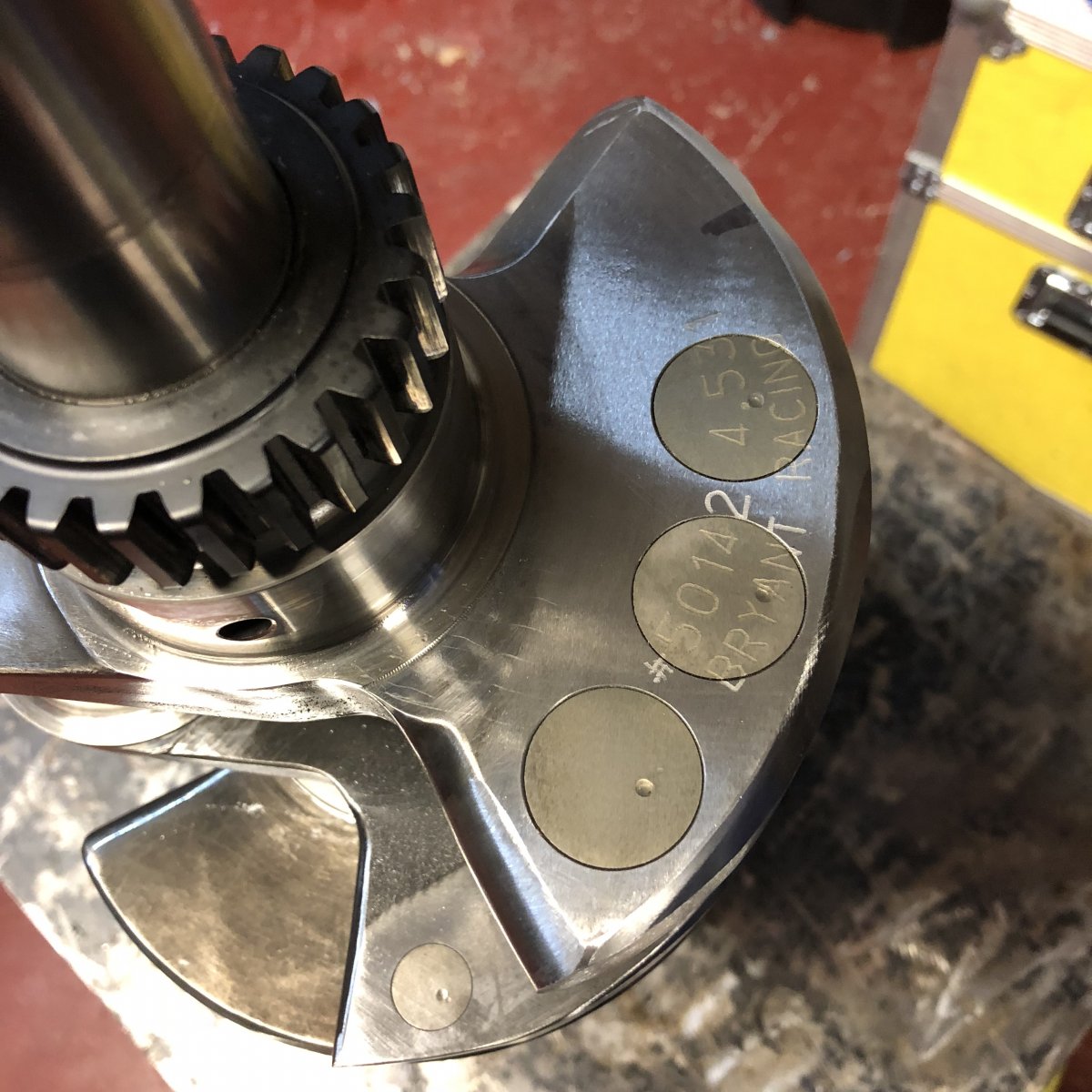

    Don't got em! Hey remember when you asked how much to balance a crank and I said depends on the amount of mallory?
    This was like $500 worth of mallory - all the counter weight are full of it
    Love this lube -
    Then the @dusterdave173 thrust bearing trick - this works! I've torn down enough of these engines now where some were modified here and some were not - it works! Just file off the edge of the bearing to allow the oil to come back to the thrust face.
