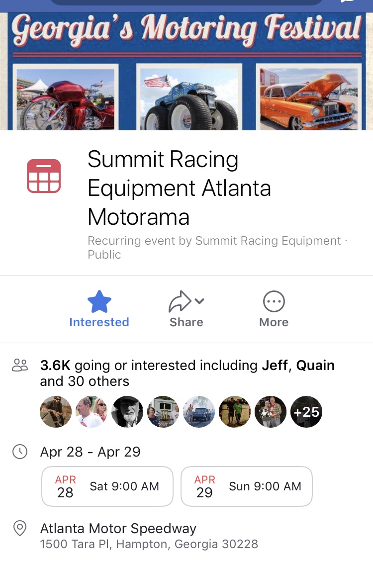

    Throwing this here so @dirty old man can see it - this weekend at AMS we'll have 12 SEG cars - no racing though :(

    Not going to be able to make it to AMS, got some major yard work going on this weekend and I need to be here.
