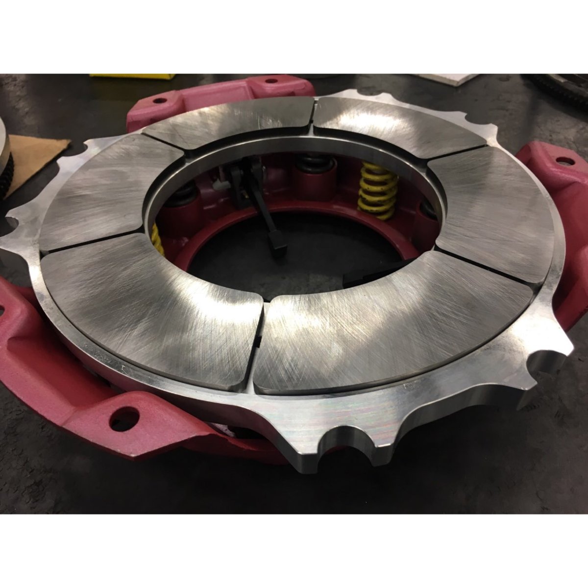

    Got the car back home and been thrashing on it. Windshield guy coming tomorrow . Joe did a killer job on the firewall and floors. Not sure what I’m going to do with all this duct tape now.
    Ram clutch sent a beefed up pressure plate that has some capture lugs on the plate

    That clutch and flywheel is beautiful! Can't wait to hear that Hemi eat again!

    Thanks - I noticed in the pics the mid plate brackets need a but more weld on the ends .....
    Yeah we'll see. Trying something different this time - the bell housing is not within the .005" spec. BUT to fix that I need to press out the dowel pins in the plate. That dowel was the first thing to come out in the explosion. So gonna leave all of it alone and see if it shifts ok.
