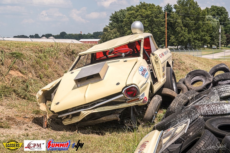

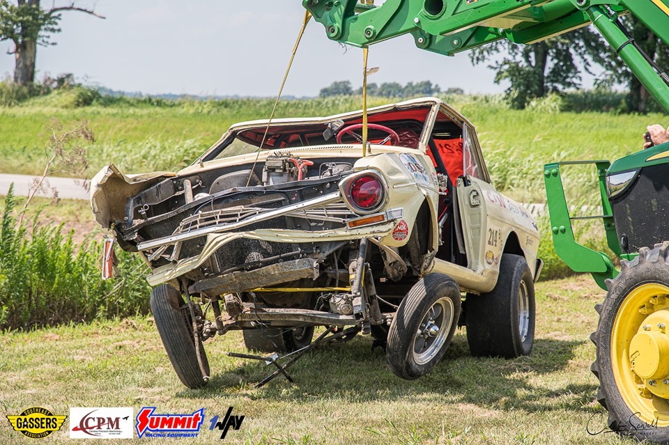

  4. Best event so far! Had one close call when a car lost it’s brakes but he’s ok.

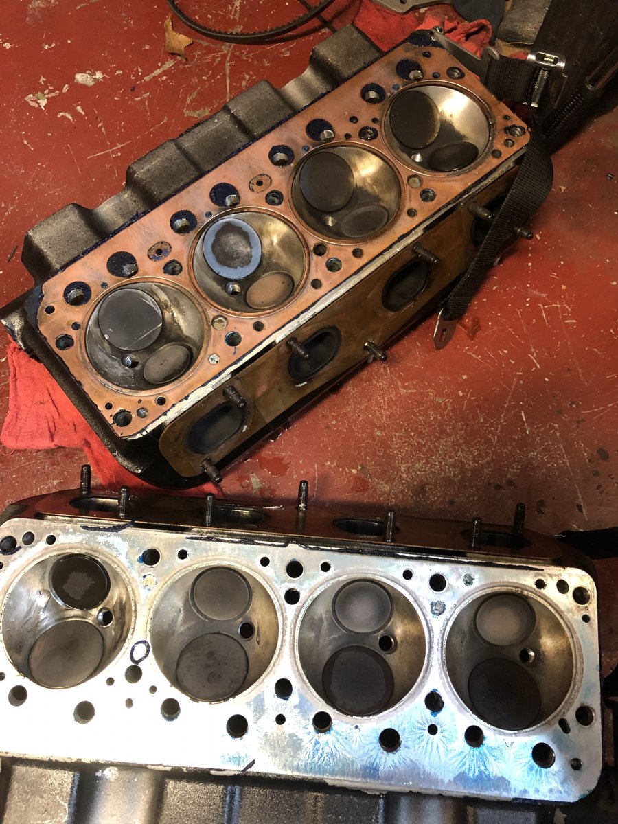

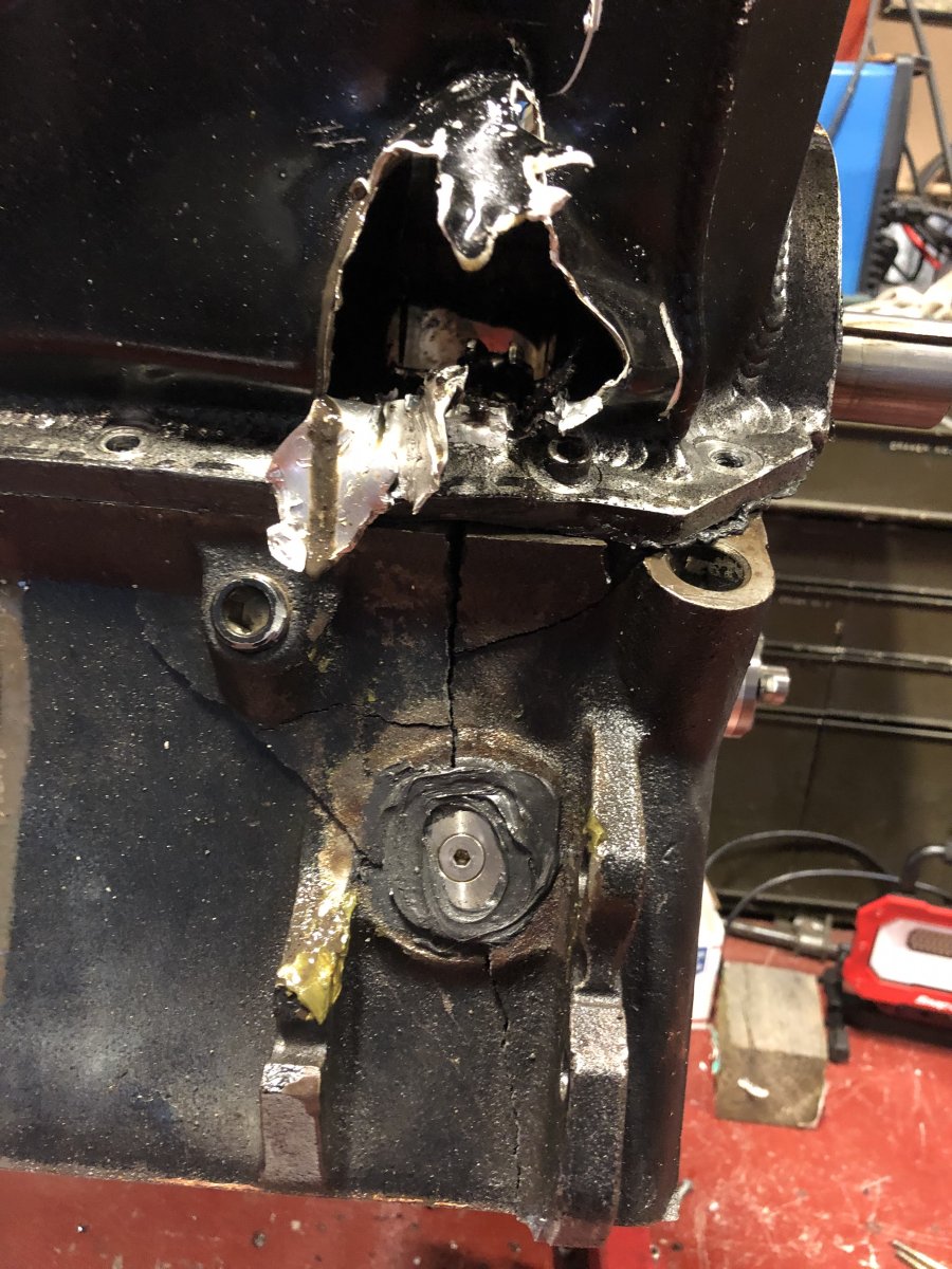

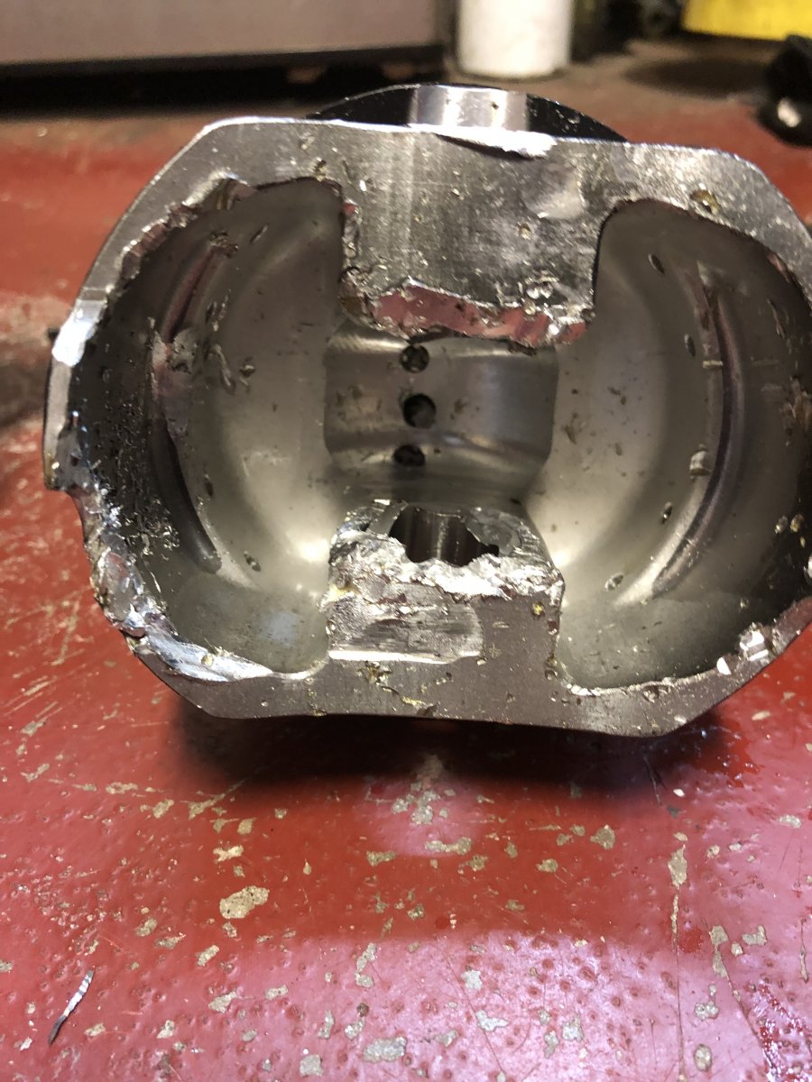

  5. 72462D4F-187A-425F-B19D-DD06D22CA93B.jpeg A13A734B-3924-43DA-84E3-946701274523.jpeg 06D82247-3EE6-4EEB-92EB-264E4986E4F1.jpeg 3E92F4A9-1858-4971-BEAF-1A0C8A6ACF6A.jpeg C40C7BA7-0881-4F80-B9D8-A325CECA0339.jpeg 8E68E733-B952-486C-B49E-01E6157B1C09.jpeg 72462D4F-187A-425F-B19D-DD06D22CA93B.jpeg F38396DB-4366-4957-83E0-62E1ED46CA59.jpeg 5FADAA9C-181B-4680-BED6-E49746E88FA0.jpeg 40ADEEF7-4B5F-4A5E-A723-9A9815FAE12F.jpeg Still can’t get the magneto to rev limit so at 9300 it all went to hell. Going to put the MSD back in for Mooresville

  9. We got a spare. I'm thinking of going B/G next year with less stroke. Not sure this long stroke is the right formula for this sport. Gonna pick up several 354's at Moorseville.

    Man alive, that's a bitch for certain. I know that hurts, but I'm glad you have a spare.
    Prolly a wise move to come down to a shorter stroke and B/G.
    I know the crank and block, etc are dead, but is that high dollar top end still repairable?
    enloe, catdad49, Dog_Patch and 3 others like this.
  12. A stock stroke 392 crank in a 354 makes 392 cubes in a smaller; lighter package. The port angles are also better. The block is also stronger on the 354 because it doesn't have the hole drilled through the webbing. .050 needs to be added to the thrust. Cut the rods and mains to stock 354 size. Or cut the rods to BBC size. I would seriously consider a aluminum rod with what you are doing.
    enloe, catdad49, Dog_Patch and 4 others like this.

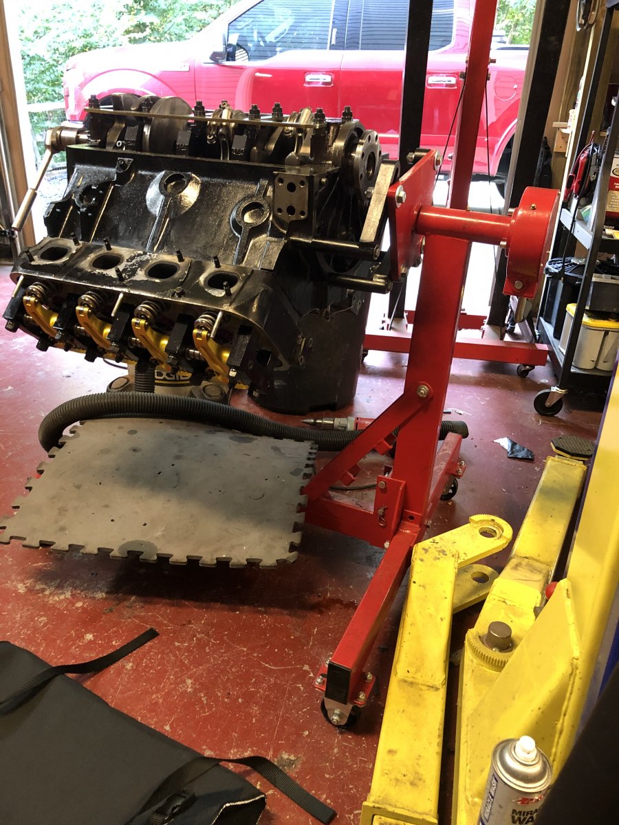

    Damn tony I feel your pain I just went through the same deal I got lucky and the block is useable but cracked the crank and broke the cam in 4 pieces and destroyed the pushrods I bought a rev limit box from auto meter to use with the mag for the new Motor did you have such device on yours
  16. Yeah that's the thing 50% chance of getting put on the trailer first round in any class so I'm thinking less blown up parts is where I'm going.
    Yeah the only damage is 2 rods 2 pistons and a block. The big money is above the block and that's all ok. The crank will polish out. I think the steel main caps will get moved to the new block. (I have a 392 block and 2 pistons sitting here - guess that pan is hosed too) - seriously after the clutch explosion this is just a bump in the road.
    Was your failure do to over rev? Man I have tried 3 completely different mag rev limiter solutions. ETC, Auto Meter Pro Control and this time get real exotic and put a crank mounted hall effect pickup going to and MSD RPM activated switch. This last solution works with a 3000 pill if you just hold it wide open it sounds like a bracket race car on the line. Bounces off the 3000 limit. But I put an 8000 pill in it and it climbs so fast its like nothing is there. I'm just gonna go back to the MSD 6AL. The mag really woke it up. Hate to go back to electronic.
  17. Yeah I need to figure my weight to cubic inch recipe. The car is still 300 (?) pounds heavy for A/G so going to B/G we can build the cubic inch to match the class exactly. I'm allowed to be 2368 but its 2700. I just wonder if a 1956 354 or 392 crank is up to the task or does it need a high dollar aftermarket crank.

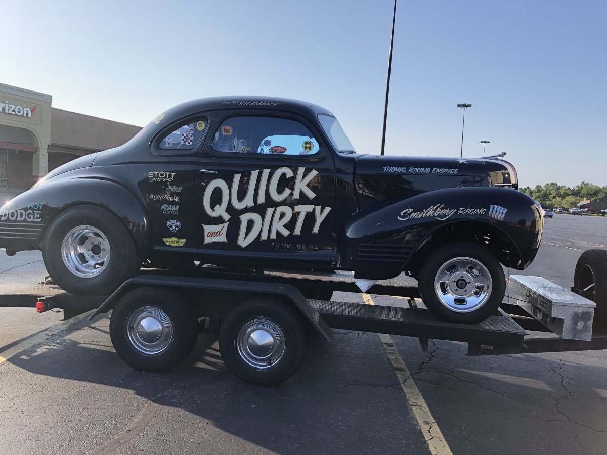

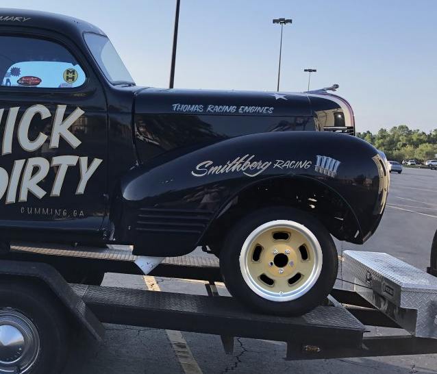

    Sorry to see the damage, but I guess it could have been worse. I can't believe what a difference the polished wheels make in the Q 'n D, ready for a Sat. Night trip to town. Love your shop dog, Carp.

    So do you like the shiny wheels? I'm not convinced it the right look.

    I like shiny wheels, but with your car I think it might be toward the bottom of the to-do list. I could change my mind if I see it in person, pictures do not do it justice!

    somewhere between polished and dark, the shading is a little off but maybe gives an idea

    There's enough gold tone accents on it to make it work in my opinion.
