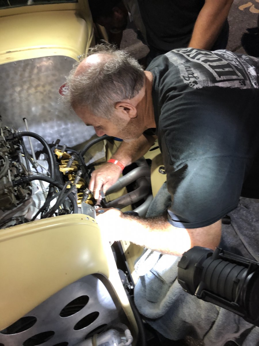

    Here's something I found on Wednesday before the race. This season has killed 4 sets of rod bearings and one engine block. At first I thought the magneto was doing it at 9500 rpm (still not a good thing to zing that high), but finally got to the root cause.
    At Moorseville the engine never went over 7500 rpm. Everything seemed fine. Wednesday went to crank up the engine and it was slow to crank. You got to be kidding me! So I opened the oil drain plug and out came 1 gallong of gas mixed with oil. The consistency of pure water. I pull the pan and a few rod bearings and they were wiped again.
    Ok found the source of the rod bearing failures- now how does 1 gallon of gas get to the crank case ? It would hydraulic if it was dumped in the cylinders. The only other place is the fuel pump inside the timing cover. Either the fuel shutoff is leaking - which would be weird because for 2 seasons we never even had a fuel shutoff and it wasn't a problem or the pump seal is blown and under running pressure its dumping gas into the crank case.
    This fits with the weird oil pressure gauge swinging all the time. (Well it would swing until it spit the rods out. )
    So Thursday I changed all the rod bearings and put it back together. Put in a different fuel pump. Raced all weekend - no gas in the oil! Just when I thought everything that could go wrong on a race car already happened ......
