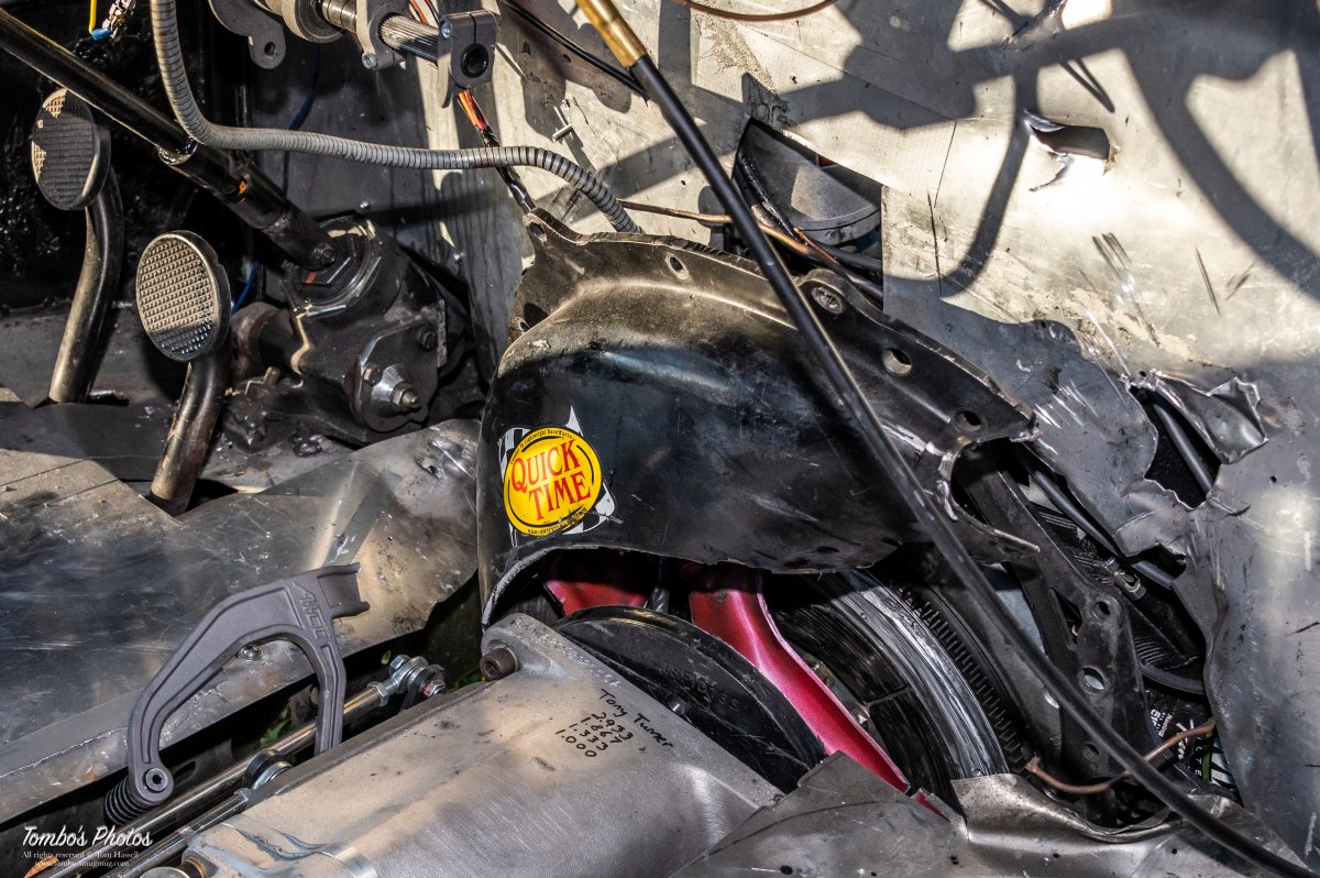

    I know this has been beat to death, so I aplogize in advance for posting another photo of "the incident at Shadyside" but I was reviewing some old photos I took of the Quick & Dirty Dodge and found an inside the car view of Tony's unfortunate clutch explosion. Thought some of you might like to see what the business end of such an explosion looks like. Tony is extremely lucky...carry on. Quick Time Bellhousing.jpg
    Dog_Patch and loudbang like this.
  4. Dog_Patch
    Joined: Nov 12, 2007
    Posts: 5,133
    Dog_Patch
    Yeah the disc on the dash photo is making the rounds again. :D All the same stupid experts too,
    1. The pressure plate exploded.
    2. A chunk of the pressure plate stayed attached to the hat.
    3. The chunk spun around inside the bell housing at 8000RPM
    4. The chunk beat the starter pocket that most Quick Times have
    5. After enough hits, the dowel pin for the block came out
    6. Then the **** hit the fan.
    There weren't any rubber bolts used - contrary to the interwebs story.
    I highly recommend a Lakewood housing. Saving 20lbs on a welded bell housing is not the way to go.

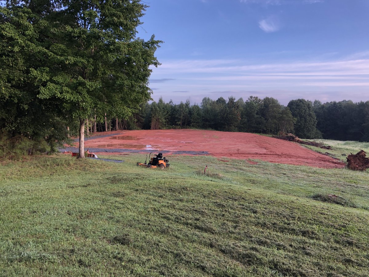

    not a shop yet but
    E407E5A7-8116-4907-AA65-8366A2AC314C.jpeg Going right there

    Now that Denny mentions it, what is the shop footprint gonna be?
    chryslerfan55, Dog_Patch and loudbang like this.
  30. jim snow
    Joined: Feb 16, 2007
    Posts: 1,933
    jim snow
    Georgia or North Carolina? Anyway it looks like all the hard work is done.lol. Snowman
