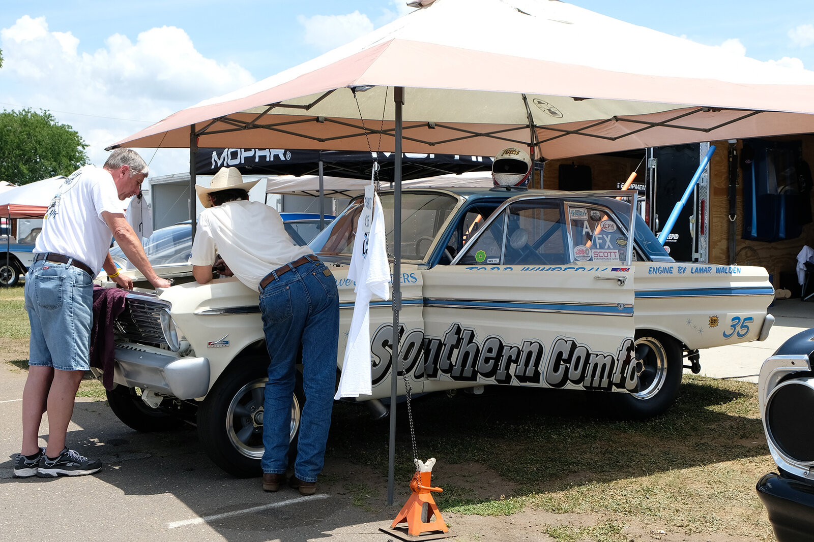

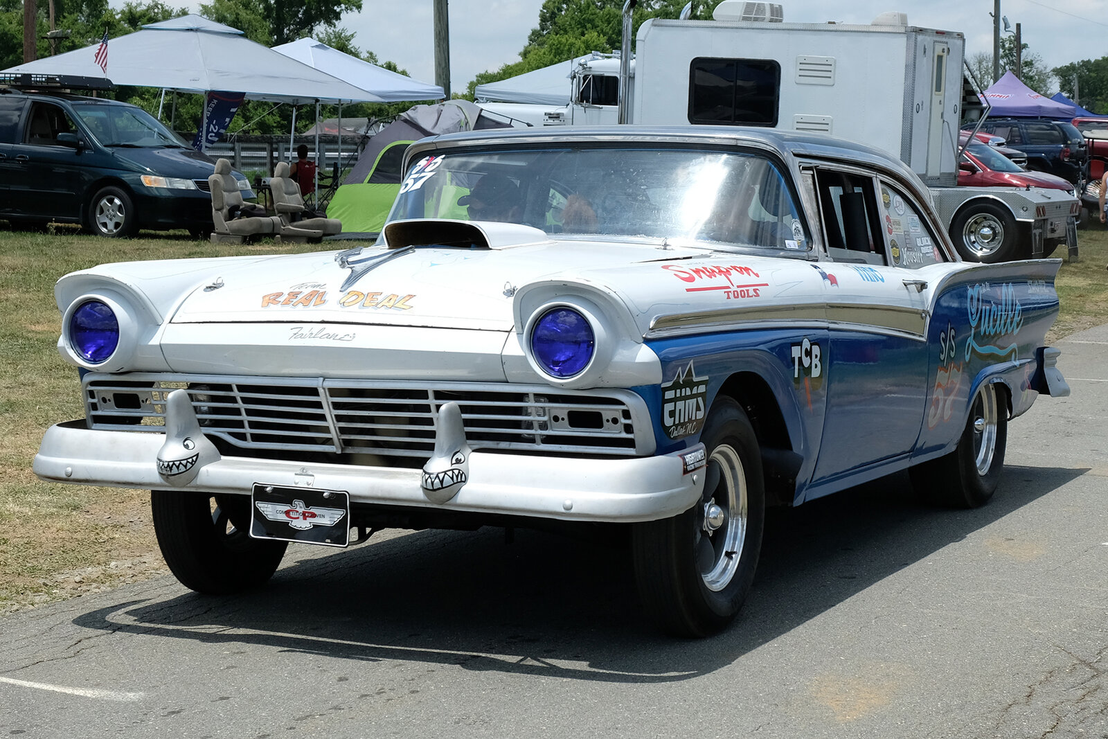

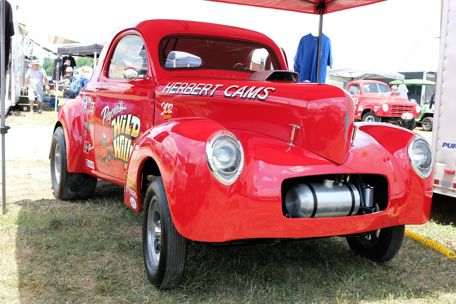

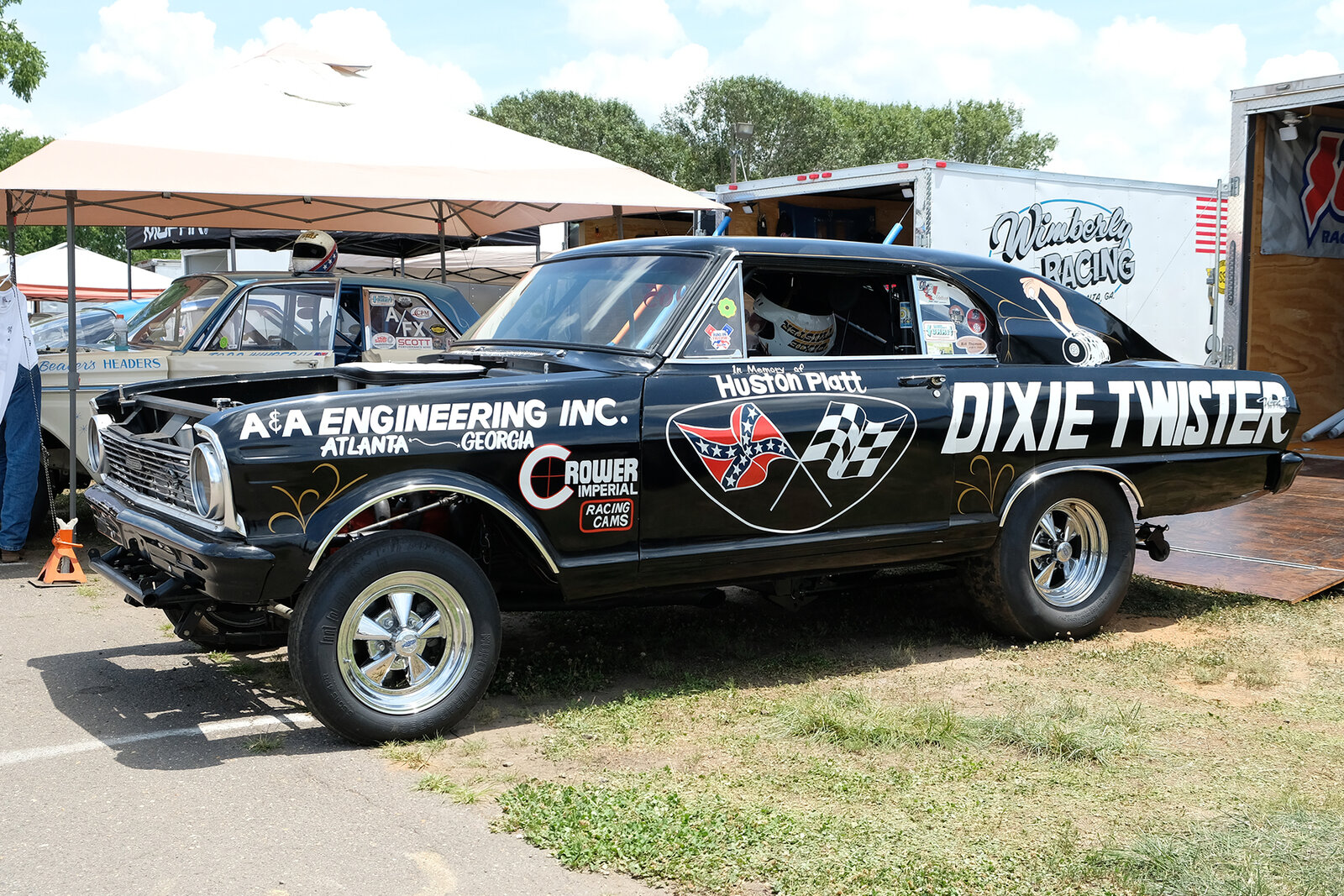

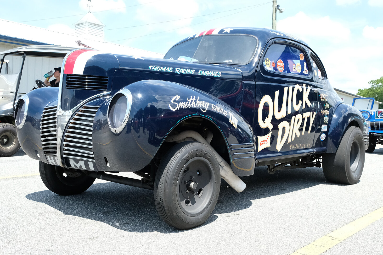

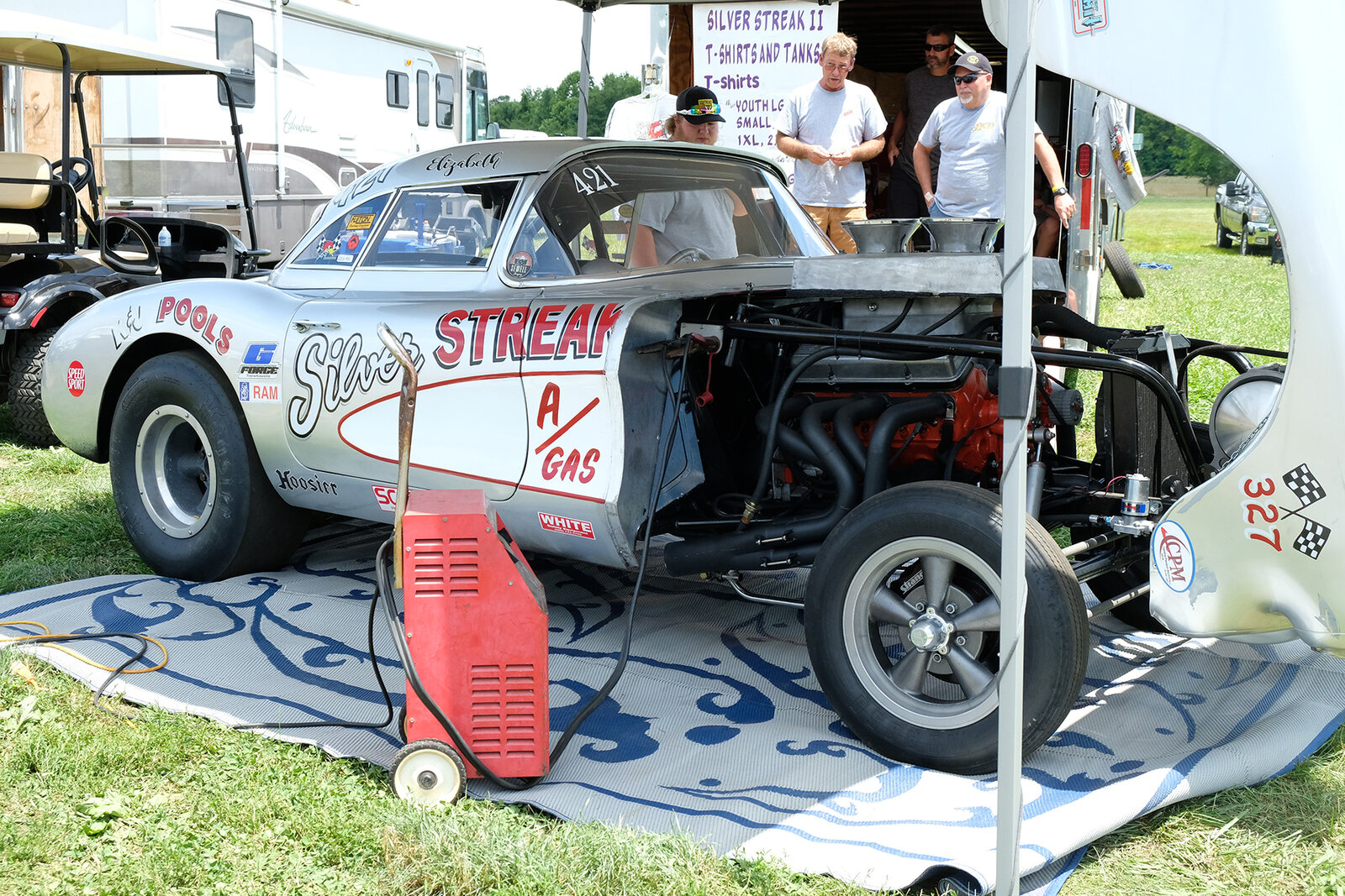

  1. Back from Farmington NC. Good times even though it was hot hot hot. Found some issues on the car and fixed them. Who knew 4 chickens and 3 dogs could stink up a camper?

    NICE!! Tell your buddy he takes some great shots. :)

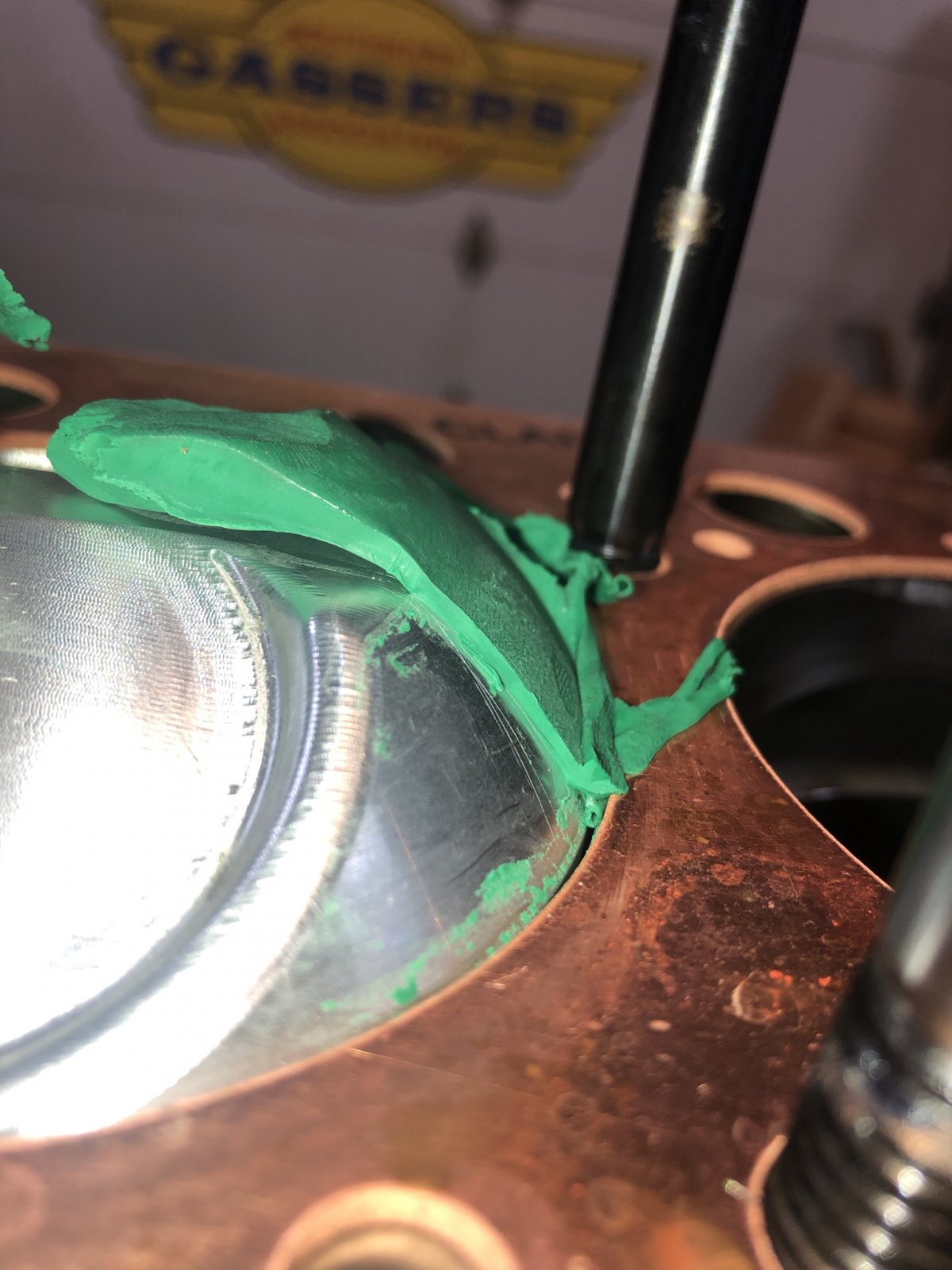

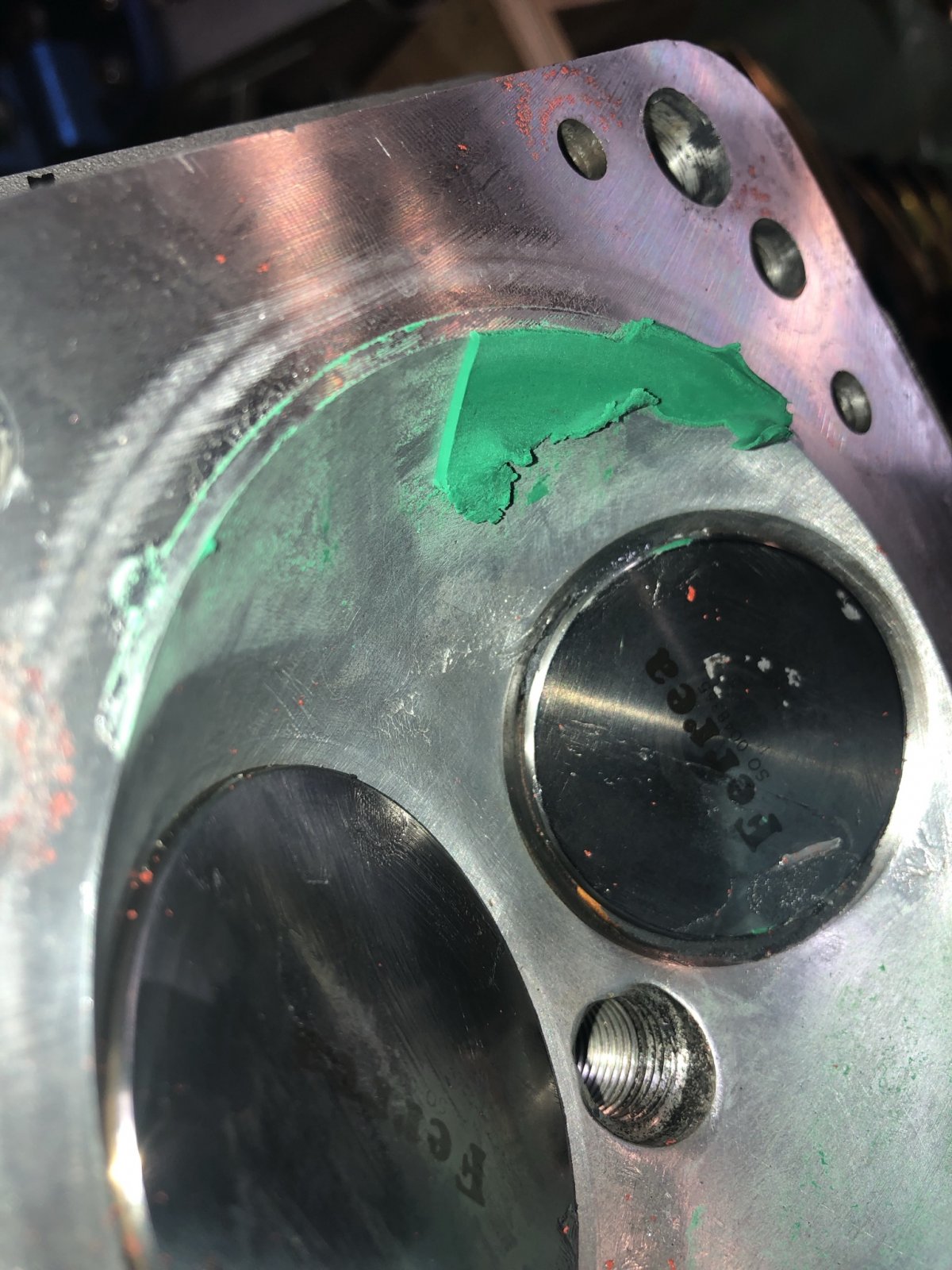

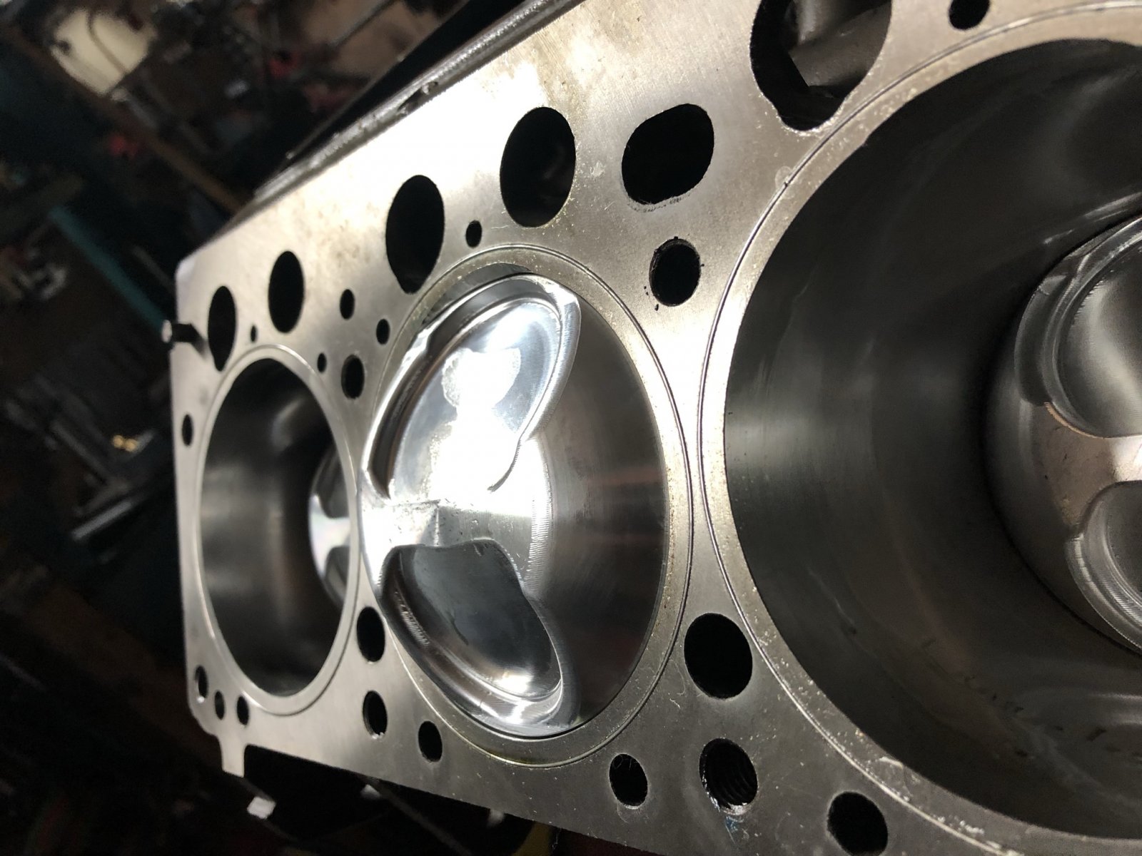

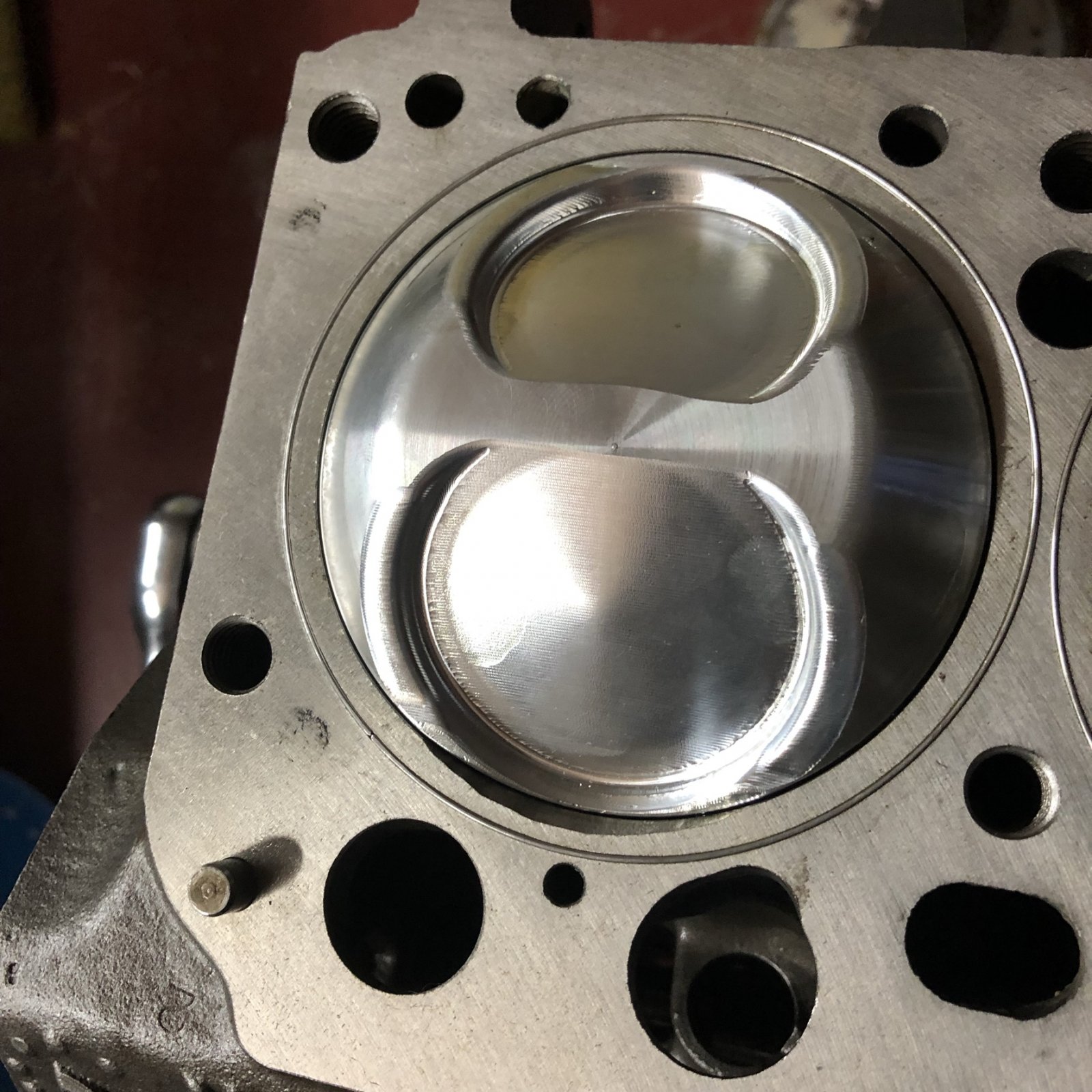

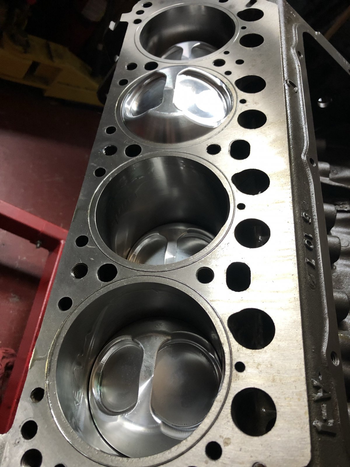

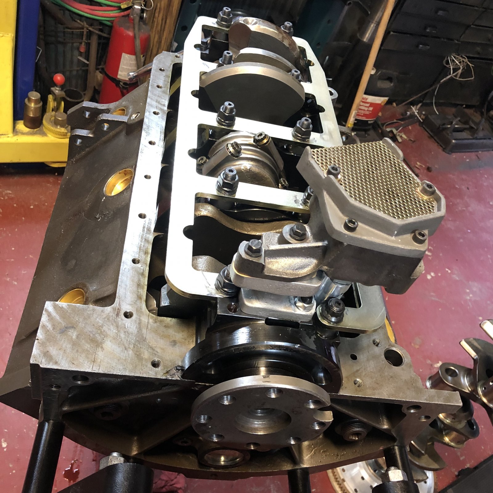

  12. DA28B483-3401-45E5-B978-059ADD8A9A66.jpeg 1086E344-7CE9-48D3-9605-DA442AE579D1.jpeg 53C7288F-BAD7-4B46-8D28-B999F31BA667.jpeg B55DF9EE-40CC-4E9E-8F9D-FE137F9560E3.jpeg CE125086-2C4D-4E95-9967-E129E430F7A5.jpeg 044DF892-4411-4D0C-A4BD-9F4F674F1C7C.jpeg 582A76C0-965E-4621-AA48-052DBE764F34.jpeg Working on the B/G engine. The piston to valve clearance looks ok but the piston to head dome is woooo. The .062 gasket is damn tight at about .025 . Not sure how close is too close. The second clay measurement is with the .082 head gasket. It looks better so I’ll probably go with that thicker gasket. Gonna need longer pushrods.

    Piston to head around .035 is what I shoot for.
    rod1, Dog_Patch and loudbang like this.
  14. This is the tightest I've ever had them get to the dome. This is just a straight up 392 engine so the dome is attempting to get to 15:1 - which wasn't as much dome on the 5/8" stroker.
    I talked to Rob Waldon and he said to take out the gasket and see if it hits or won't rotate, that's one more data point I'll try tonight.

  19. The CC check shows 14.6:1 compression so gonna go with the 0.082 gasket. E1A68024-D318-4D66-AA16-C43B8C985EBA.jpeg 2966FD49-72F4-422C-9937-BD8C5331381C.jpeg 17BCF5C3-6CF5-4926-B7FD-CCAB01E0E439.jpeg B19E439C-CA96-4AD0-9DEA-8F2060C3A165.jpeg

    Where does the quench effect come into play in a hemi engine?
  22. The intakes are 2.20" . If you set a head down on a flat surface, the head doesn't lay flat because of the valve overhang,
    I have no idea o_O maybe @402BOSSMAN can answer that.
