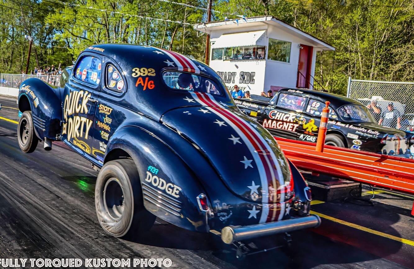

    I think the wheelie bars are still too low. It didn't feel like it pulled the wheels at all.

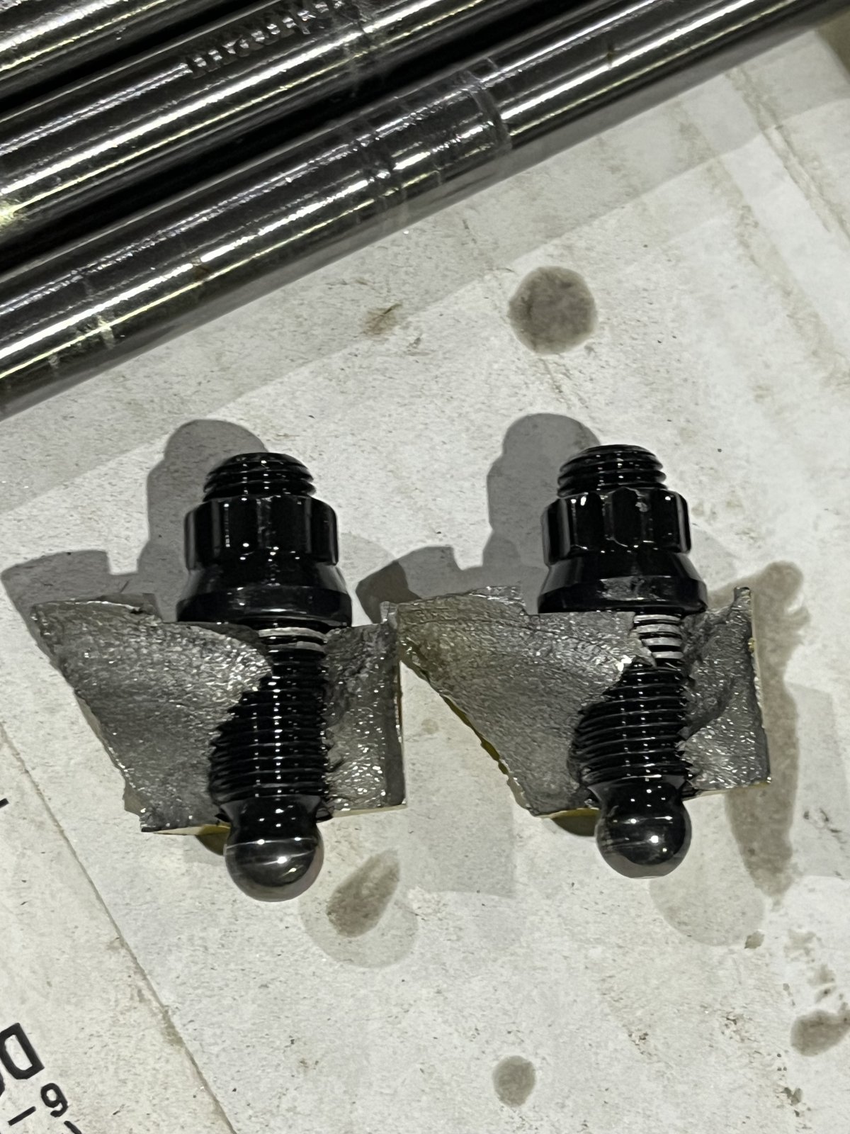

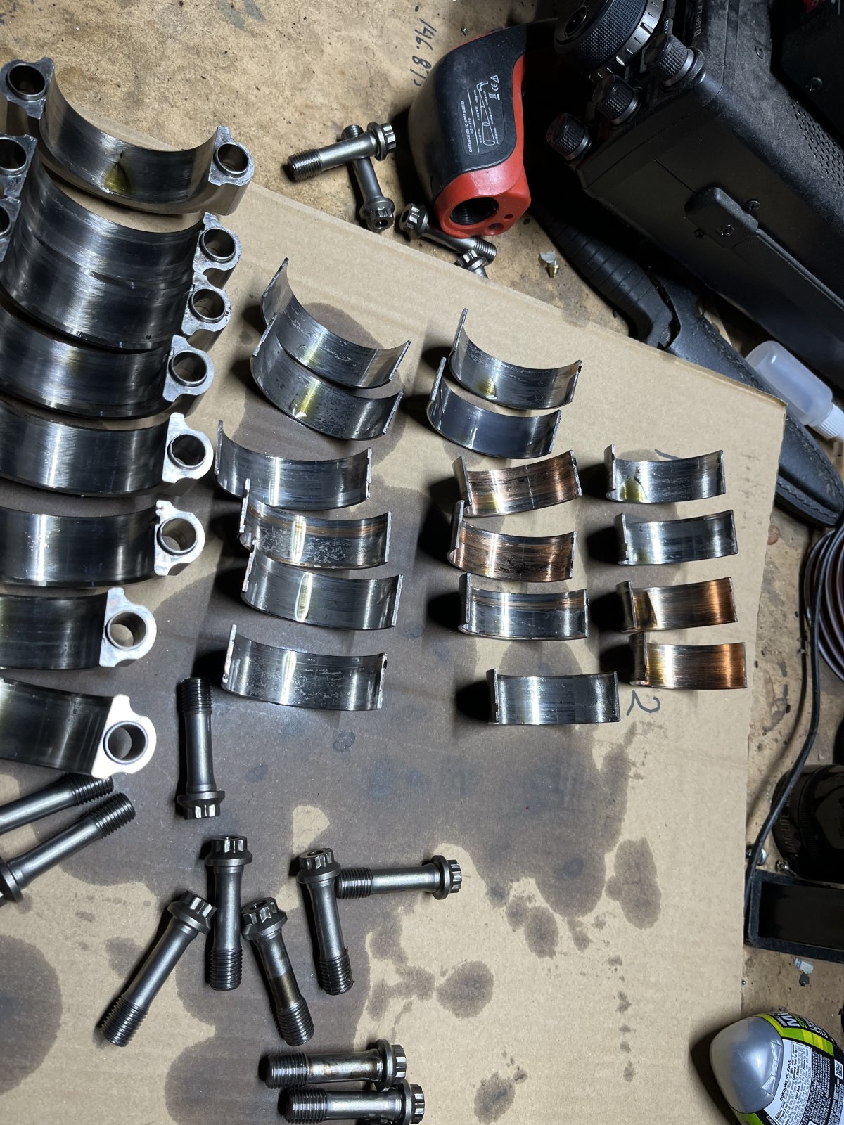

    I had an issue at the November finals where the fuel pump over ran the floats and hydraulic-ed the engine. Broke 2 rocker arms so by Ringold the new rockers were still not here. We made it to Shadyside and Knoxville. Planning to go to Mooresville next, then Knoxville again.

    Glad to see u back. G***er first connected me to southeast g***ers lov em. Surprised hydraulic motor broke rocker arms, usually bends rods. I am sure u checked everything else

    Yeah there was a bunch of stuff that needed attention. I ended up putting in a new set of Molnar rods and getting the crank turned. @402BOSSMAN went through the heads because one seat was sinking. Too many 9000+ rpm excursions and the bearings were wasted - it was probably 1 or 2 p***es from kicking a rod out. This season the rev limiter is on 8000 and staying there.
    The fuel problem was my fault. I never ran carbs before so I had the fuel pump on its own switch and I left it on in the pits. I thought the starter had stuck and kept trying to crank it over. I'm thinking it was pushing against liquid and finally broke something. The push rods are like telephone poles so they weren't bending.

    Understand, cylinder full tried to start valves tried to open, snap. Now that makes sense. Tks, love your g***er. Due to you try to follow SWG***ers
