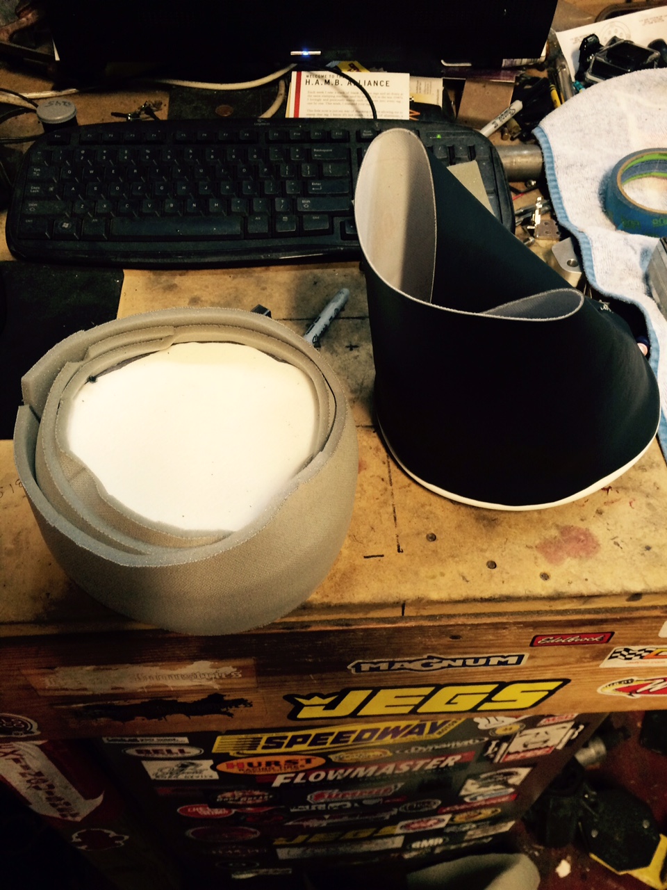

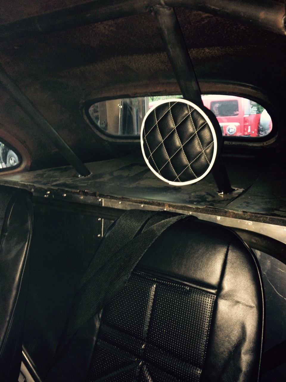

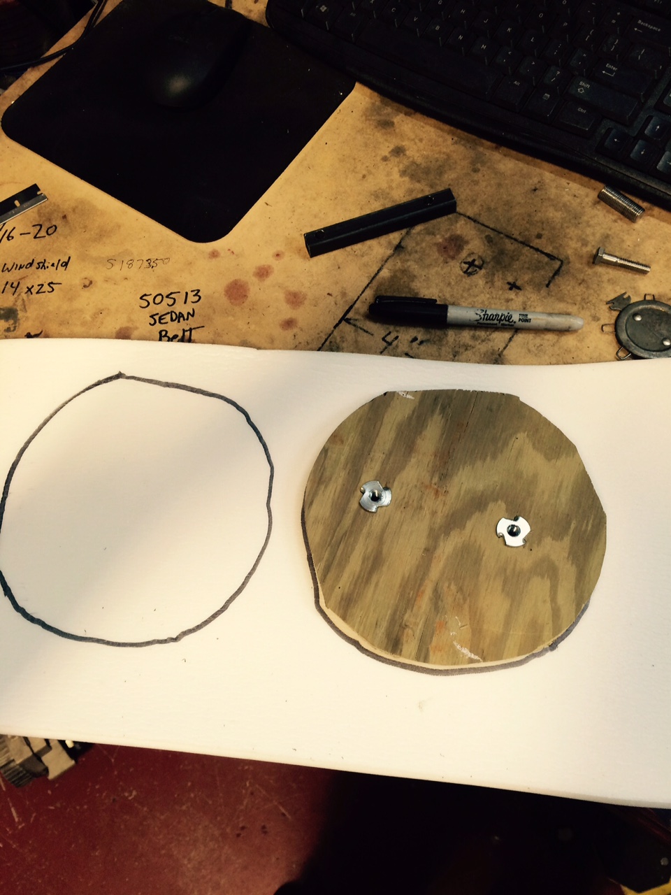

    Cabbage came over and helped work on the headrest. 3dnsouth does nice work :cool:
    headrest1.jpg headrest4.jpg headrest5.jpg headrest3.jpg headr3r.jpg headr.jpg

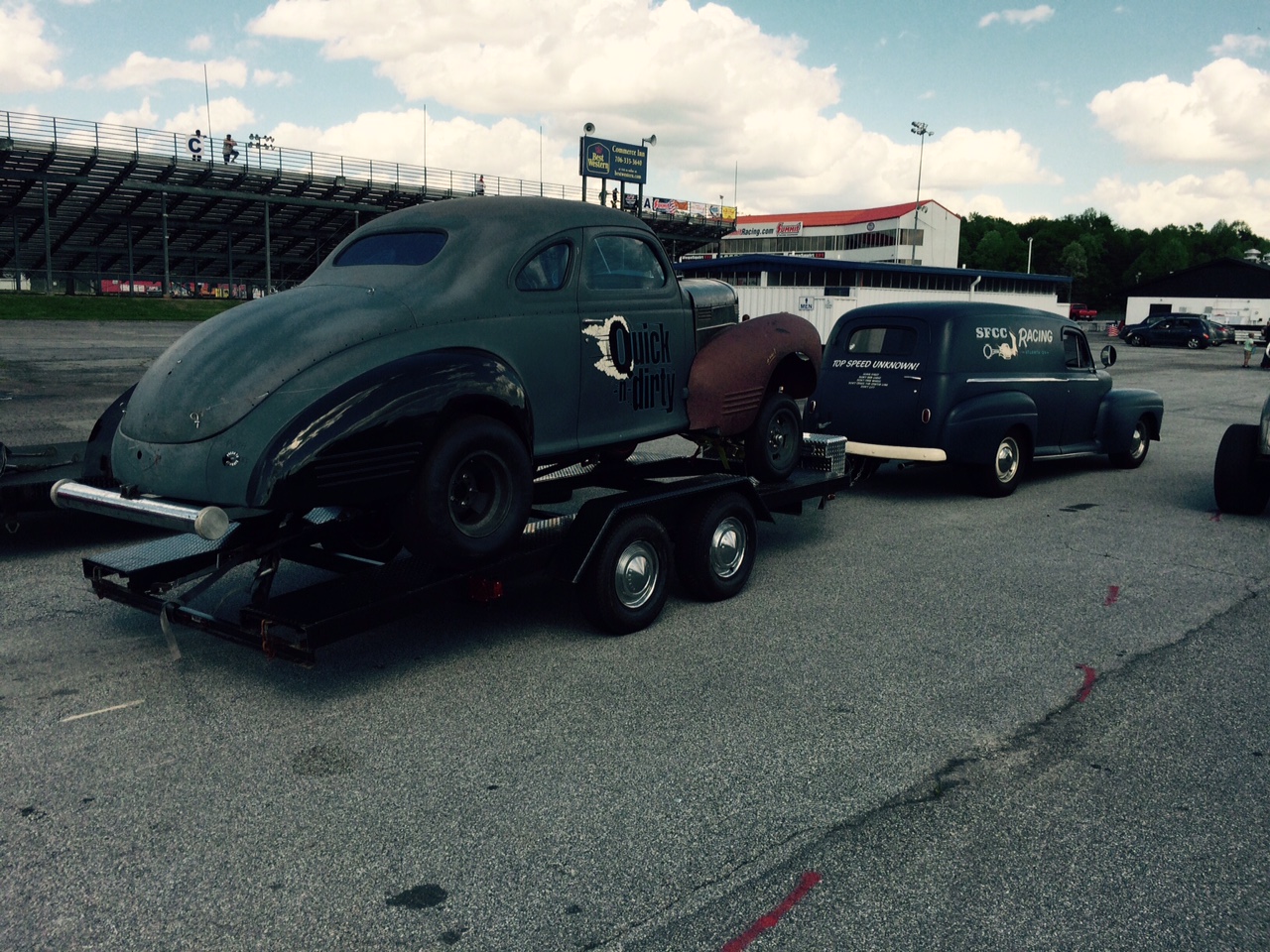

  5. Then Tyler came over Saturday night and disassembled the entire fuel injection and cleaned it while I worked on the throw out bearing. By 11pm it was running sweet and the neighbors were impressed :D Got up at 6am and made a trans tunnel - or something like a trans tunnel, then loaded out to Gear Jam. That took longer than expected and I got there about 1pm.
    lawman, GAOldsman and 3dnsouth like this.

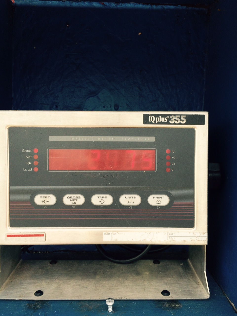

  6. After fiddling with the injection for an hour and calling Quain and wasting 30 minutes of his valuable time on the phone :eek: - sorry about that. Brad tied a rope on the front axle and towed me to the scales. The handling was very stable at speed. The brakes work - I guess - because when I jabbed them Brad flipped over the bars of the 3 wheeler :cool:
    We got to the scales and she weighs 2575lbs with the 75lb nostalgia bumper :D

    Is that weight with or without the driver. If that's with a driver it's lighter than I thought it would be,
    GAOldsman likes this.
  9. That is without the driver. It was 2745 with me in the seat - which is really funny because at Ware Shoals I was pulling numbers out of my ass about how much it would weigh and 2800 was the number that came out o_O

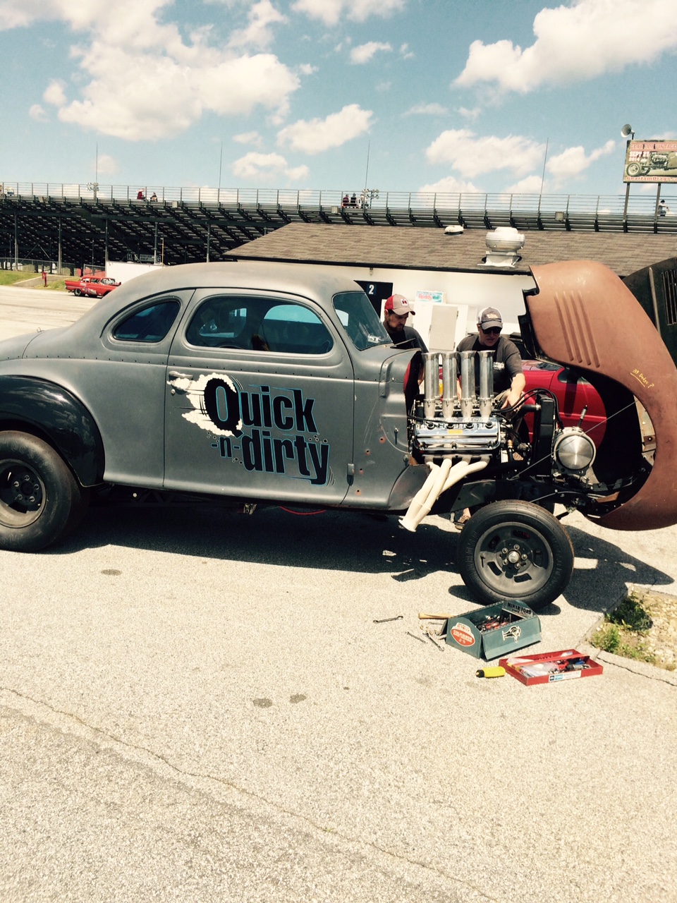

  17. Tick Tock Tick Tock ... Greer this Saturday. No time to mess around. Cabbage is working on the A/G and 392 lettering while I made wheelie bars.
  18. Yesterday was Thursday and Quain offered to go through the injection. Its almost a 3 hour drive but when you get offered help from the best tuner out there, you load out at 4am and don't stop for breakfast ;). Got there at about 7:40 and Quain was looking like I got him up early but it was the start to a good day so he muscled through with coffe and chewing tobacco :rolleyes:
    We unloaded the Quick n Dirty Dodge and started pulling apart the Enderle barrel valve.
    It turns out what me and Tyler thought was a high speed bypass was an idle bypass. But it was set up with a 30lb spring! Quain swapped shims and springs until it was 8 or 10lbs. Then the main bypass was actually 1 lb! He made that one 10lbs I think. Its crisp and snappy now.
    Man I got schooled on barrel valves and injection :cool: really good stuff. Complete with drawings. Its actually a good thing Quain had not seen one of these before because that made him pull it apart and teach me what was going on inside. After that we set the air gap on the clutch and Quain tech'd the car and pointed out some stuff to fix before tomorrow's Greer race. Loaded back up and headed back home about 11:00 because I was working and didn't have the day off.
