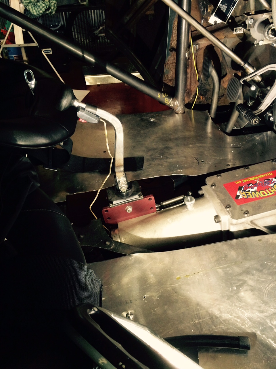

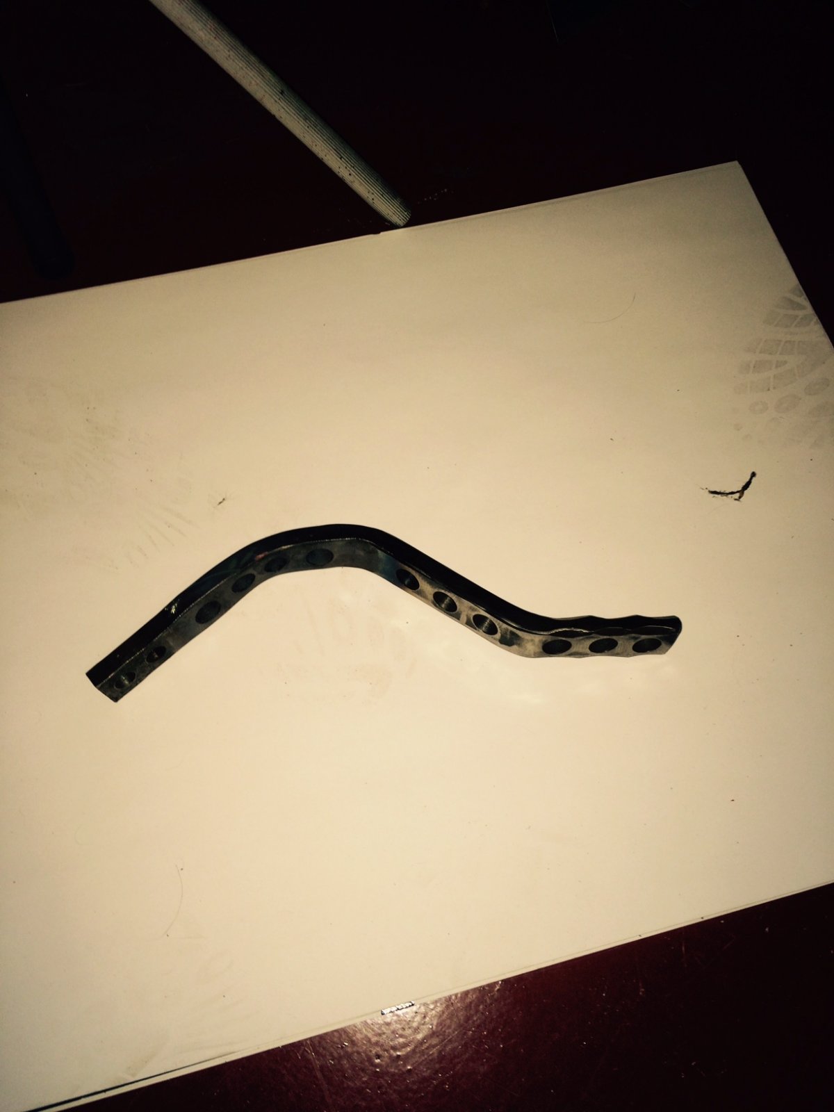

    Back on the car, the shift lever needed some bending. Blacksmith Tom says heat it cherry red and make what you want, o_O yeah right- maybe pizza or pretzel was what I wanted .....
    That went all wrong - then I found a shifter in my parts pile that was muiy - bueno -
    Added the line lock ****on and done. :)

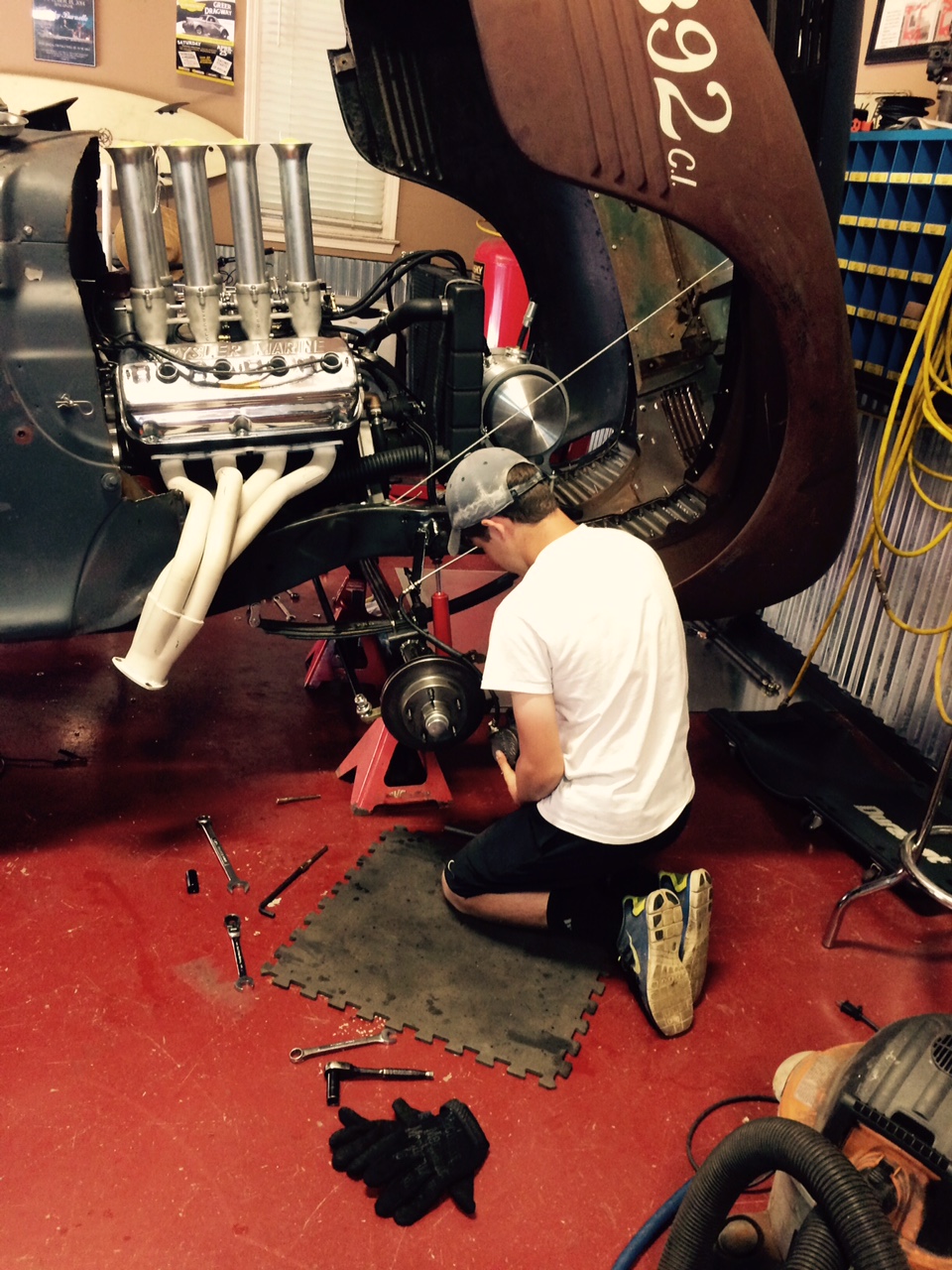

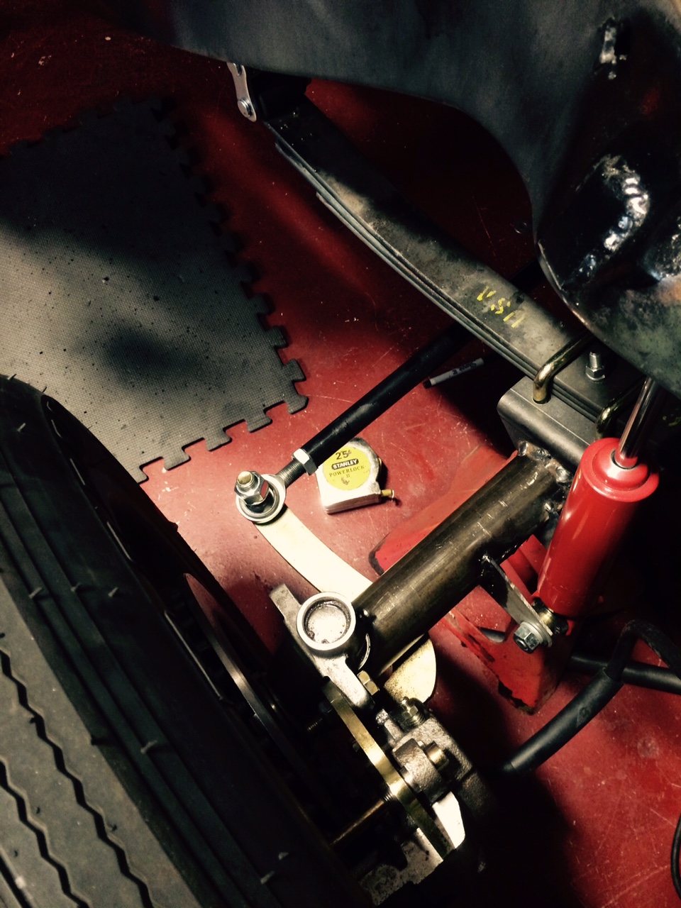

    Then the neighborhood kid came over and asked what was going on - "Have you heard of Ackermann? "
    http://en.wikipedia.org/wiki/Ackermann_steering_geometry
    He quickly Googled it on his phone - and said oh sure that's old news.
    Right - here's a wrench
    We flipped the steering links to the back of the spindle and moved the disc calipers to the front. The Ackermann was right on the string we ran to the rear end. No bending needed.

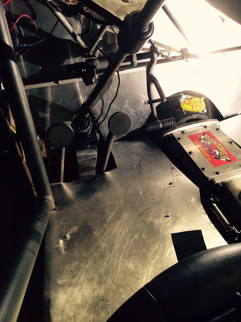

    Next we got rid of the boat pedal and put in a roundy round pedal -

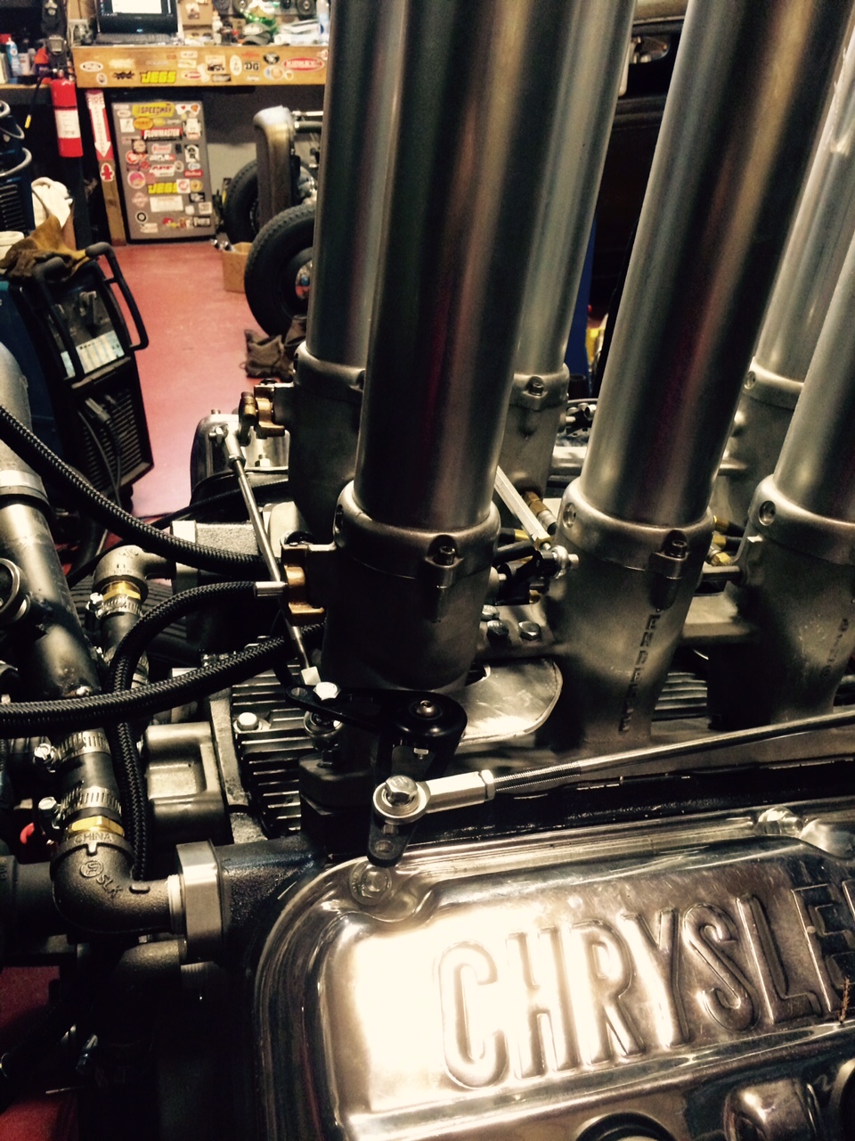

    Added some solid links for the linkage. This should work better than what was there.
