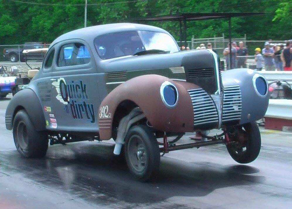

    From the pictures I took (can't post the full photos right now because I was shooting for a magazine coverage) I noticed the tire wadding up quite a bit, but unloading after the initial shock and then wadding up even more. The front tires are in the air for each photo in the sequence (aside from the first photo, which is a static shot). [​IMG]

    Holy :eek: Tommy not sure I wanted to know that's what they are doing. Good camera work there. Tommy Lumley has been telling me about the tire driving over itself. Where did I put those rim screws :rolleyes:

    Awesome tire shots there Tommy! Great info.

    That's some fantastic shots of the tire wrinkle, you're getting some real bite! I can understand your reluctance to drill those rare wheels, but that looks kinda scary to me!

    The tyre is gripping the road while the axle is over torquing the tyres causing the tyre wall to distort out of shape.
    Increasing tyre pressure would allow the tyre to spin generating heat and increasing grip this in turn will reduce axle loading
    And allow the engine rpm to move more rapidly into the power band and put the power were it needs to on the road
    I know nothing about drag strip tyre pressure so look forward to being educated in this area!

    Those pics look pretty normal to me as far as the way slicks react. I don't think they'd look any different if the wheels were drilled. If it's unloading and losing grip after the launch it may be just a shock adjustment that's needed.

    Yeah, I would have to agree. Drilling the wheels (if anything) is going to make the slicks wrinkle more because there won't be any chance of the tire slipping on the wheel. I don't mean to be a back seat crew chief, but I think I'd try a little more air pressure to keep the slick from wadding so badly. Only problem then, is with more air pressure, it may cause it to spin the tires when/if the rear suspension unloads. Then it would be time to play with the shock settings or do some tweaking on the ladder bars.

    I just wonder what they would look like at a higher RPM launch.

    Ok no drilling. Lot of trouble anyway. I spoke to Quain and he said more air will make this worse. Main problem is I'm not dumping the clutch and stomping the gas. He says a little tire spin is ok and will help with this, but you gotta drop the hammer. Need to get Tyler to check on the secret parking lot and go do some practicing :rolleyes:
    The 75 lbs of steel bumper is not helping either. So today the plan is to go to Shawn's to use his aluminum spool gun and copy the bumper in aluminum. Its going to weigh 7 pounds :) and will look almost identical.
