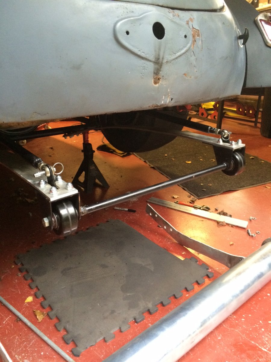

    Re-did the wheelie bar wheels. The other set was binding in the brackets.

    Nice wheelie bar wheels. Do the wheels seem like they are holding up good?

    Yeah those are the McMaster Carr wheels you told me about. These haven't been to the track yet, but they are better than the little plastic ones that were on there before. Plan on a stress test on Saturday :)
