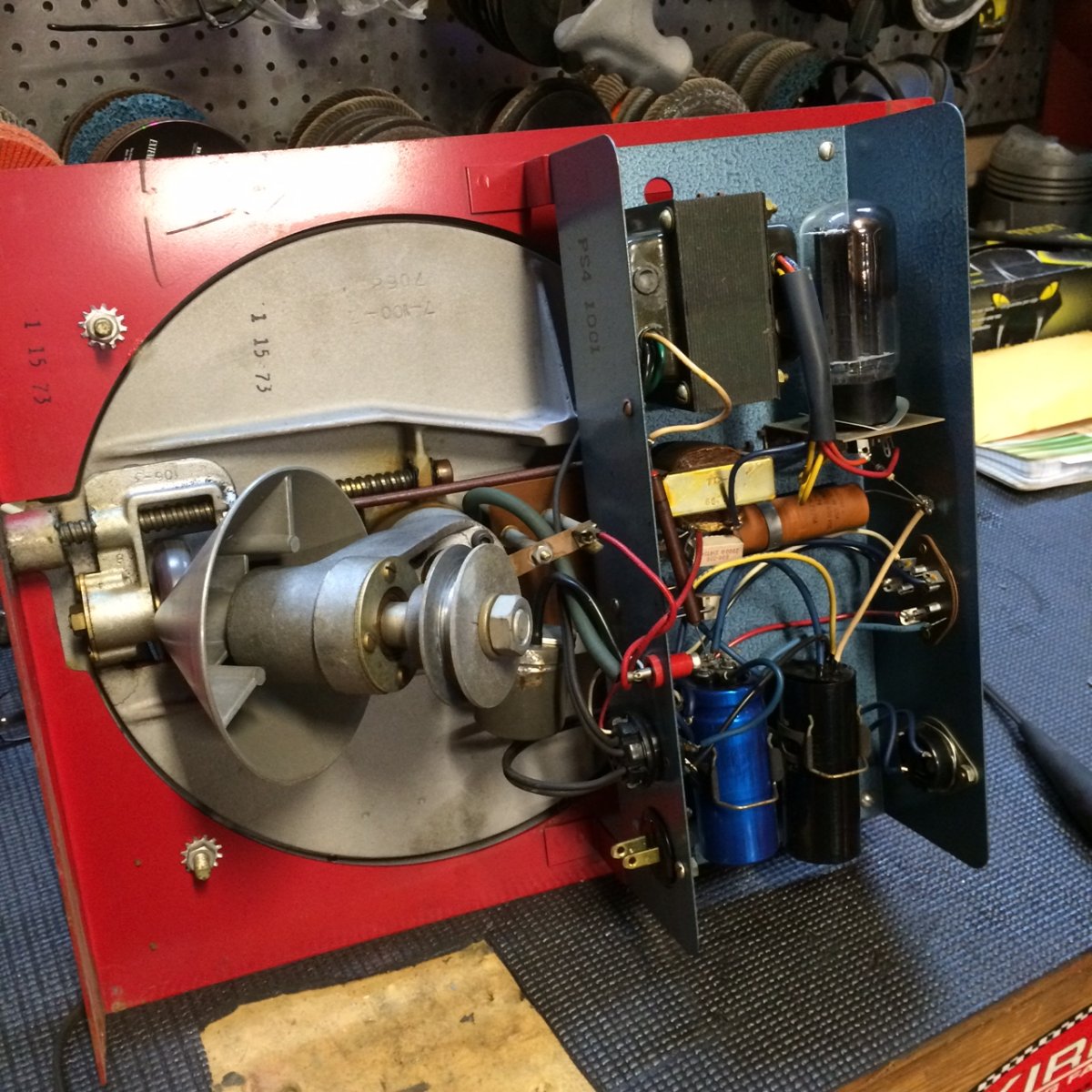

  15. Damn cold here today. Nothing better to do than work on the Sun 404.
    There is a place that sells the capacitors and diodes to update power supply in this thing. It was acting flakey so time to fix it. The old vacuum tube is replaced by 2 solid state diodes.
    Old caps dry out in 40 year old electronics. Those got replaced.

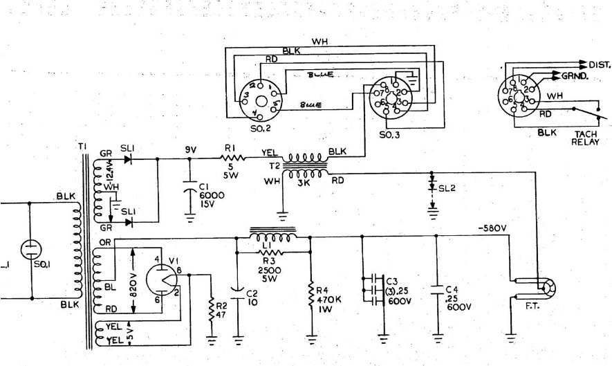

    Then after studying the schematic - the distributor pickup clamp is not going to like getting a 20amp magneto pulse :eek: which I tried but the lights were all over the place. From some past magneto experiments, I had this Joe Hunt magneto converter module. That works much better!

    Tony, is that tester set up to also test both point and electronic distributors as well as magnetos?
  20. Its got advance coming in above 1K RPM. I think it was spinning the wrong direction in that video. LOL I messed with it some more and the advance works when the mag goes in the right direction. Apparently you can spin a mag either way but the advance only works in one direction ;)
    Its really made for points. The electronic and Magnetos need some signal boost or filter to get the flash tube to fire and produce the arrows properly.
    This is old school high voltage stuff - but I think what's going on is, the flash tube -580v is almost enough to make the tube turn on - then the signal from the distributor is amplified to give it the extra kick to flash the gas in the tube.
