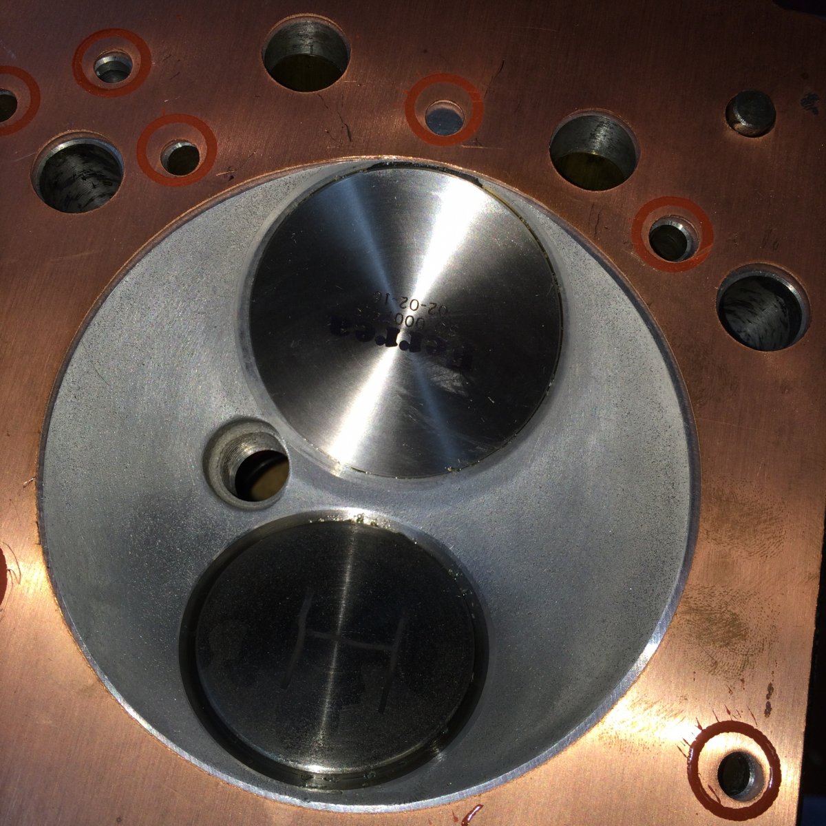

    What's the dome volume?
  3. Got to look it up on Solid Works Monday. Then we'll compute with the chamber, gasket, deck, crevice, gas port, and dome volume. It should be more like 14.5/15.0:1
    402BOSSMAN and Uncledirty616 like this.
  4. Used Vaseline around the piston and in the gas ports. It was straight up but I noticed the plug hole is not truly at the top so there could be a bubble in the top. I'm going off of memory on the 111 head volume. What will 2cc do to the number?

    I will check my notes but I believe it may be closer to 115cc on the chamber. Dome volume and how far the top ring is down is all the more info I need to check on my end. Ric has a handle on it anyhow.
  7. 2cc is about a 1/4 point of compression. Yes, that Wale will like 16:1, but my original math, with the dome available, was more like 14.5/15.0, check it out tomorrow.

    The way I was taught years ago to figger dome cc on a pop up piston:
    1- Lower piston a measured amount from TDC far enough that dome is below deck.
    2-seal with Vaseline, level deck, cover deck with plate with hole in it, and measure cc
    3- compute cc for that cyl ID with flat top piston and the amount piston is lowered form TDC as the stroke
    4-subtract the cc measurement you got with step #2 above from amount in step #3, and the product is the dome cc.
    Then the formula you have should give the cr after you factor in head gasket thickness and chamber cc.
    Hope this makes sense.
  11. 111cc Chamber + 9.2cc Gasket =120.2cc
    120.2cc - 51cc Net effective dome (after accounting for valve pockets, top land crevice volume, & gas port volume)= 69.2cc compressed volume
    Swept Cyl. volume is 956.5 cc + 69.2cc = 1025.7 divided by 69.2cc = 14.82:1 Compression
    Tony, if you bought your CC Buret, the same place as your first (off shore) third member, there is the problem. I have seen Burets off by 5 cc's in the past, that would account for just about one point (more in your case) of compression ratio.

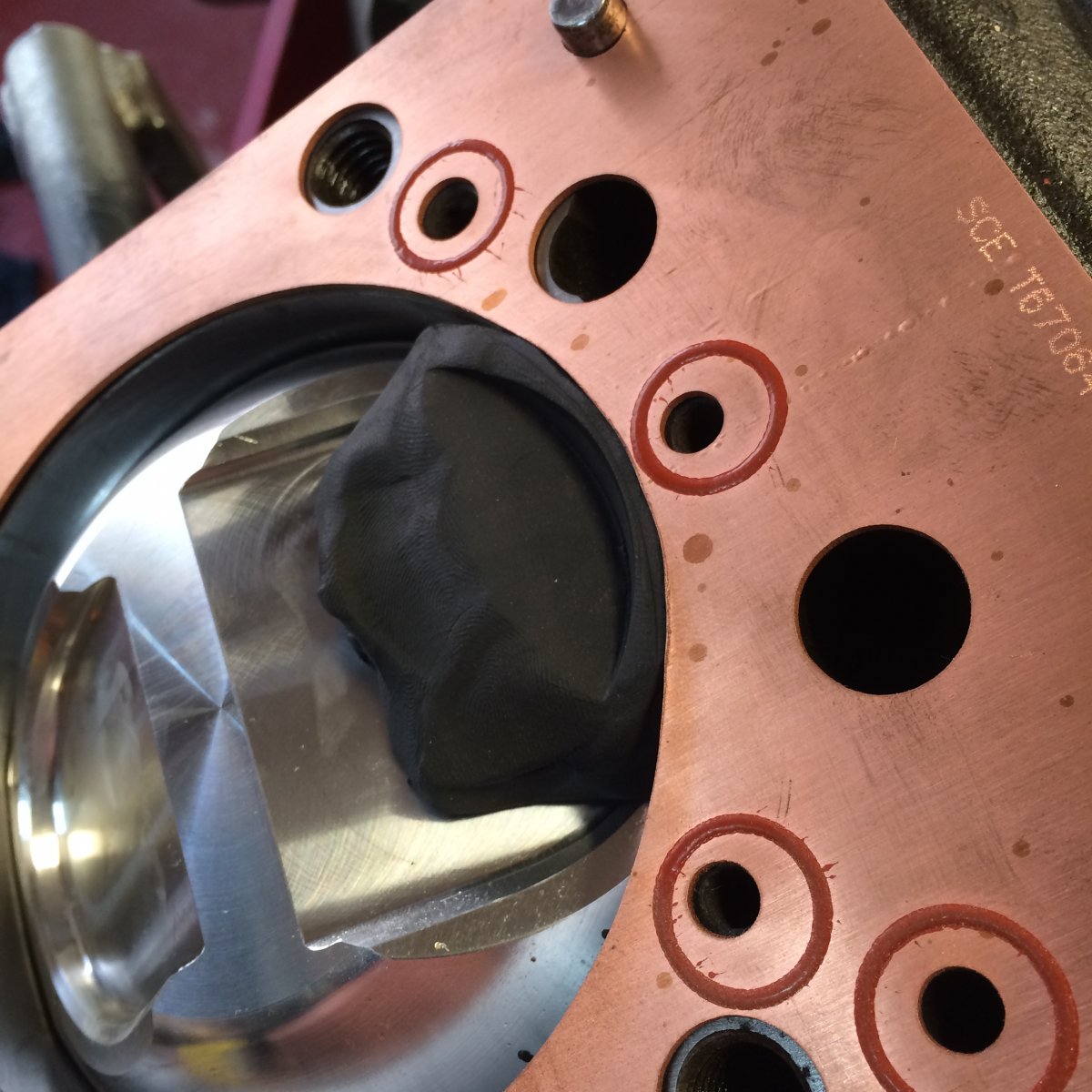

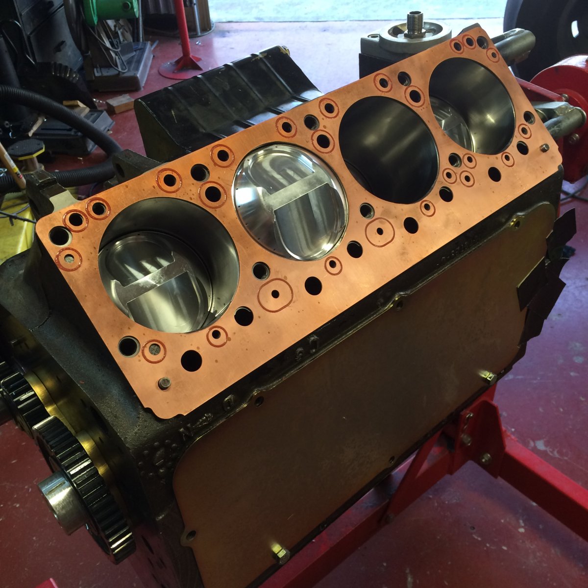

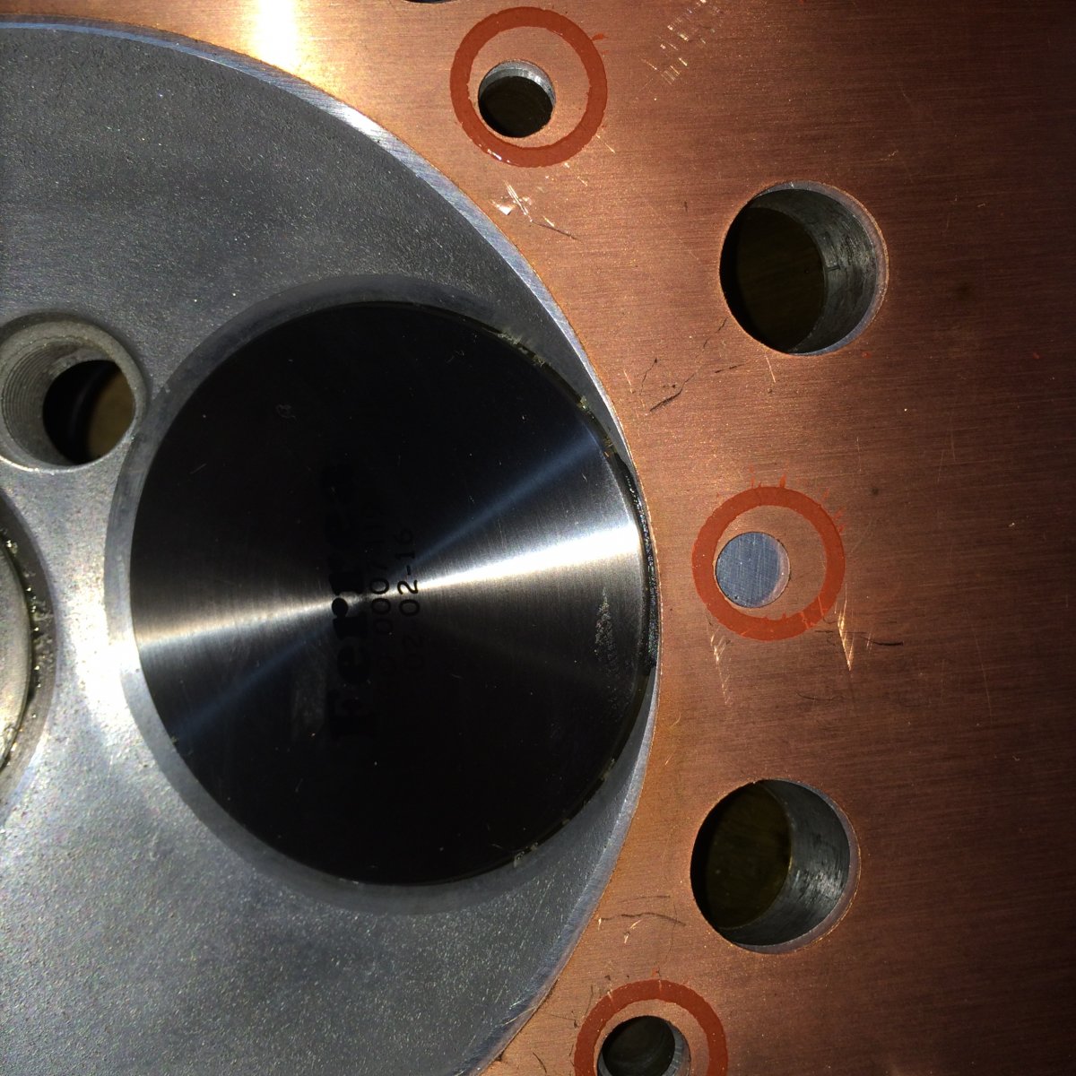

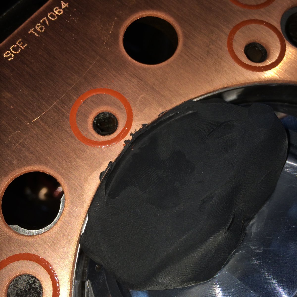

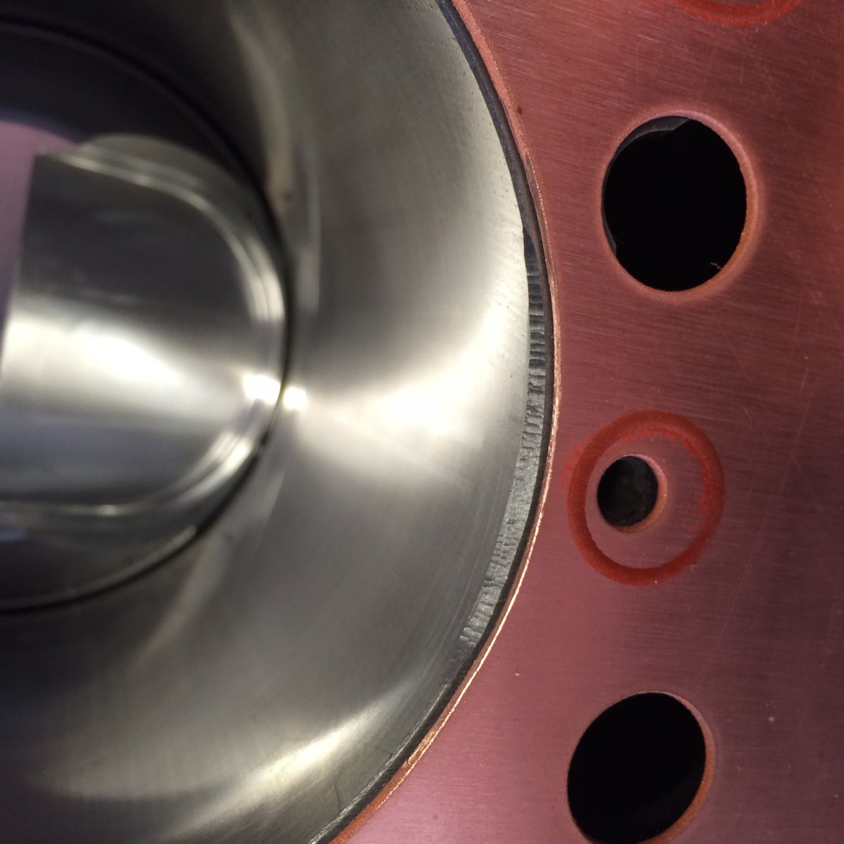

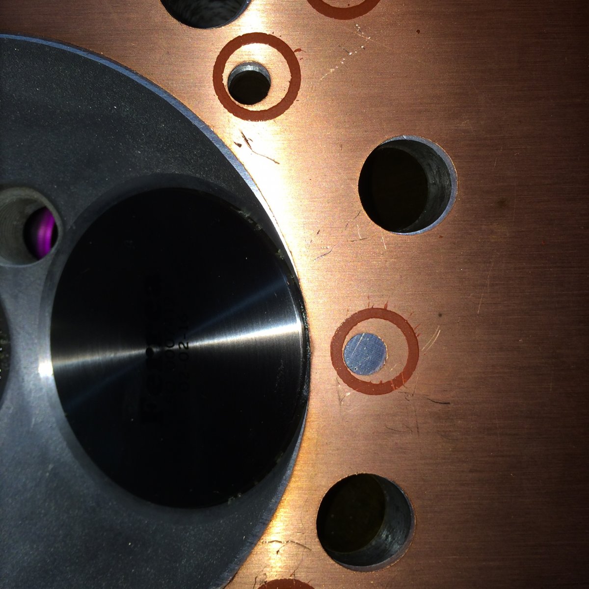

  20. All I can say is this custom engine work is time consuming .... start out the day with plans to slap on the heads and paint. Better check the valve clearance to the gasket and bore. Too close for me. Its closer than it looks in the pics.
    The clay doesn't lie.
    So shave the copper back and notch the cylinders a bit .....
    Now I can sleep at night. :rolleyes:
    Time for the good help to arrive and do the heavy lifting. :D
  21. Now you know why good custom engine builders charge a fair bit for custom engine assembly, especially if its one they don't often, or have never done. As Axle Rose would say "WELCOME TO THE JUNGLE"!

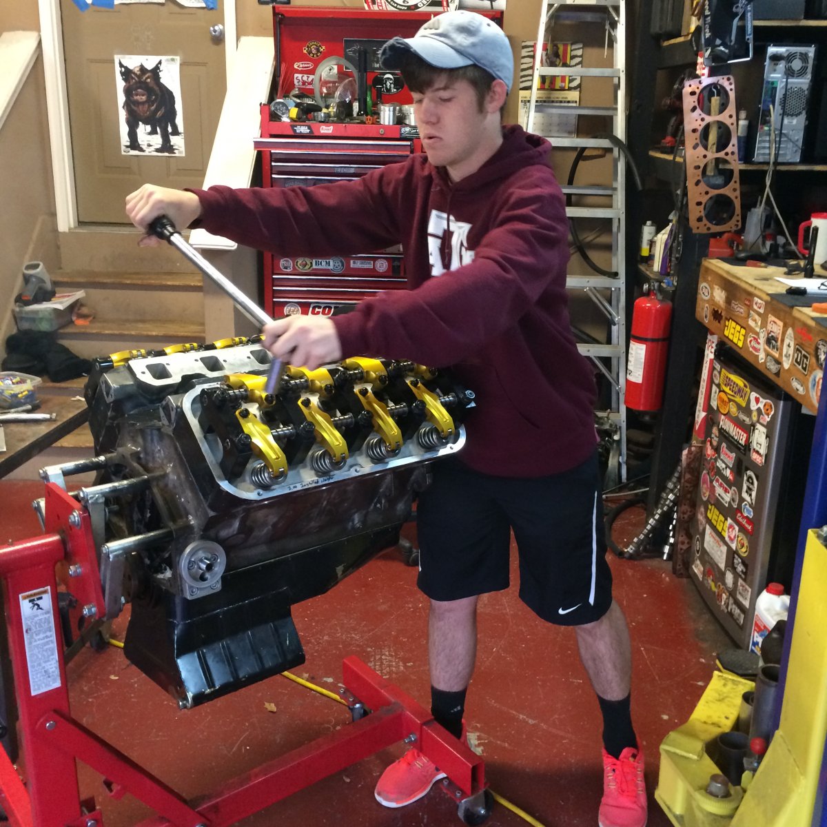

  24. Damn that guy - he has his driver's license now so he drove to my house ;) it was an automatic :(. I've been after him for a year to wear jeans and boots but when the torque wrench comes out for 110lbs, not gonna complain. Pink shoes o_O. 100% positive a girl hasn't busted his balls on his shoes yet - he'll come around as soon as that day arrives. Yeah those Georgia hogs need thinned out.
    Yeah my masking methods consumed the day. The plan was to do the notch back in the early part of the build but you need to put things in motion early in this game, so I figured on masking and grinding late in the game. It was a fair trade.

    Check this Bryant crank - its hollow - needs a plug in the end to hold the oil inside. Its 14 lbs lighter than stock.
    Like new!
    Recruited Shawn The Hippie to lend a had - he says "that's a damn big engine"
    30 minutes and its in. :)
