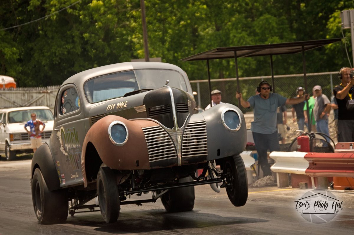

    It went fantastic :) big turnout decent weather. Made 6 p***es and hit every gear every p***! 5.90 @ 117 was best run. Time to start looking for a 10th somewhere. Went into 3 rounds of finals and lost to The Boogie Man . Best race for Quick n Dirty so far. Popped a freeze plug on the 2nd finals run. We JB welded it back in. Good to go. Border Bandits guys helped me a ton :cool: those are some good peeps. Zack Halls car was awesome to see going down the track . Sunshine Express went through the lights sideways on 1 wheel. That's what I remember :rolleyes:

    At about 31 minutes you can see a p*** with Boogie Man. Not sure whats up with the burnout. It has blow through the clutch doing a burnout. I plan to look at the clutch today it may be toasted. That's why I'm afraid to take any base pressure out of it.
    The 60 foots are consistent and the time slips were almost identical - which the car has never done with the Hightower in it. So now we can start looking for a 10th .....

    Yeah Dave I stole about a tenth from him on the tree but he got me by about a car length at the end. Ol Boogie Man can boogie! Thinking back on it my gas pedal has never been held to the floor yet:confused: a better driver could have taken him .... :p I'll find my nuts here soon :rolleyes:
