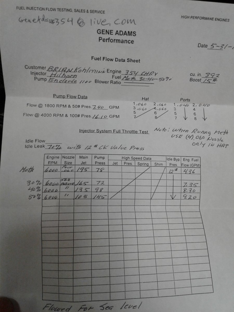

  13. Make sure you weigh the counter weight that you have now (need a gram scale) then, if you take some out, or put some in, you know where you started. As for base pressure adjustments.., righty tightly, lefty loosely. ;)

    Racer X, I know Gene Adams very well. He has been a great mentor to me. Your absolutely right people should get their system flowed as it makes a huge difference to know that info. Saves alot of headaches! Here is a pic of Gene at his custom flow bench incase anybody ever wondered what one looks like. He told me only 3 of these models exist besides his. Hilborn has one and forget who has the 3rd. Notice his T-Shirt! ;)

    I owned a Dave Settles flow bench one of the best ever made at the time (20 years ago). I bought it and payed a ton of money for it used because I thought I was leaving a lot on the table with my pro mod blown and injected hemi. I messed around with it for quite a while with no help at all to my performance. Ended up being a storage table that I did use a time or two to flow my jets to make sure they were what the number's said they were and i did find some problems there. I finally sold it a few years ago for $2,000 just to get it out of my way. I'm not trying to ruffle any feathers but Tony's engine is performing very well. He has other problems but it's nothing flowing the injectors is going to fix. i don't want to see him get more lost because he send's his stuff off and has someone tune it on a bench. I have yet to find anyone that can bench tune a gas injection unit to an odd set up like Tony's and I have seen hilborn try. A gas set up has to be tuned to the engine. Alcohol is a different story it can be set up and will work right out of the box but we have to run gas.
    The sheet racer X posted tell us that the pump is working good.
    402BOSSMAN, Dog_Patch and saltflats like this.
  16. Flowing a pump gives you two things. Is the pump flowing to the maufacturers specs and it gives you a baseline so you know what you are starting with. its basic math to figure out a safe starting point. Its not for fine tuning. Flowing just the pump only gives you part of the info. The whole system needs to be flowed. Without flowing the system how do you know what you have other than looking at the parts and saying they look shiny and new so they must be good. Im not looking at this as feather ruffeling. I look at this as some experienced racers discussing the finer points of tuning cars. Its obvious by the posts so far there are some smart guys here. No b.s. possers. I like to hear others views because i pick up on things i can try on my own stuff.

    I was just afraid that my way of doing things would offend some of the more technical guys. I posted what i did to keep Tony from getting lost where he really don't need to be working right now. And your right, now that I know we can openly talk about it I won't worry about anybody thinking I'm just being a smart ***. Keep in mind that the engines I'm referring to when I talk about this were Blown and injected on alcohol making around 3,600 HP so this stuff had to be perfect.
    95% of the pumps that I flowed when i had my bench were almost perfect and the ones that weren't I took the cover off and it was obvious as to why. Most all of them were Waterman 18 to 22 gal. pumps.
    When i set up a fuel system most of the time I had a good idea of where to start and what nozzles i needed to use. I flowed the barrel valve at 82% then fine tuned by ear and watching the pipes. (can't do that on the flow bench). Oh yea 82% is about 1 gal. per minute at idle these things used a lot of fuel.
    Then I start wide open throttle out rich and make 330" p***es, come back and read the plugs. At this point I start tuning individual cylinders and leaning the whole system to start getting the heat I need in the plugs. In the end with high speeds and all where they need to be it's making 3,600 and never once used a flow bench. All of this was in the old days we now have data recorders that have EGT's and tell us where fuel flow is, but I still get there the same way and have never trusted EGT's.
    Of course I just hit the high spots on finding a tune up but y'all get the idea.
    For the old school fuel injection just give Mike at Alkydigger a call and he can tell you the nozzles and pump you need if you don't know. I have to call him myself from time to time.
    Anyway I guess I'm missing something or just hard headed but I just don't understand where a flow bench will help Tony's car especial now that it's been tuned at the track. He has the plugs looking close so what can the flow bench tell him except, it takes this much fuel to make your plugs look this way in his engine and his engine only, in the weather that it was that day.

  20. Good points. Well taken. I think a fuel system should be flowed before the engine is started for a base line reading. If there should be a problem with performance it could be flowed again to make sure the pump is not the problem. As most know when the pump starts to go there is a definate spike in rpm at the top end as its going lean. Hopefully its caught before it takes out a piston. I just like to know what im starting at so i can refer back if there is a problem. I agree a flow bench wont tune the car. It still needs to be done the old time consuming way you described. I have run several altered wheelbase mopars over the years with stack injectors. They were all original hemi cars. I also ran the car thats my avatar. It used a late model brad fat head blown nitro hemi backed by a bruno lenco. The tune up for that needed to be perfect also. Fires ****.
    402BOSSMAN, Dog_Patch and Quain Stott like this.

    What if we agree on this. Flow the pump to make sure it's good (this will be for people that can't take it apart to look). I'm still not understanding why the rest of the system needs to be flowed.
