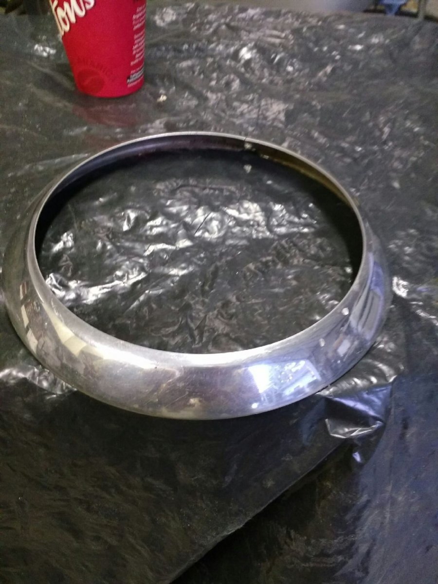

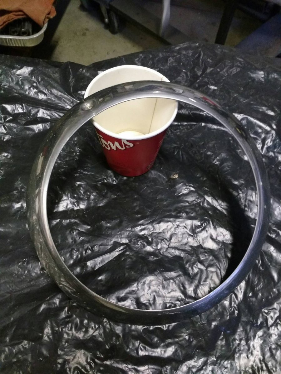

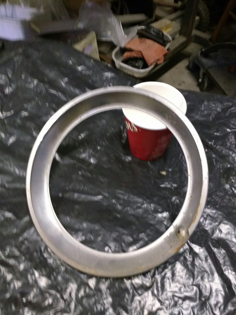

    The headlight rings on a 49-51 Ford are way bigger than what I need. Had a look at my dad's 51 today, the ring I have fits inside the ring from my dads truck. Just saying!

    If you find out what headlight rings cross over, please let me know. My HJ bezels may have been lost in the big move. I'm still sorting through boxes in hopes.

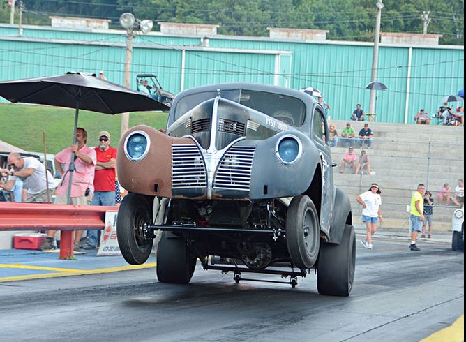

    I watch all the videos of the SEG races and I have noticed something that might be a safety issue, maybe some of you fans can check it out and see if I am wrong. Every time the Boogie Man leaves with the wheels up, the front wheels jerk to the right then straighten out as they touch the ground. its like severe bump steer. AAirwJY.jpg
    Dog_Patch likes this.
  25. hog mtn dave
    Joined: Jul 14, 2004
    Posts: 1,353
    hog mtn dave
    I think he's up on the wheel ready to pull 2nd gear and turned it a bit to the right. The front wheels are going to straighten out to wherever the car is pointed when he lands.
    loudbang and Dog_Patch like this.
  26. Bad Banana
    Joined: Jun 20, 2008
    Posts: 834
    Bad Banana
    My car does the same thing. Yes it is bump steer. If you watch most all straight axle cars will do it to some degree. The steering rod from the box to the left (or in Boogie man's case the right) spindle pulls the wheels to the right when the axle drops down in the wheelstand. The driver is holding the steering wheel straight but the axle is pulling the wheels right. As soon as it touches down they straighten then tend to go the other way on suspension compression until it gets back to ride height again. As long as you keep holding the wheel straight it eventually gets back to going straight.
    All normal for a 60's g***er. The driver typically knows nothing about it since he is busy trying to shift gears and see where the car in the other lane is. All in a normal run in one of these cars. It's not for everyone...lol.

  29. glrbird
    Joined: Dec 20, 2010
    Posts: 601
    glrbird
    Thanks Bad
    If the steering rod ran front to back instead of side to side,(like a early ford pickup) that would fix the problem. I do enjoy watching your car carry the front tires a great distance.
    Bad Banana likes this.
  30. Bad Banana
    Posts: 834
    Bad Banana
    Actually mine runs front to back on the outside of the left frame rail. No real way to correct it. The steering box is mounted on the frame and the axle moves up and down. Having it a long as possible and level at ride height is the best you can do. Mine is kinda short so it is noticeable.
