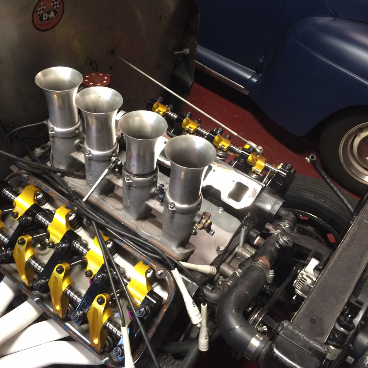

    My short stack experiment went wrong wrong wrong. The car was real choppy and really didn't want to wheelie and went 1/2 second slower for both p***es. Can't run an O2 sensor at the race so only can speculate. With two races left, the 12" stacks are going back on. No more messing until we can dyno it and see what the stacks are doing. My thinking right now is longer stacks!

    No they are a press fit and it takes a lot of effort and a vice to get the tubes in and out of the bases. I'm going to see what Alky Digger is getting for the bases and then, maybe try swapping them at a track when I can mess with the pills and have an O2 sensor.

    It would take some work to fabricate, too much for during season, but consider for a future project very short straight stacks with a flange with tapped screw holes on the outside where you could attach stacks of any length with matcing flanges with clear holes for the screws to lower stack flange.
    Each set would need flanges unless you could figger a way to separate from the upper stack and fasten them to another set of different length.

    I talked to Gene Adams and Nick Smithberg about the stack size and its just math. The 12" stacks will not allow full power over 6500 RPM. The engine does rev to 8000 with them but there is going to be more power with say 6" - so Ric mentioned using rubber tubing and big hose clamps and sliding the stacks to change the length to find the best size. I'm hoping to talk Johnny Thomas into making a Hemi adapter for his dyno this winter and work all this out on an engine stand.

    Here is a graph that is pretty close to what is needed to catch the 3rd order harmonic (most common) for runner length. There are many harmonic waves to catch, just depends on what you are trying to achieve. You need to measure intake port centerline length, runner centerline length in the manifold, intake gasket thickness, and stack length if you are running an injector. Total tract length is what is in the chart above. There are actual calculations to determine exact length needed or RPM desired. Crunching the numbers this way gives you an expectation for dyno testing and you can fine tune from there. If it doesn't end up within a few 100 RPM something else is the cause and time to see what is affecting it. We can all thank the Chrysler Engineers "Ram Chargers" for figuring this out.
    When it comes to Wave Tuning the big picture needs to be realized. The header is just as important, if not more since it can manipulate the power curve pretty dramatically with minor changes. When we did Engine Masters I learned how critical header design was and how it manipulates power. It affects alot more than you think and is probably the most overlooked item. All about the details to make them perform at another level!

    Interesting graph but how does it a count for the runner inlet diameter and radius at the mouth inlet ?

    That graph is just a quick reference to get you in the ballpark in most cases. There are actual calculations and many things to consider for a more exact number.
    For bellmouths shape there is certainly a reason why you see them shaped the way they are. Professor Blair spent time figuring what was optimal. You can read about that info here - (top search, open the PDF file)
    https://www.google.com/search?q=pro...q=profe&aqs=chrome.1.69i57j35i39j0l2.2636j0j4
    For desired area needed I use a Program called Pipemax that Larry Meaux created. It's also very useful for header design for size needed and lengths. There is more to header design than what the program gets into but it will get you 85% there. It also calculates alot more and for what it costs it's a very useful tool for engine design. There are many computer simulation programs that I have used over the years but ultimately past experience and looking at the overall picture mixed with a little gut feeling is what makes the final call for my part.

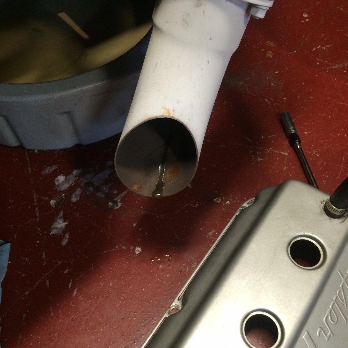

    image.jpeg Went to a real old drag strip in Alabama Saturday and almost didn't find enough gas to get back home!
    Floater03 and loudbang like this.

    image.jpeg Here's the leak - those damn SCE gaskets with the silicone bead

    What did the pistons look like with the carbon on them if any?
  28. AmishMike
    Joined: Mar 27, 2014
    Posts: 1,449
    AmishMike
    what did the head look like over that piston?

    cs39ford
    OUCH. And now we know we're it went!!
