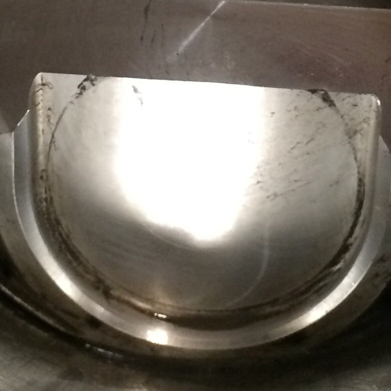

    They way that leak down gauge is set up, 0-10% is good and it goes down from there, 70 is on the far side of the gauge. Its leaking on the intakes. I think there was a little piston to valve contact in the water box at 8,000 RPM. The exhaust side has a small strike imprint on the piston, but the intakes didn't. The leak seems to be the intake valves. The UPS guy just picked up the heads, so Nick will get a chance to look for bent valves soon.
    Here you can see the intake is leaking like a sieve. It doesn't seem to matter at 8 grand though .....

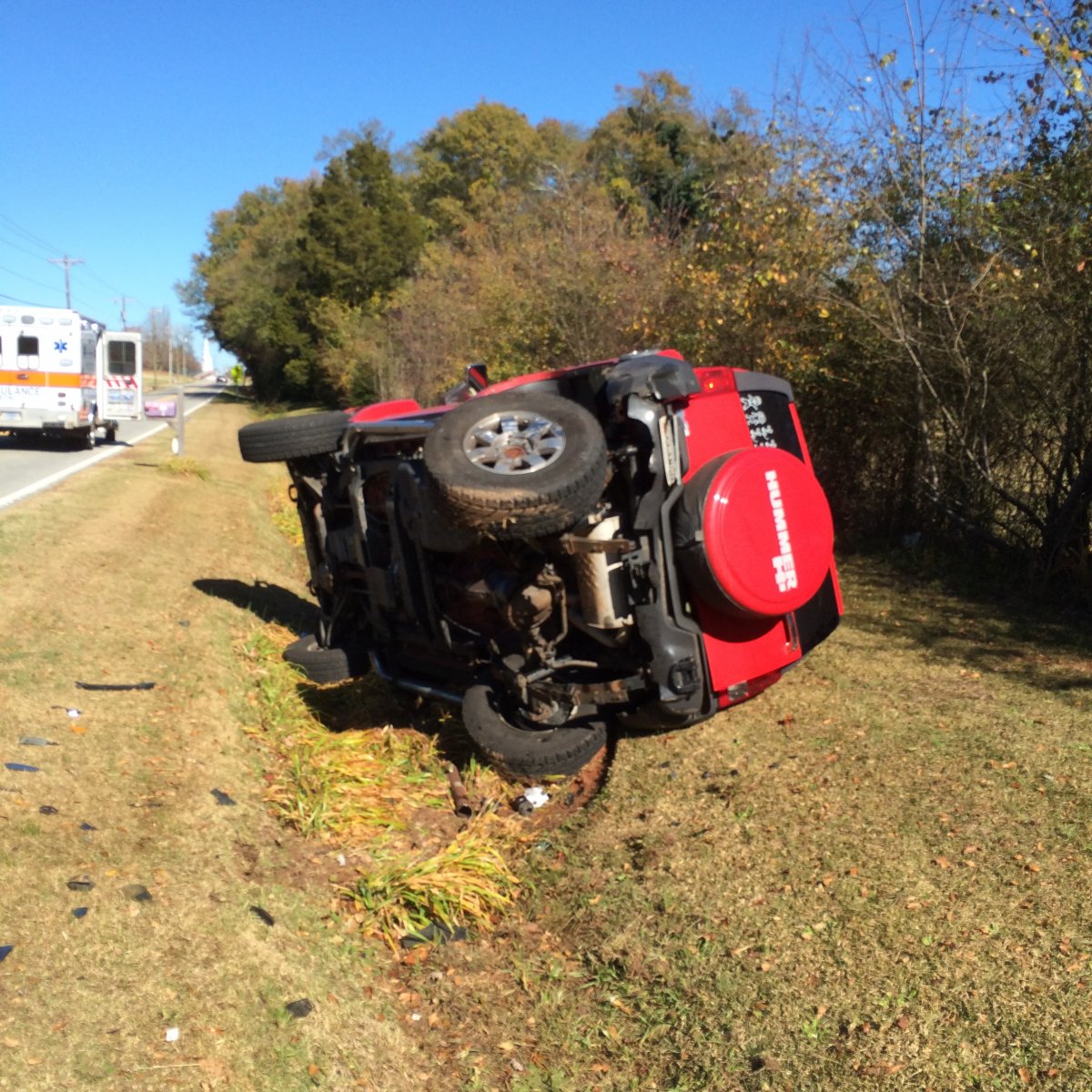

    Never posted anything about this, but 1 year ago me, the wife, and all 5 dogs were driving to my mom's for Thanksgiving and planned a stop to visit Quain - about 3 miles from his shop we almost got one of those roadside crosses planted :eek: anyway we were about 8 inches from getting center punched head on. Gabriel loaned us a car to get home, Donovan helped catch all the dogs :). You never know when its all gonna end so don't waste any of it!
    Do what you need to on the Ranchero and don't wait!
    (and the other driver was unhurt - both cars were s****s). Life happens - try and get out of the way if needed though o_O Forgive, fix your **** and get back on the train. Happy Thanksgiving!

    Wow crazy wreck Tony glad everything turned out ok looks like it could have been real bad. Did you guys get rear ended or did the hummer just roll that much?

    It was going to be a dead center head-on both cars going about 50MPH - I decided to exit stage right at the last millisecond so we were pretty much shooting hard right for the ditch and the other car punched right behind my door and spun us straight again . That ditch is deep otherwise I would have exited sooner.
    I learned that side curtain air bags have to be cut with a knife to get out. o_O Now I have a knife on the sun-visor of all my cars.
