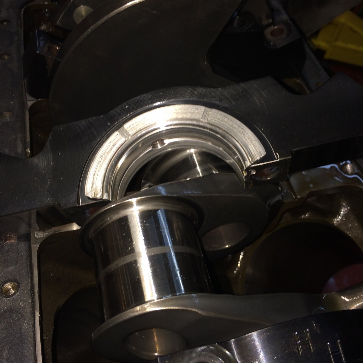

    Got the bottom end apart and need to take it to Johnny to get it magged and honed. The only real wear is the thrust bearing face and its not too bad.

  10. thats normal on a stick car. the thrust takes all of the abuse every time the clutch is pushed in.

    Make sure you have room for rear main seal walk.

    I plan to put in a new thrust bearing, but when is it a 'fail' ? How much wear is too much?
    Also saw on a post somewhere that a guy cuts extra oil notches in the thrust bearing face - but seems like that reduces the surface area too .....

    Seems to me one of the best things you can do for the thrust bearing is always fire up in neutral, clutch pedal NOT depressed so as to let oil get on the thrust face before you depress clutch.

  17. just check the end play with a indicator. pry the crank forward and back. I don't have the spec in my hand but there is a spec. it was not uncommon for me to change the thrust mid season. its just one of the things you have to accept when you run a stick.

    Tony We had to put extra oil to the rear main on the 426 style hemi that we ran in Pro Mod but the thrust was in the center main on that style block. Not sure on the 392 block like you run. We had to have the extra oil because of the weight of the heavy 3 disk clutch hanging of the back of the crank.
    With all of the clutch pressure we ran there was never a problem with the thrust. Make sure your not coil binding your pressure plate springs or something crazy like that because you should not be having that problem. It could ruin your crank if ran that way very long.

    I check the air gap often so I don't think it coil binding. How did you increase the oil flow? One thing that is different this year is the oil weight - using 10/40 this year - ran 20/50 last year.
