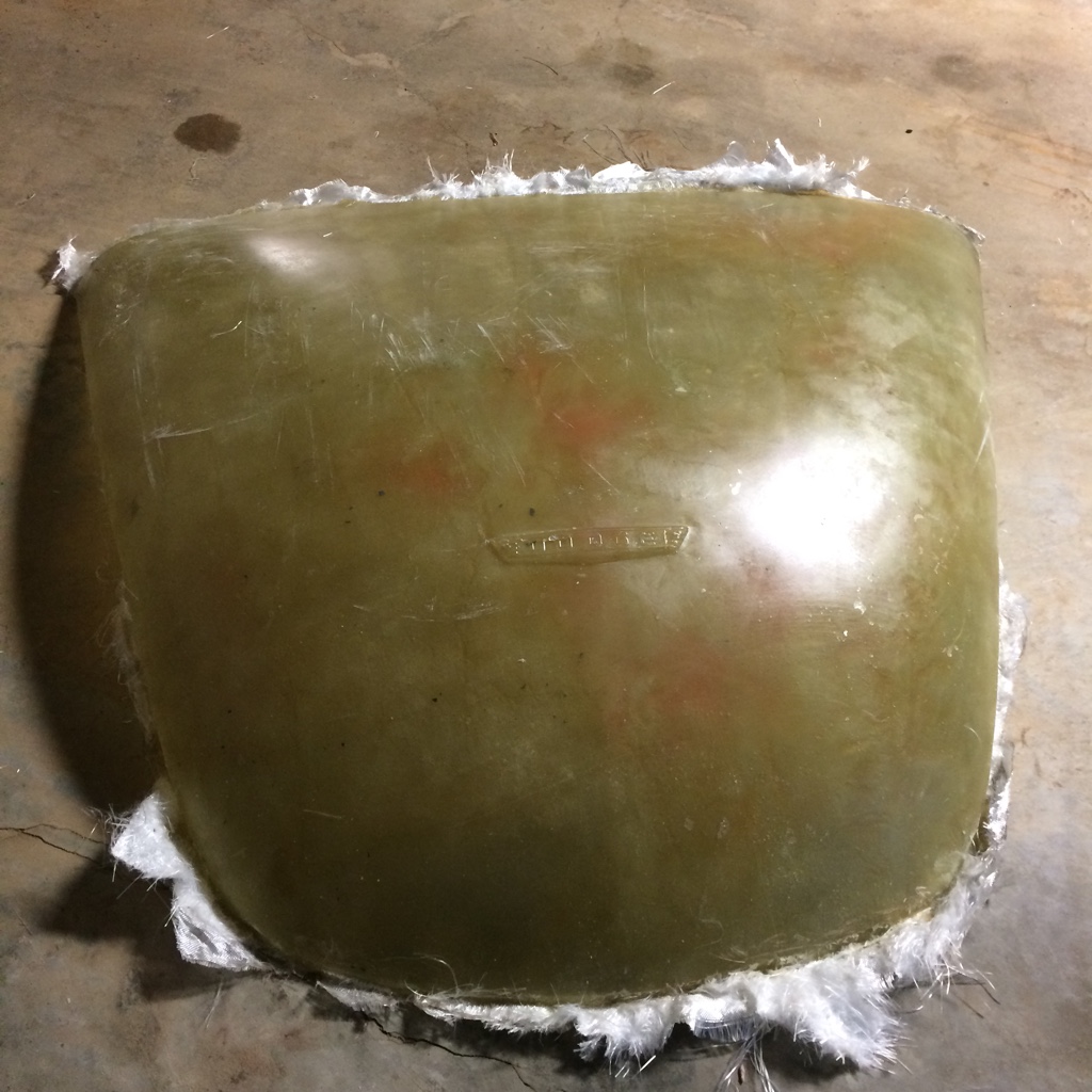

  7. How in the heck did you find that much floor space in Russ' garage?
    I'm curious as hell to see how this is going to turn out. All those other guys with '39 Dodge gassers are going to be lining up to buy 'glass deck lids.

    Nice mold, should hold it's shape well with your bracing.
    To echo Salt Flats, Do you plan on a front clip also?

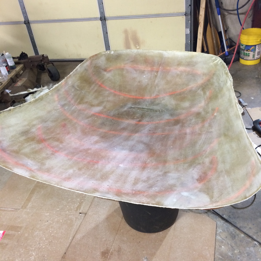

  13. No plans for glass on the front right now. Blacksmith Tom is making an aluminum hood top. The 40 pound doors are next [emoji51]

  15. [​IMG]
    Learning some things- needs to be stronger around the outside edges

    I have to ask what the orange piping is?

  18. Now that's a funny story - Russ has an air compressor that hasn't been started in 30 years out beside the garage - he told us it will be fine, just buy some oil and an air hose. Yeah that thing only made 5 PSI and the new hose I bought looked like good bracing material so ........
    The next time the hose will make a complete perimeter loop to strengthen the mold edges.
    Yeah it was all fun and games until the gel coat and resin ran Russ' girlfriend out of the house :oops::rolleyes: that's why we were in a different garage the next day :D
