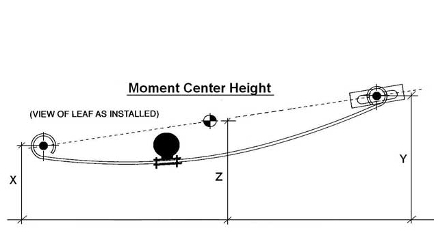

    Parallel Leaf Springs do not alter the wheelbase unless the idiot installing them sets them up like trailer suspension.
    The springs are mounted at an angle so the arc movement cancels out the spring lengthening when compressed.
    Crawl under any leaf spring vehicle and you'll notice the rear eye is a lot higher than the front eye.

    Have you ever seen the rear higher on a front mount straight axle vehicle ???
    So yes, it CAN effect wheelbase, on my Henry J it was 3/4 inch difference when compressed.

    They do the opposite on front parallel leaf springs with the shackles at the front.
    BUT it is not so critical on the front end because any wheelbase variation causes the steering geometry to "Parallelogram itself" so the wheels always point straight ahead [as long as bump steer is sorted out]
    Whereas on the rear end the wheels are always perpendicular to the axle causing rear steer [or roll steer]

    When the suspension compresses with a ladder bar the pinion angle "rotates down on the nose"
    This increases some leaf spring tension in front of the spring pad, But relaxes some leaf spring tension in behind the spring pad.
    Soo in theory they cancel each other out ["in theory":)]
    In reality the spring stiffness [actually spring load] increases due to the offset of the centrebolt.
    Front pivot placement of the ladder bar does have some effect due to arc movements.
    A 48" long ladder bar will arc 0.090" with 3 inches of travel in one direction
    The same 48" long ladder bar will only arc 0.020" with 1-1/2 inches of travel in one direction
    So if the rear suspension has 3" travel [1-1/2 inches of travel in compression and 1-1/2 inches of travel in droop] place the front pivot in a central position
    If the suspension is set up to extend when the tyres are "hit" you are better off raising the front pivot. If it squats then lower the front pivot.
