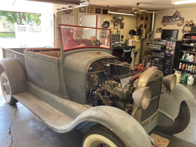

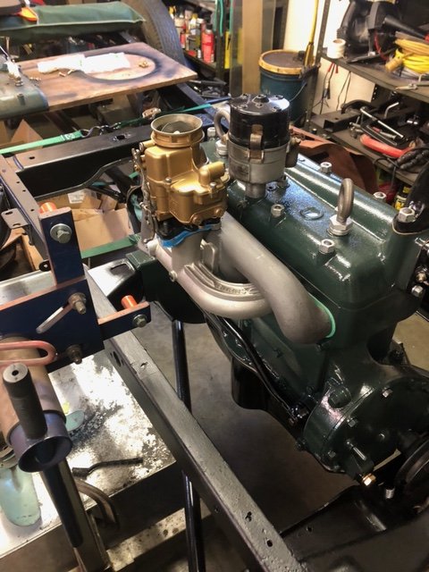

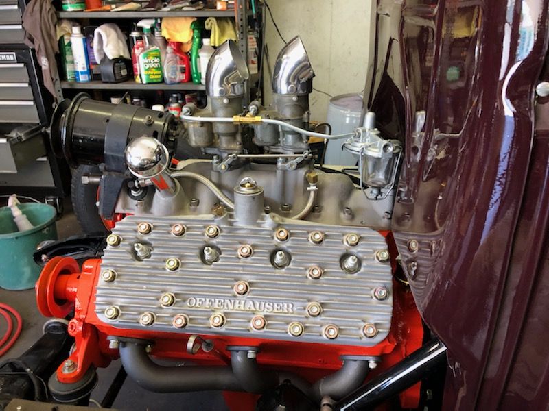

    My avatar had a flathead V8 60 in it with a fuel pump, never tried to run a V8 without a fuel pump. However my 30 pickup had a B motor with an Ansen manifold and a Holley 94 and it worked fine most of the time without a fuel pump. I did discover (the hard way) that you better keep plenty of gas in it, was in the Flint hills in Kansas and on a long grade with about 1/2 tank, it died going up the hill, let it sit for a few minutes and started again and made it up the hill. Gravity feed didn't keep up on the hill so I installed an electric fuel pump and pressure regulator and ran it like that for years with no problems. I wouldn't try a flathead V8 without a fuel pump, on a stock Model A the carb is several inches below the bottom of the gas tank (up draft carb) and with the Holley 94 the fuel inlet is about level with the bottom of the gas tank. In the pictures you can see the stock up draft carb is about 6" below the head and in the second picture the inlet on the carb is even with the distributor. On my V8 A the inlet on the carbs is about even with where the bottom of the gas tank is mounted.
