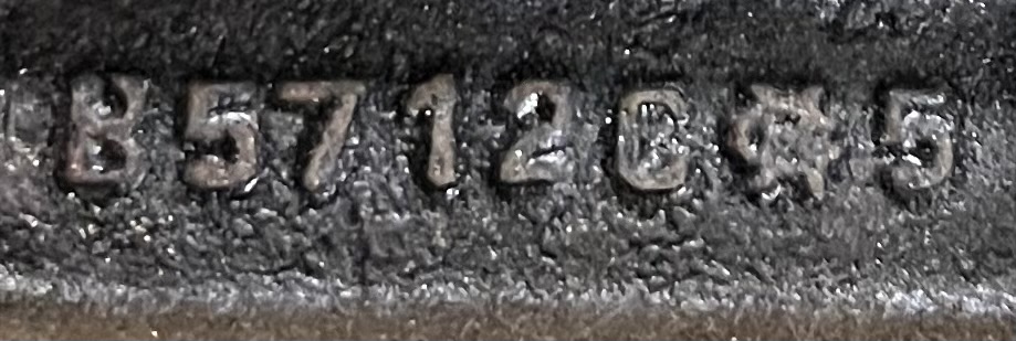

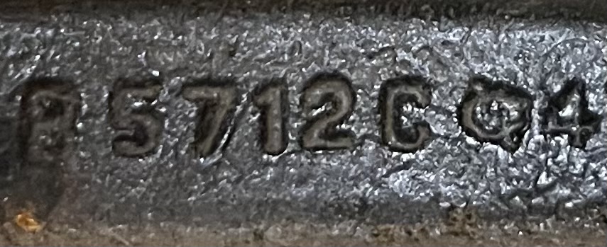

    I know there is a chart that shows the application of these spring clamps but I can’t seem to find it online, does anyone have a chart or know the application to these?

    Early Ford leaf spring u bolt ?

  3. Mark T
    Joined: Feb 19, 2007
    Posts: 2,183
    Mark T
    Yes, I’m trying to nail down the year.
  4. bct
    Joined: Apr 4, 2005
    Posts: 3,195
    bct
    How wide is the spring seat ?
  5. Mark T
    Posts: 2,183
    Mark T
    2 1/4”

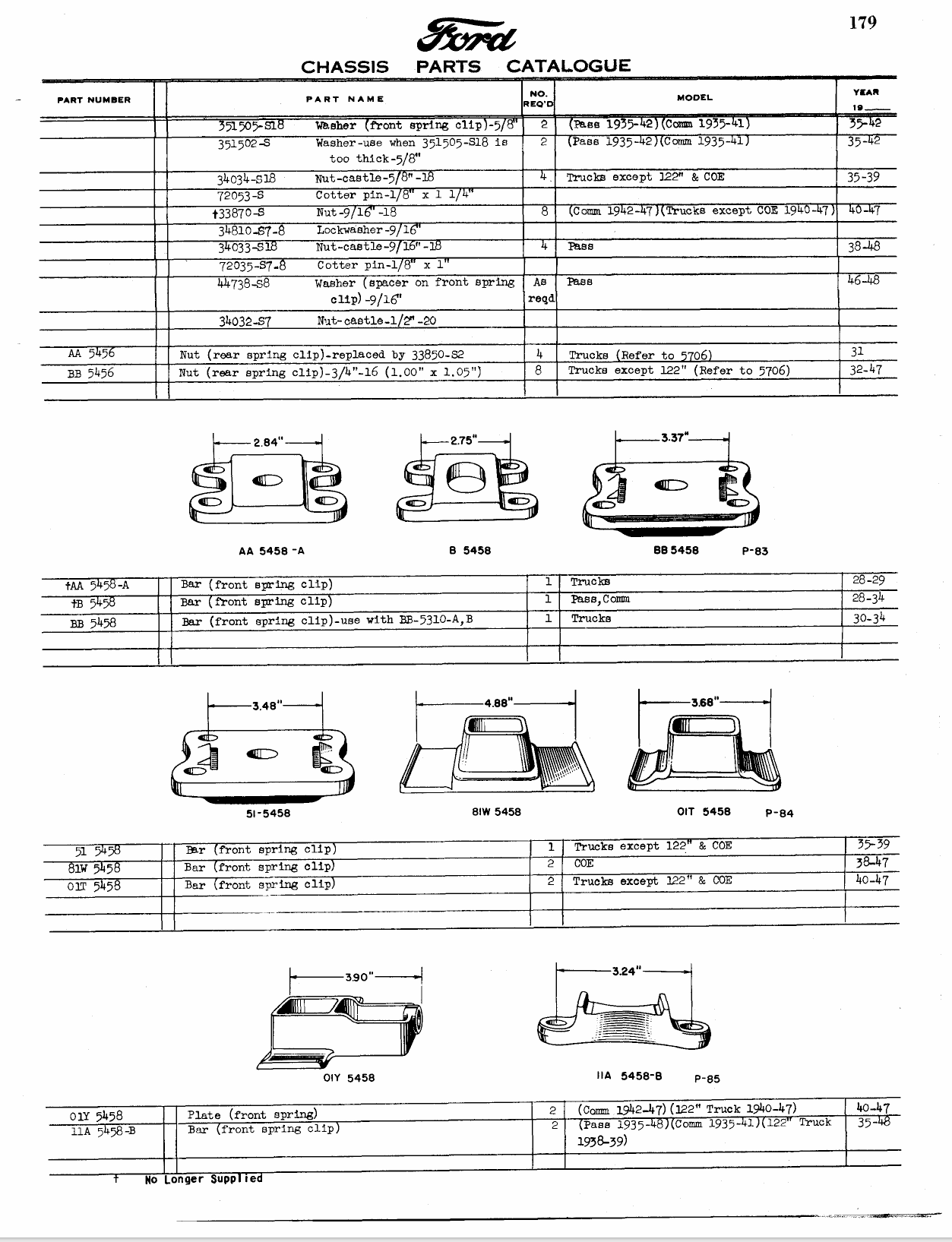

  6. Andy
    Joined: Nov 17, 2002
    Posts: 5,390
    Andy
    A Green Bible may have a chart.
    It is for a rear spring.

  9. Mark T
    Posts: 2,183
    Mark T
    I think that’s part of the list that I remember, that page only shows 1 of them on the bottom right, 5458-B
  10. Andy
    Posts: 5,390
    Andy
    The B prefix would indicate 1932. I don’t know where the rest of the number fits in. Maybe aftermarket?
  11. alchemy
    Joined: Sep 27, 2002
    Posts: 22,774
    alchemy
    But if the part wasn’t redesigned, it could still carry the B prefix into later years. Ford used the same size crossmember after 1932 also, so the clamps could actually be proper on 33-34’s as well.

  13. Mark T
    Posts: 2,183
    Mark T
    I was able to open the picture with some difficulty, it just showed the varying heights of the different bottom plates. Thank you.
  14. squirrel
    Joined: Sep 23, 2004
    Posts: 60,033
    squirrel
    The thread mentions that it fits a 33 tudor
