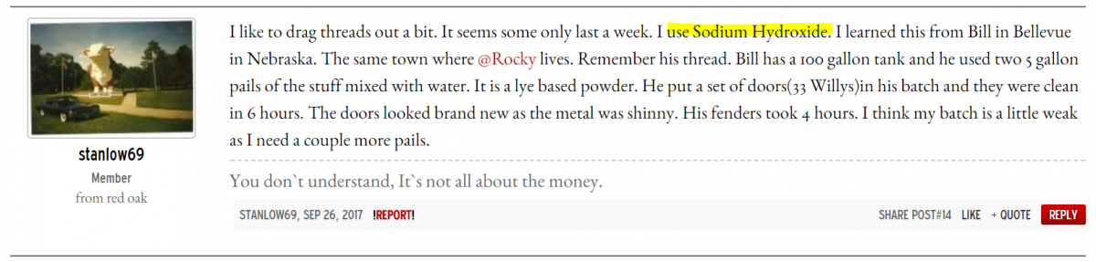

    bobss396
    NaOH. A very strong base. That will remove rust too.
