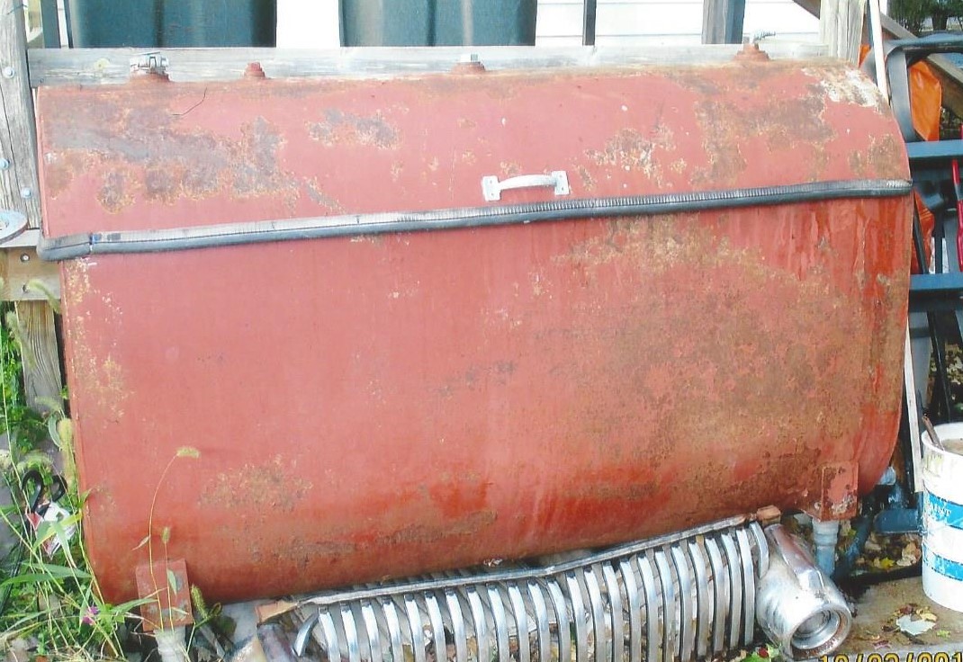

    I have a 250 gallon tank similar to this one. with the lid cut open. I use 30 pounds of citric acid and water. I always have something soaking in it. I leave very rusty Scan0489.jpg things in it for a week on average. Works good. Sometimes longer if I forget. And as long as a month. Dosen`t hurt the metal. I guess I need to update my other thread. Dip Tank.
  13. vtx1800
    Joined: Oct 4, 2009

  14. stanlow69
    Joined: Feb 21, 2010
    Posts: 7,346
    stanlow69
    The temp today is now -13. It was a little warmer today. I was gonna put some parts in it but, yes. It`s frozen. Last week I had parts it and it wasn`t frozen. It was below the freezing point. Took some parts out last Thursday that were in for 4 days. They were pretty rusty. Came out pretty clean. I was in a hurry to get the job done. I don`t remember the actual temp outside.
