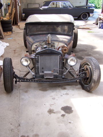

    This car has been advertised here in Germany. A friend of mine asked me to come with him to have a look at it cause he's interested in bying it.
    To me it looks like a pile of junk even their description doesn't make sense:
    here's the text:
    31 model a coupe - top chop 6.5 inch - channeld 3.5 inch - on 30 rails with a 10.5 kick in the end of the frame - engine 350 chevy - 3-speed manuel chevy shifter - 32 spindels on a drop i-beam and 40 drums - king pee head lights - gm 12 bolt pose rear end - 58 corvette rear ends with red bubles - wheels are model b wide five `s - and the steering colum comes from a 48 ford
    they're askin 14000 Euros around 17000 $ -
    we'll see what it's like....

    doesnt look right to me. I can't make out the windshield area, but it doesn't look Model A to me.

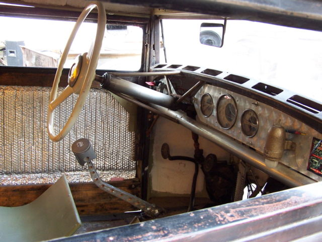

  6. I'm not crazy about the location of that steering wheel. Sort of like "ape hanger handlebars" on a chopper.

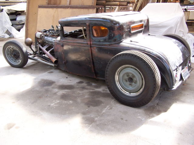

    It's screwed up, that cowl is a 1929 Briggs Fordoor mated to a 30-31 coupe. WAY over priced, go look at it kick the tires and walk away from it.

    I'd be very interested to see how the steering column attaches to the box. something weird going on there.

    I'll take some pictures tomorrow for the steeringbox and watersports interested.

    Mid-thirties Chevy/Gm gauges...
