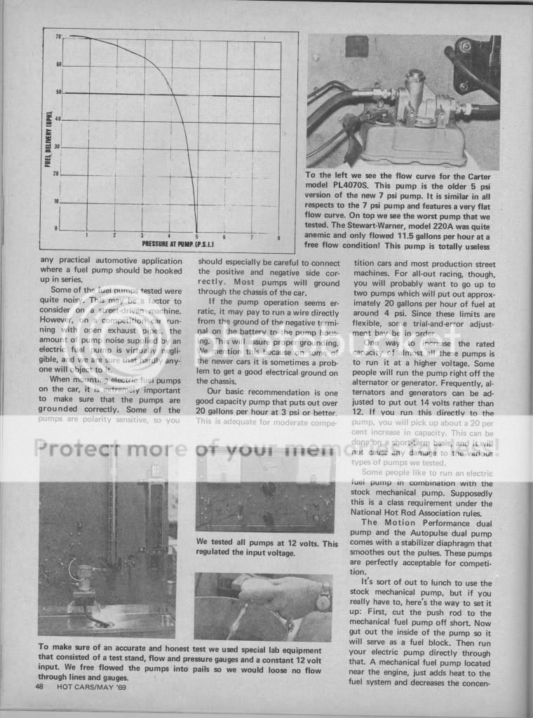

    bobo, I've had some similar concerns with using this old technology. Fact is, guys were going fast with them back when, but figuring out the winning combo can be tough. Here's a tech article form 1969.

    Thanks for the imformative article on the electric fuel pump.

    Maybe the article was not completly scanned? The carter was not listed in the comparo chart.....funny how the flow chart and text has nothing but good things to say.

    If you read the text under the chart, they say that the chart data was supplied by another source, but it was accurate with all of the pumps they tested.
    SO yeah, some of the pumps the article tested were not done by the people who made the chart. The Duplex Motion pumps were not on the chart either. I guess incomplete articles are nothing new. I read stuff today that also have holes in it and are not very scientific. It's nice to have some useful data though.
