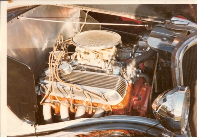

    In the early '70s I had a 396/375 in my '33 Tudor; fit just right and went pretty good too.
    1Nimrod, loudbang and kidcampbell71 like this.

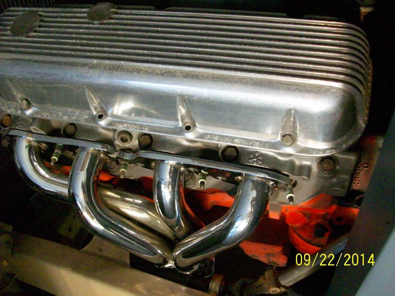

    Here's one of mine in a '35 Chev. I have 12 big blocks, laying around, I'll never use all of them. 100_1501.JPG
    1Nimrod likes this.
